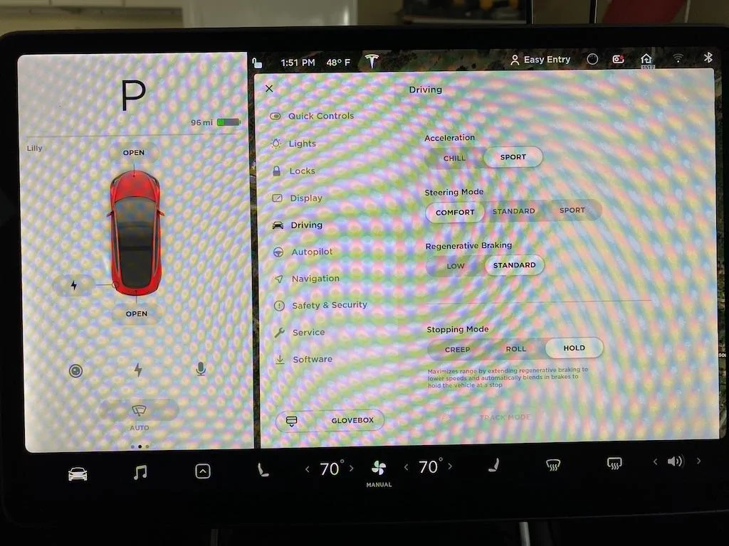

Not true in the Model 3 as of the latest update, regen works all the way to a stop now. Its crazy, we barely ever have to touch the brake pedal now.
The new X now goes all the way down to 0 mph and I have watched the power meter carefully at the stop to see if it is really regen down to 0 and, unless there is some inertia in the pointer it is. IOW it does not appear that it takes you down to 2 or 3 mph and then transition to friction brakes, The X has "hill hold" mode (don't know whether the 3 or Y have it) and in pops in at 0. I've only had my X a couple of days but I've only used the brake once (when a guy right in front of me slammed on his). Further evidence that it regenerates all the way down to 0 is that the manual says to enable this mode for maximum range.
