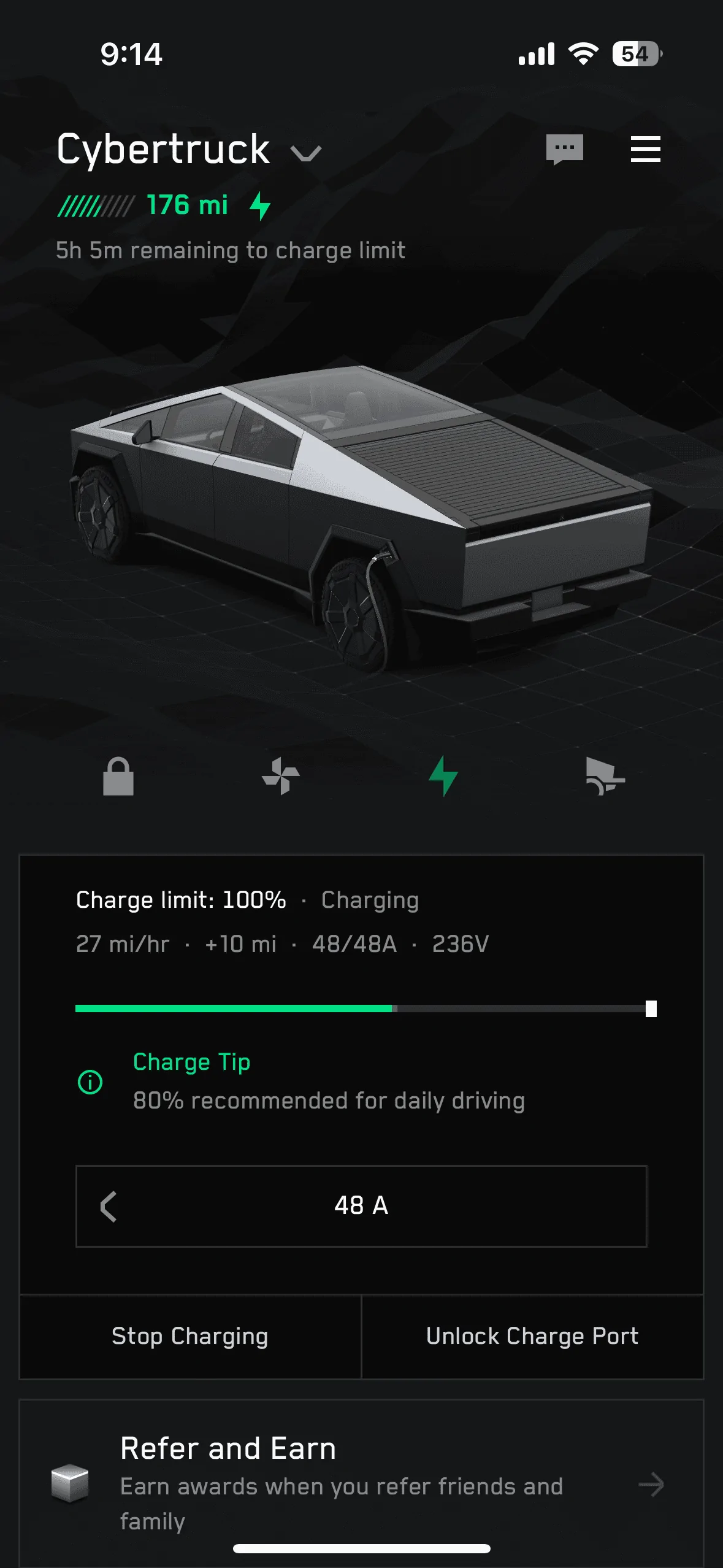

11.5 kw 48A not adding 46 mile per hour

For hard wired you can do the full 48. But for a plug, you are not supposed to charge above 80% of the current rating. So 40A would be maximum safe current on a nema 14-50.
Even hardwired a Tesla Wall Connector won’t go over 48 with a 60-amp breaker.

Why would a dual motor model 3 get over 30 mi/hr charge rate at home and the cybertruck a lower rate? All else equal.
Because miles per hour isn't a real thing. You are charging at some number of kW. It takes more power to push a cybertruck a mile than a model 3. So if you're charging at 11.5kW (the max AC charging rate for all current teslas), that will get you 44 miles per hour in a model 3 while it only gets you 27 miles per hour in a cybertruck.
It's the same amount of power, just a bigger battery pack and less efficient vehicle.
