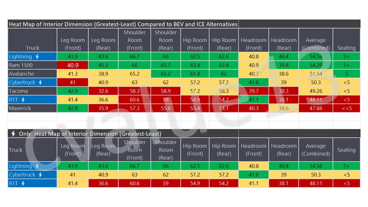

EDIT TO ADD:
Have bolted up a compare (in heat map) of interior dimensions:
As suspected (by some) for a while, interior dimensions come in nearest to a Chevy Avalanche, but with width at hips (determining seat width) being comparable to a Toyota Tacoma - which explains the lack of 6th seat, but also portends a rather narrow rear seat that is "5 passengers" in name along the lines of a Tacoma (though CT's better shoulder width will help a touch).

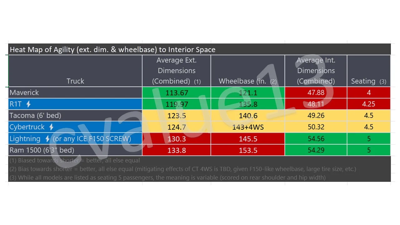

Next is a heat map that essentially demonstrates the design thesis of the Cybertruck:
  • *nearly* full-sized BEV truck cargo area,
  • *nearly* mid-sized footprint/agility (but an ~F150 wheelbase, mitigated by 4WS)
  • somewhat *better* than mid-sized interior volume, at least in terms of rear seat legroom, but basically mid-sized seat width
