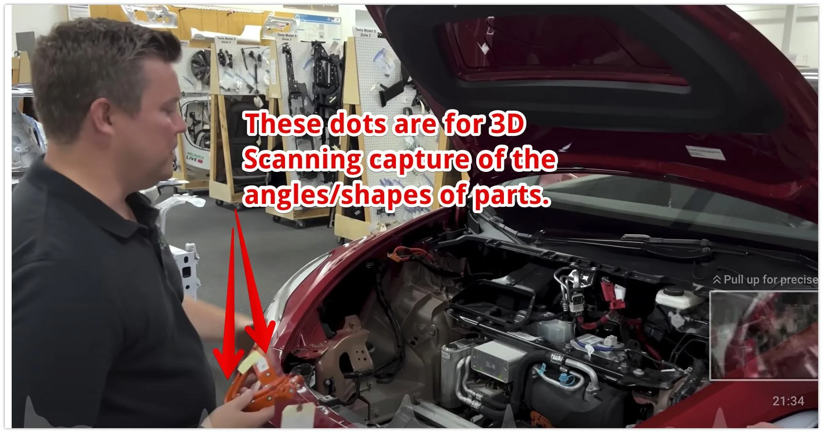

All depends on what your planning to do....
Munro and associates 3D scans the parts to sell files/information to OEM's
