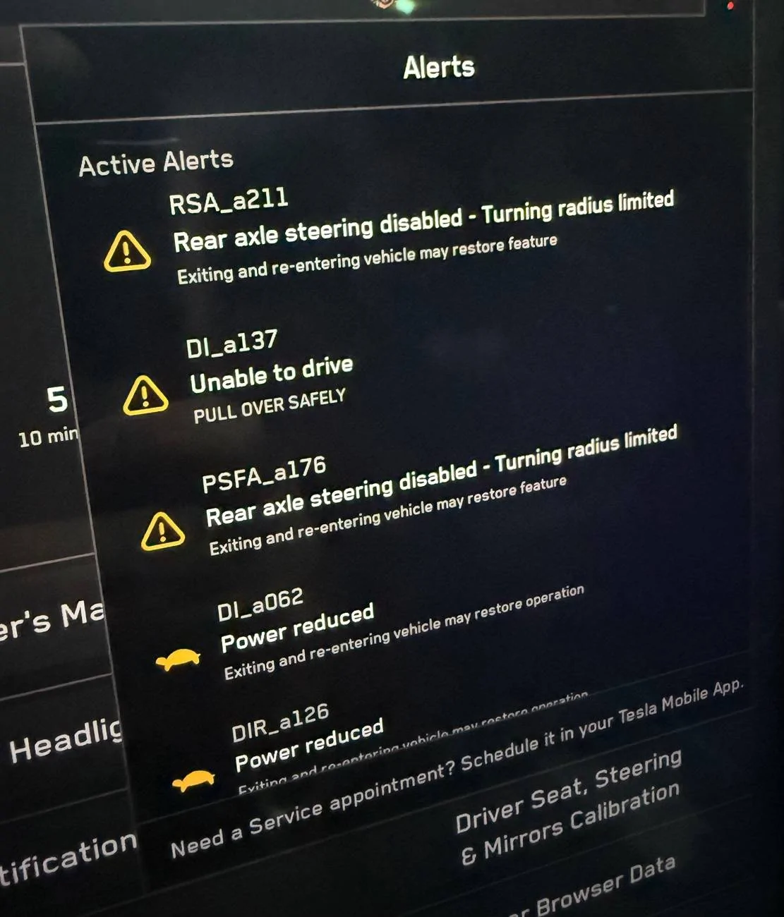

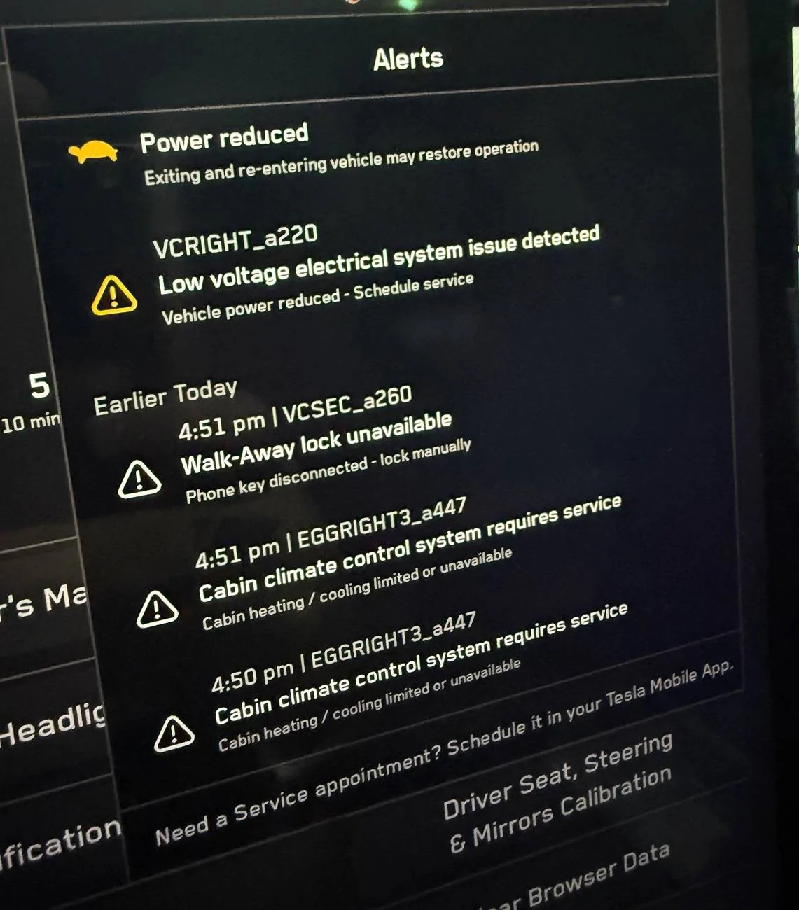

Got my FS last March, broke down as soon as I left the service center. Low voltage errors, critical steering, etc. had it towed, power conversion system replaced.
All good until 3 weeks ago, 5800 miles later, while on vacation, same issue again, low voltage issue detected, critical steering, unable to drive, etc etc. totally ruined my vacation, had car towed to service center 3.5 hours from my house. Had to rent a truck because I had my dirtbike with me. Such a nightmare.
Service center had the truck for 2 weeks. Did all the recall work, (sail appliqué, wiper motor, etc) replaced front and rear drive inverters. Said that is what the issue was. (Wiper is also now 2” to the right where it used to be hidden on left when parked btw, but different story)
I uber all the way there from home to pick the truck up. Got it, head home, I make it 2 hours, I stop to pick something up, return to car. Issue is back, same errors again, towed again!
I’m getting sick of this, I’m looking into lemon law as I’m really losing confidence in being able to take this truck off road anywhere remote, it’s really ruined my trust.
Anyone has similar problems? It seems weird that I’d need another pcs replacement. But no idea.
It’s the 3rd breakdown, and waiting for word from service center.
Exiting and re entering multiple times didn’t fix it. Nor did restart.
