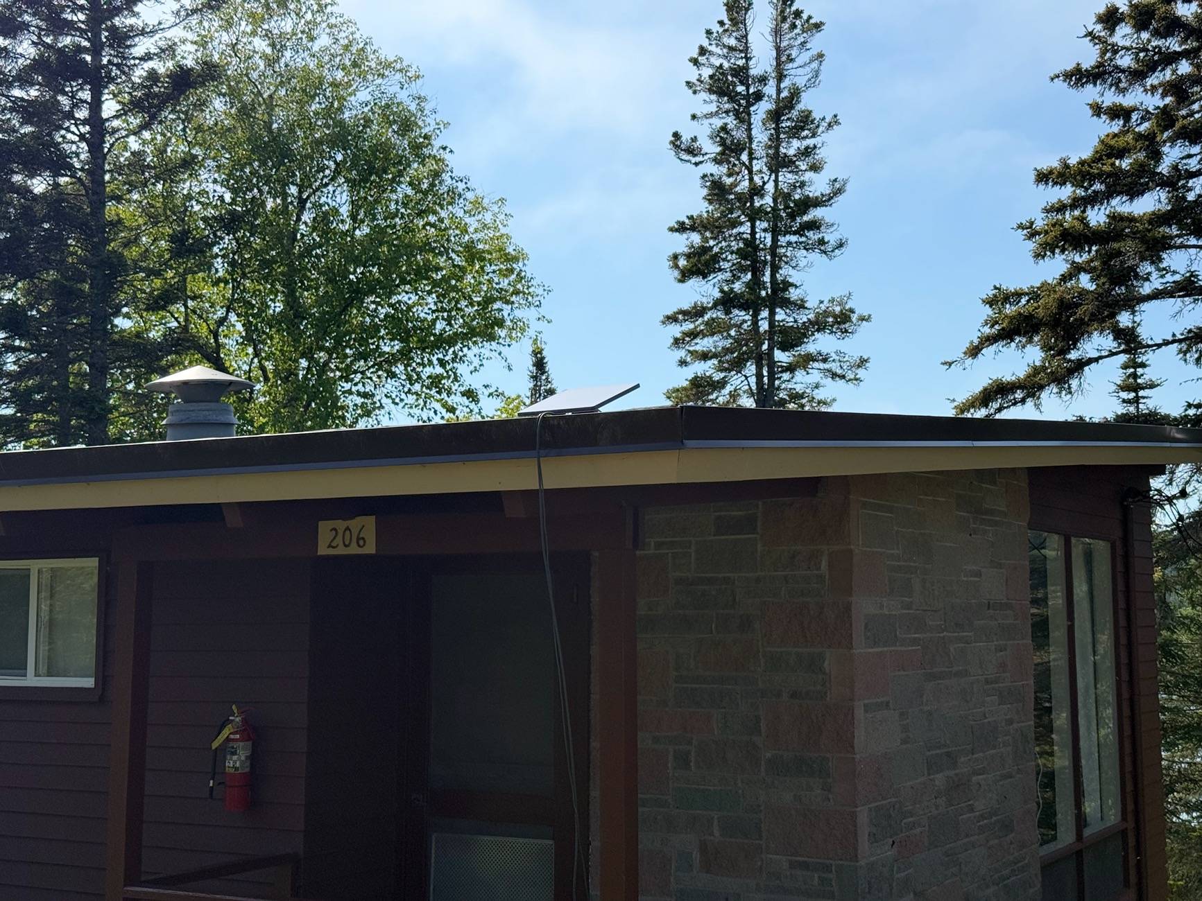

The Setup:

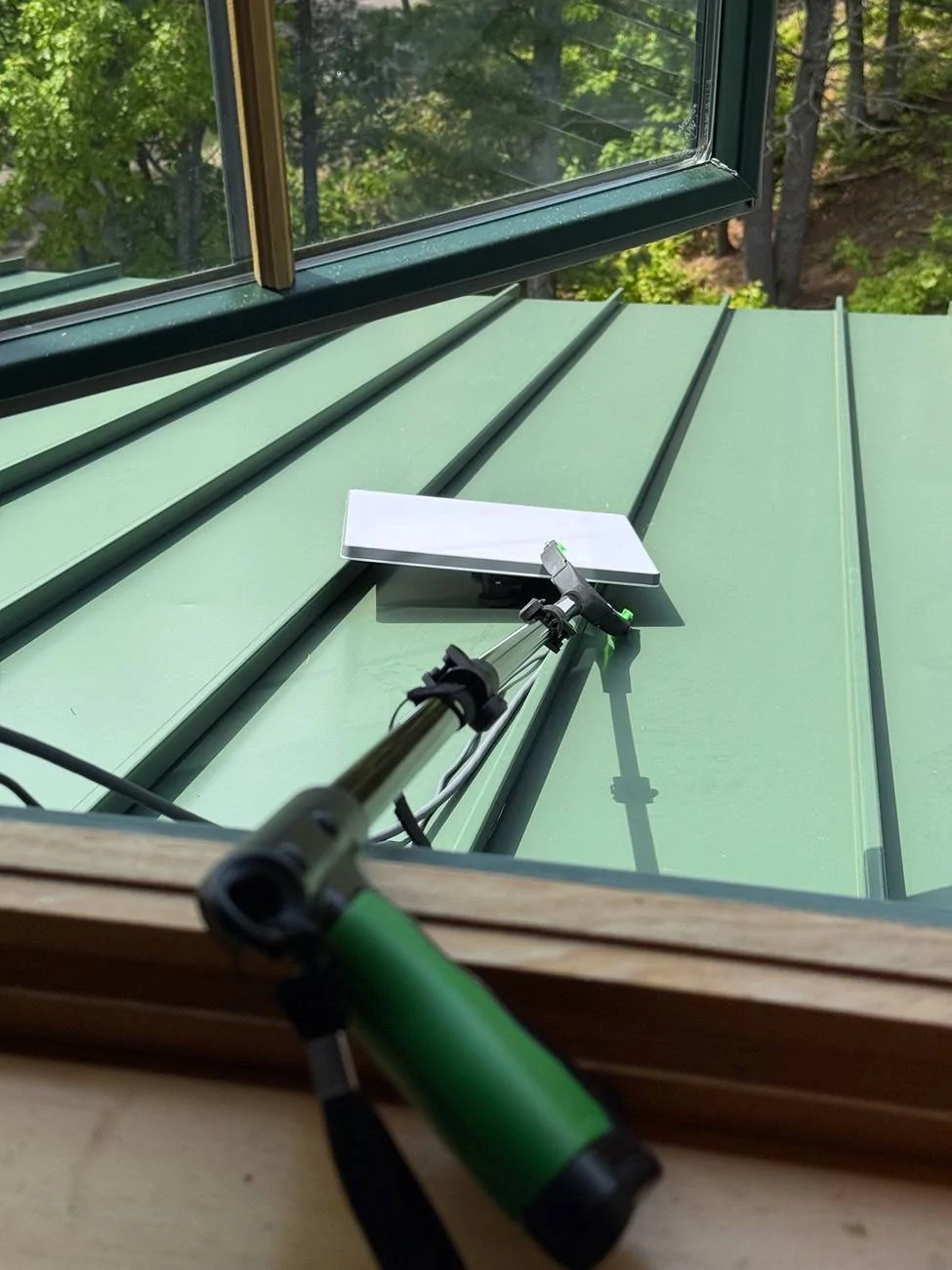

1. Pulled the Mini off its ConTronX car magnet mount
2. Used a 4-foot gripper tool (essential!) to position it optimally without a ladder

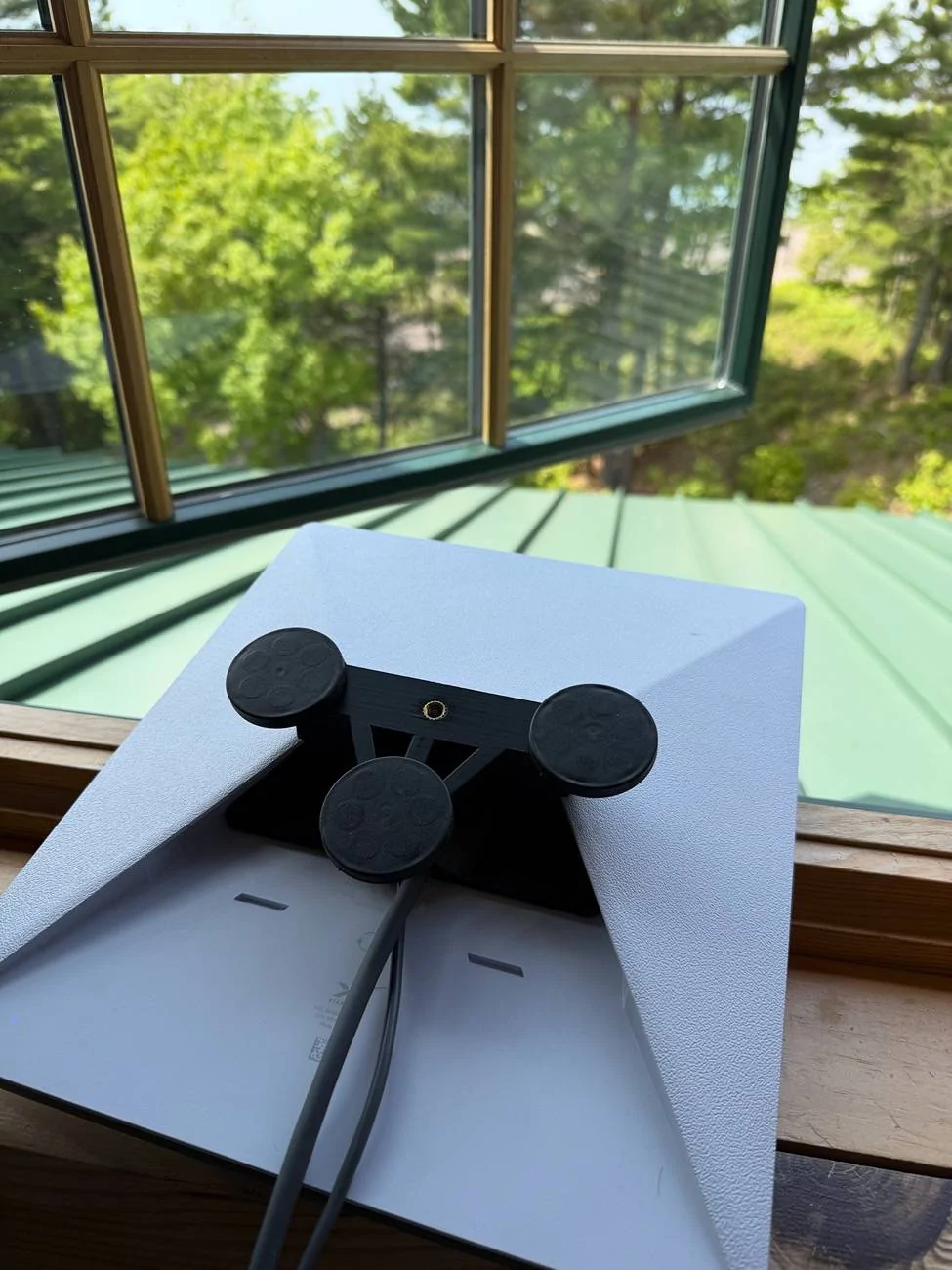

3. Mounted it indoors with a spare magnet base

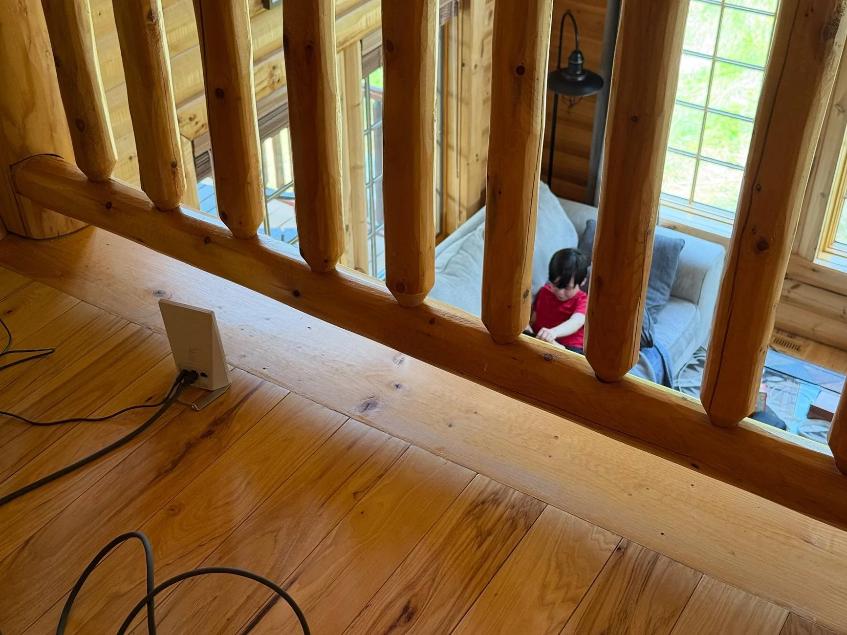

4. Hooked up two Mini routers for whole-house coverage
The Results:
- 150Mbps+ down / 20Mbps up throughout the rental
- Survived multiple Lake Superior thunderstorms without dropping signal

I strongly agree the Starlink mini is a game-changer. We used ours on a 4k mile road trip, where my wife had multi-hour training calls while we were driving and it worked well the entire time. We also have ours on inside suction cup mounts. I don't recall it ever noticeably dropping while driving.
