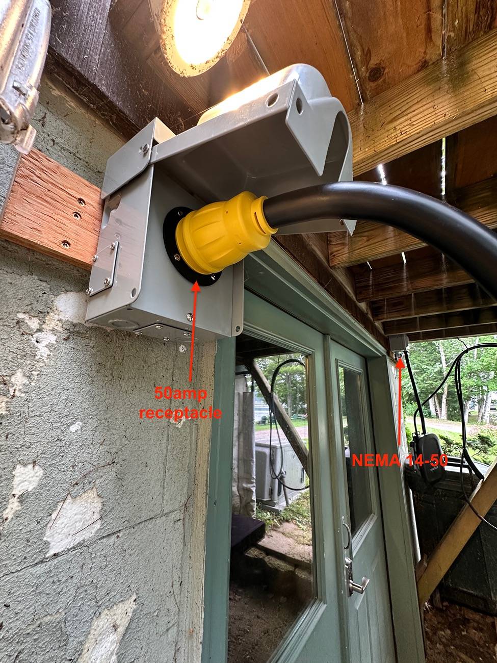

... originally the plan was to install a PowerShare for auto-switching to the CT's battery when the power goes out; but when I looked in March, when I bought my CT, there were no certified installers in my state. So, I looked into putting in an interlock on my utility panel, and installing a 50amp receptacle to manually power the house.
I installed my own NEMA 14-50 outlet back in 2016 for my Tesla, and this install looks to be about the same difficulty, but I had an electrician coming over to wire an outlet for a water heater, so I asked him to do it.

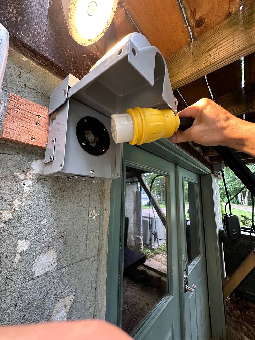

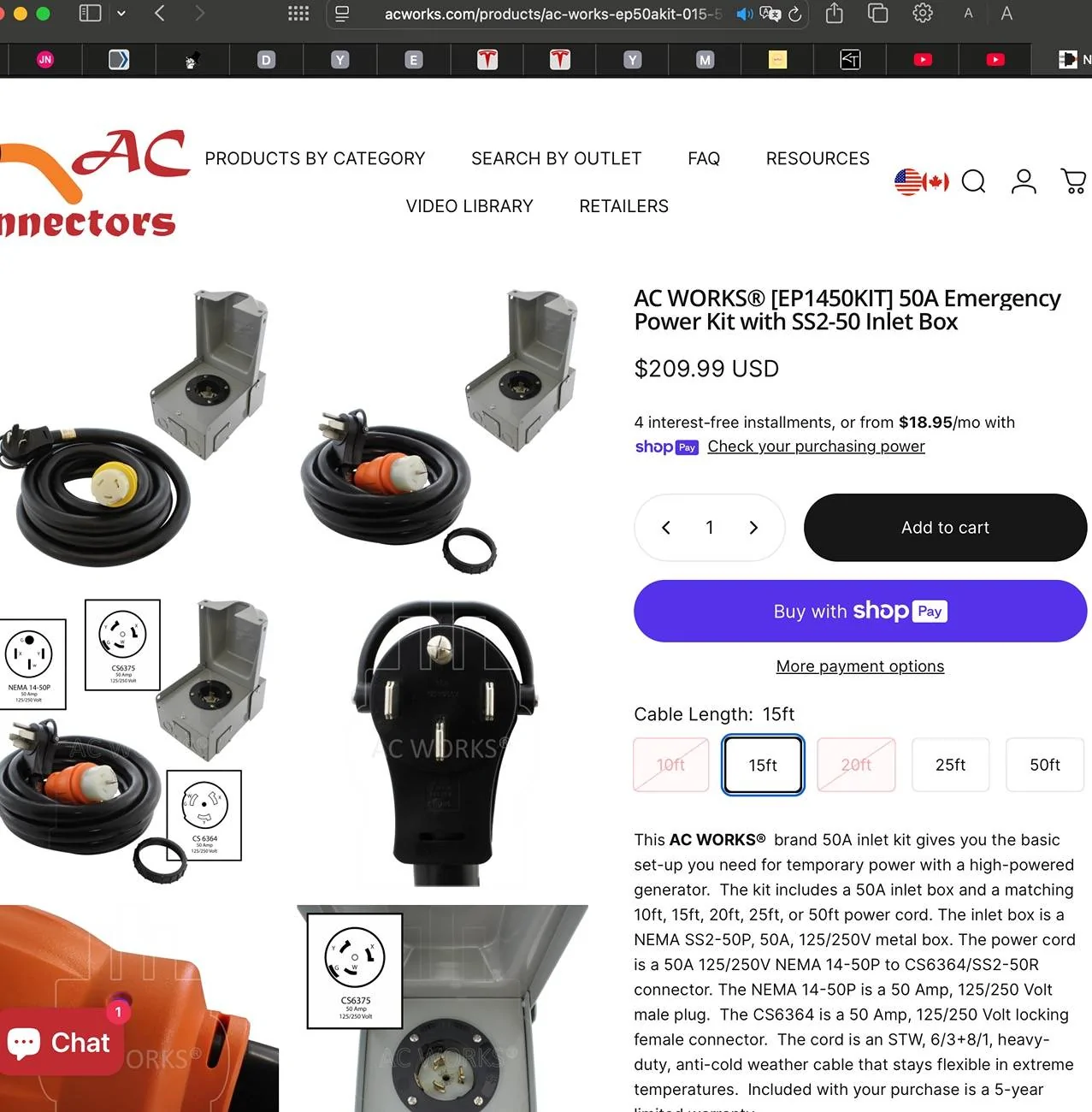

I ordered the AC Works kit, which is just the 50amp receptacle and a 15ft cord:

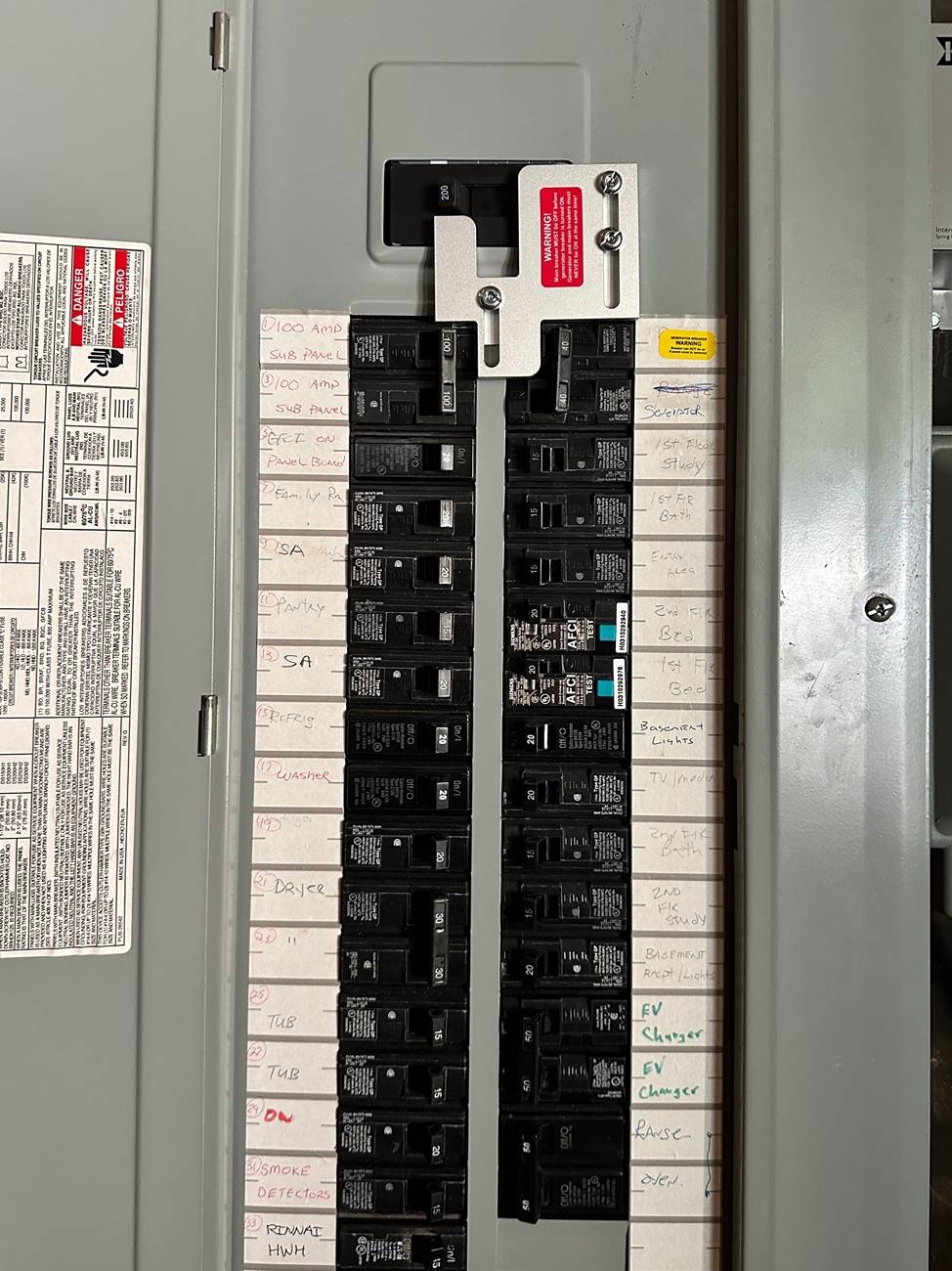

The electrician moved one dual breaker for the range, in the upper right to the bottom, and added the generator interlock to my panel, and mounted the receptacle.

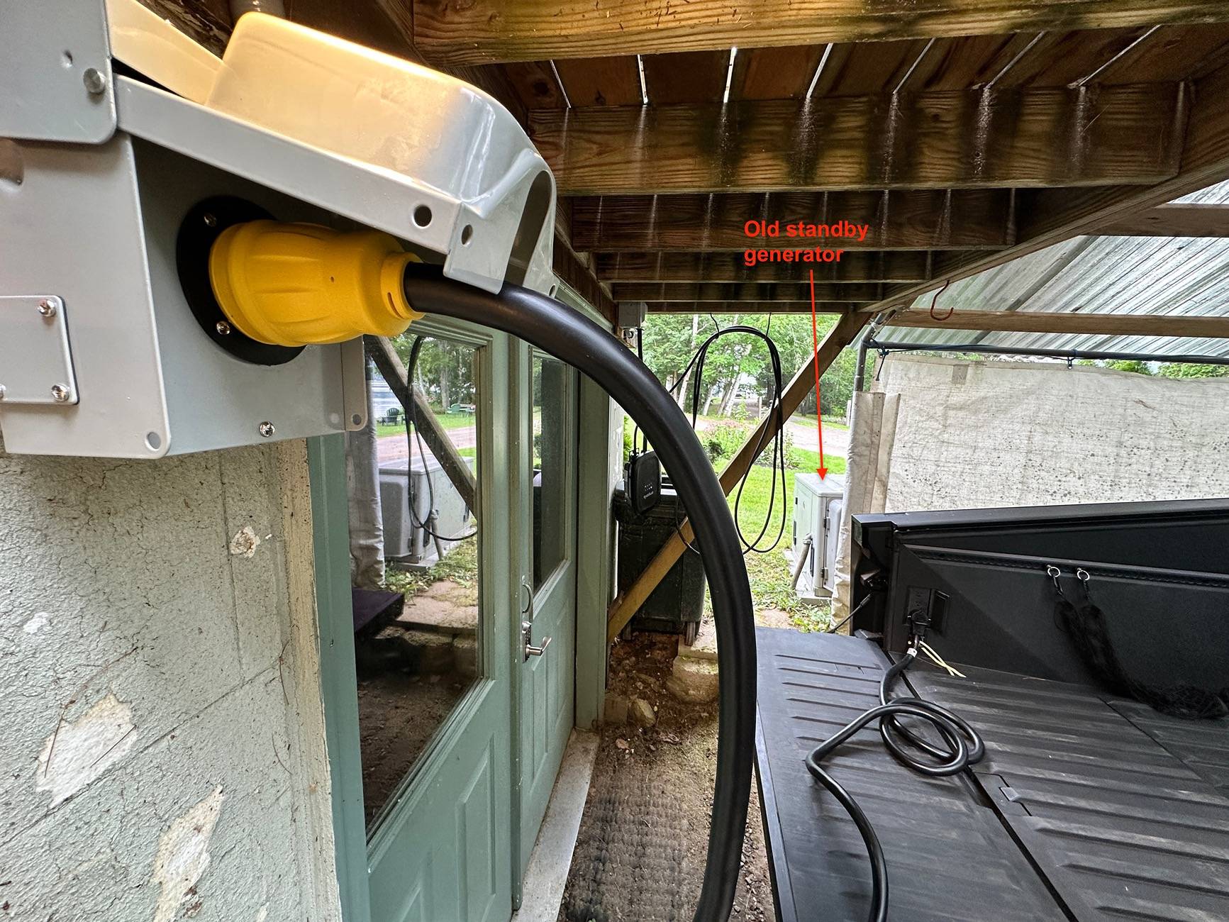

I plugged in my cord:
And plugged it in. You can see my NEMA 14-50 outlet on the right side of the doors, that I installed for my EV charger years ago. $85 in parts!
This will replace my old standby generator that died after 12yrs. I could have bought a new one, but it wasn't as convenient as I was hoping. Pricey, and required annual maintenance and I had to keep the propane tanks filled.
This setup isn't auto-switching, but I hope it's more reliable and requires less storm preparation. Of course, I could also get a regular 40amp gas generator as backup to the CT, if necessary, that uses the same plug for a little over $1000. I turned the utility power off, and switched the panel to the CT, and turned the power back on, and everything works great! Very happy with this simple project. It's very DIY-able, if you don't need a permit.
Now, I'll have the quietest generator in the neighborhood!

This is just a 50amp generator receptacle with interlock. Lots of homes have a portable generator for power outages. These are very basic and don't require specialized knowledge, and the electrician might not even know you have an EV. It's the same install if you use a 10,000+ watt gas generator . And as noted, you can buy yourself a 10,000+ watt generator as a backup for your CT.
