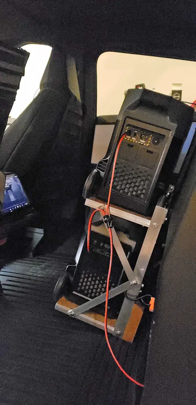

With Grok as my design consultant, I constructed a shelf to support the Delta Pros in the rear seat area using cargo straps to secure them in place. The shelf is made of 6061-T6 aviation grade aluminum and 3/4” plywood weighing 15 lbs:
Tesla Cybertruck My EcoFlow Power Station Range Extender Solution Power Station Shelf
The shelf is 25” wide, 20” high and 12” deep. The cutouts in the plywood accept the Delta Pro’s feet and wheels, preventing the device from sliding off the shelf. The short length of ratchet straps shown here is part of the system for securing the Delta Pros from movement within the vehicle.

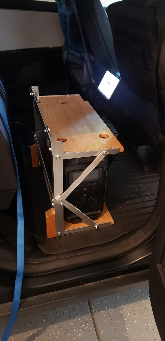

Here is the shelf in the Cybertruck with one Delta Pro in place on the lower shelf:
Tesla Cybertruck My EcoFlow Power Station Range Extender Solution Lower DP  Only
To provide space to fully recline the front passenger seat, the shelf is tilted back 15 degrees, parallel to the rear raised seat bottoms. 500 lb working load cargo straps anchor the shelf and power stations to the rear seat’s metal framework.

This is a long post, so to make a long story short, I have decided to replace my dual fuel generator with a large capacity power station to achieve range extension for off-road travel. I’ve chosen to install two EcoFlow Delta Pro power stations with a combined 7200 watts of charging power for a range extension of up to 20 miles. The dual Delta Pros are installed in the rear seat area of the Cybertruck cabin, not the vault. They are integrated with my 420 watt solar panel system and battery bank giving a total battery capacity of 9.5 kWh.
On our trip to Alaska and the Arctic Ocean (Tuktoyaktuk, NT), I took along my 120V 30A propane generator to add miles to the truck if I fell short of a charging station. I was concerned about the dearth of reliable charging stations north of Prince George, BC. If nothing else, having a way to add charge to the truck reduced the anxiety of being stranded with a dead battery hundreds of miles from the nearest charging source.
It turned out that we didn’t use the generator, although on one occasion, driving in freezing temperatures, strong winds, on a poorly maintained gravel road, I assumed we would have to resort to the generator to finish the 254 miles from Eagle Plains to Dawson City, Yukon. The prospect of having to unload the vault of camping gear in freezing temperatures to take out and set up the generator and propane tank to charge the vehicle at 24A (2.8 kW) for hours, drove home to me the functional limitations and inconvenience of my range extension strategy. I also learned that the restrictions on when I could run the generator at campgrounds and in the company of other campers, further exposed the weakness of this approach. It’s amazing how loud a generator is in the dead of night compared to daytime operation.
I began looking for alternative range extension solutions, and was again drawn to the use of battery power stations which I had once rejected. I own two small EcoFlow River units which have been reliable. EcoFlow customer support has been good, too, so I looked into their Delta Pro series (Delta Pro, Delta Pro 3, and Delta Pro Ultra). The Delta Pro 3 and Ultra provide built-in 240W split-phase power, a definite plus compared to the Delta Pro. They fell short in other important requirements, however, for my use case. My goal was to have a 20 mile driving reserve when off-roading in the Southwest where charging stations are often spaced far apart. I also wanted to add range to the truck in less than two hours with minimal setup time. It turned out that those goals were pretty much impossible to achieve.
With an overall driving efficiency of 474 Wh/mile, I figured I needed 9.5 kWh of reserve battery energy. I already have a 2.5 kWh solar battery system in my truck, so adding another 7 kW was needed. I also wanted to increase my charging speed from the generator’s 2.8 kW to 7 kW (Level 2 rate), and be able to add range in inclement weather at any time of day or night.
I have all I can do to lift my 100 lb generator into the vault. The Delta Pro 3 weighs 115 lbs for 4 kWh, and the Ultra’s 6.1 kWh battery weighs 116 lbs. The Delta Pro weighs 99 lbs for 3600 kWh.
After considering other brands (Jackery, Anker, BLUETTI), I decided to purchase two Delta Pros for $1400 each giving me a combined battery capacity of 7.2 kWh and 7.2 kW of combined 240V AC power when tied together with an extra cost accessory hub ($130).
To improve accessibility and convenience, as well as to protect the devices from road dust that the vault is only partly capable of protecting against on long, dusty desert roads, I decided to install the Delta Pros inside the cabin. It was a hard decision given how valuable cabin space is. Since I was unwilling to move our Bodega refrigerator from the cabin to the vault, there was only one way to get two Delta Pros into the rear seat area and still be able to fully recline the front seats - vertically - which presented another challenge. EcoFlow does not allow the stacking of units, and the Delta Pros must be securely fasten in place.

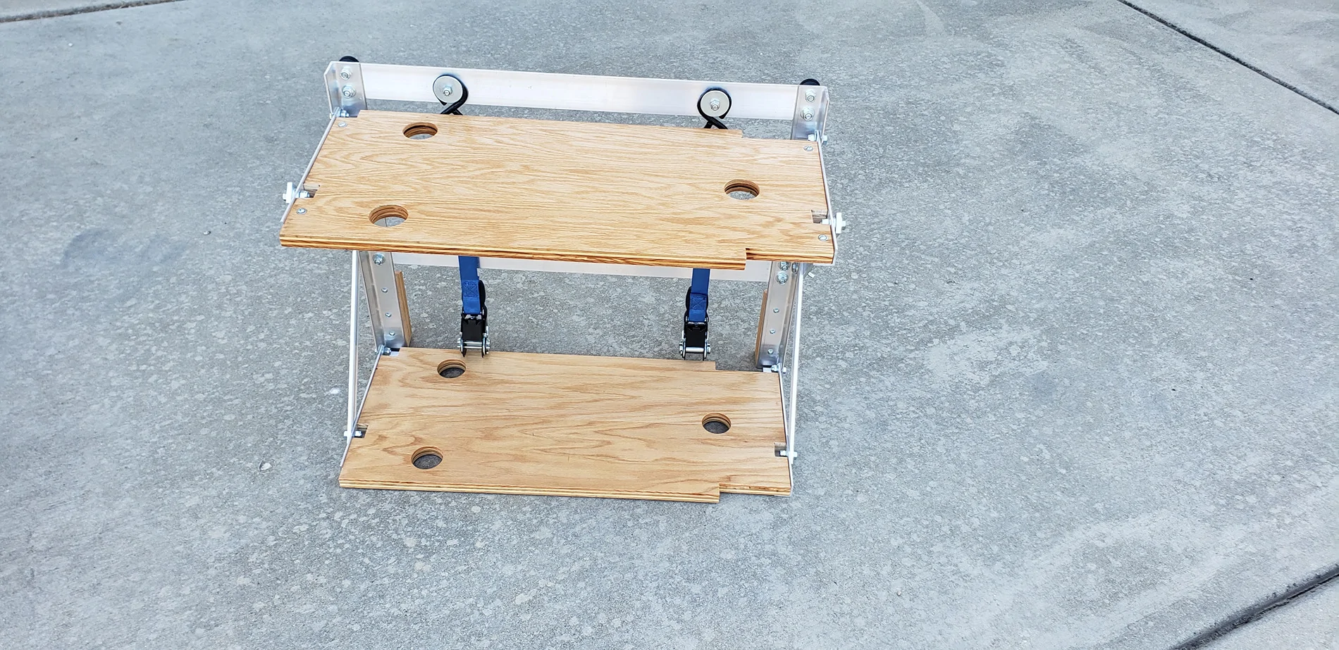

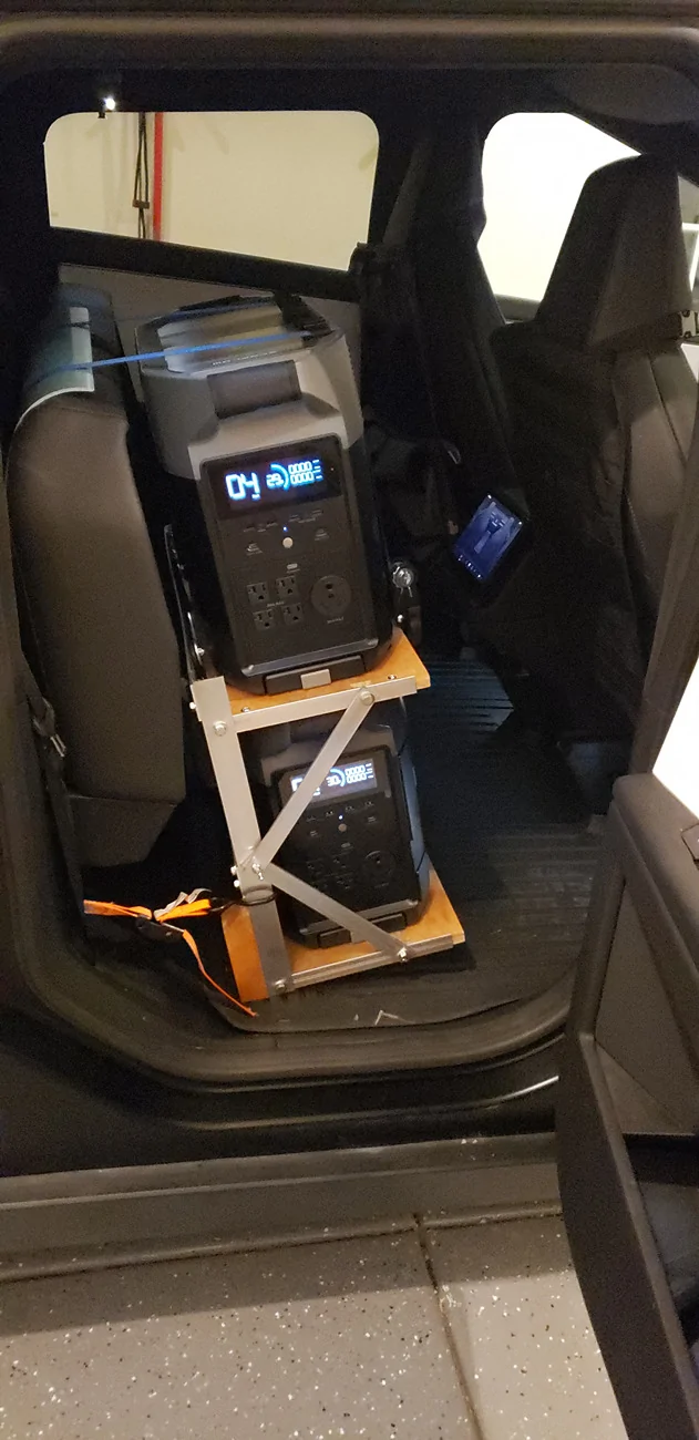

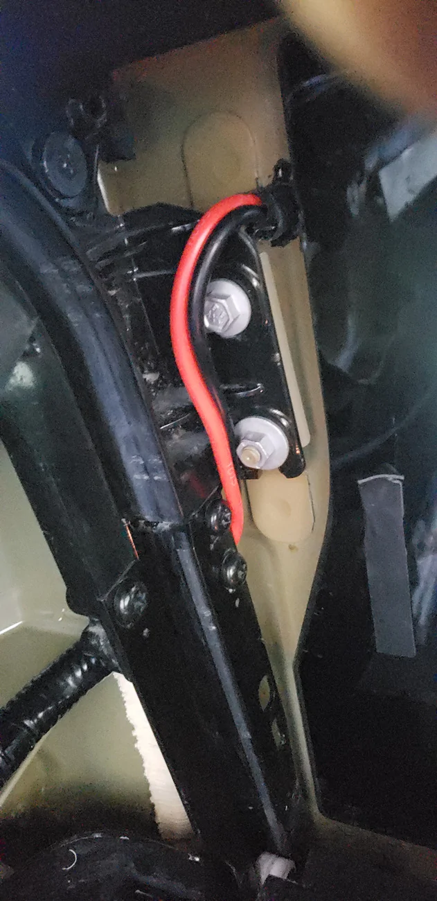

I was able to route the cable from the vault to the cabin through the rear bulkhead without interfering with the tonneau cover’s operation. The cable is routed within the sail, around the tonneau cover’s track where is turns down, and through a 1/2” hole drilled through the bulkhead at the left edge of the rear window:

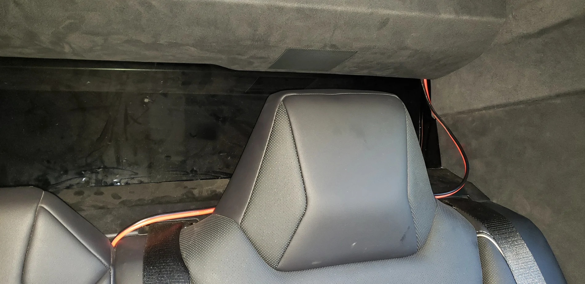

Here’s the cable inside the cabin. I didn’t try to hide the cable behind interior trim or within seat seams:

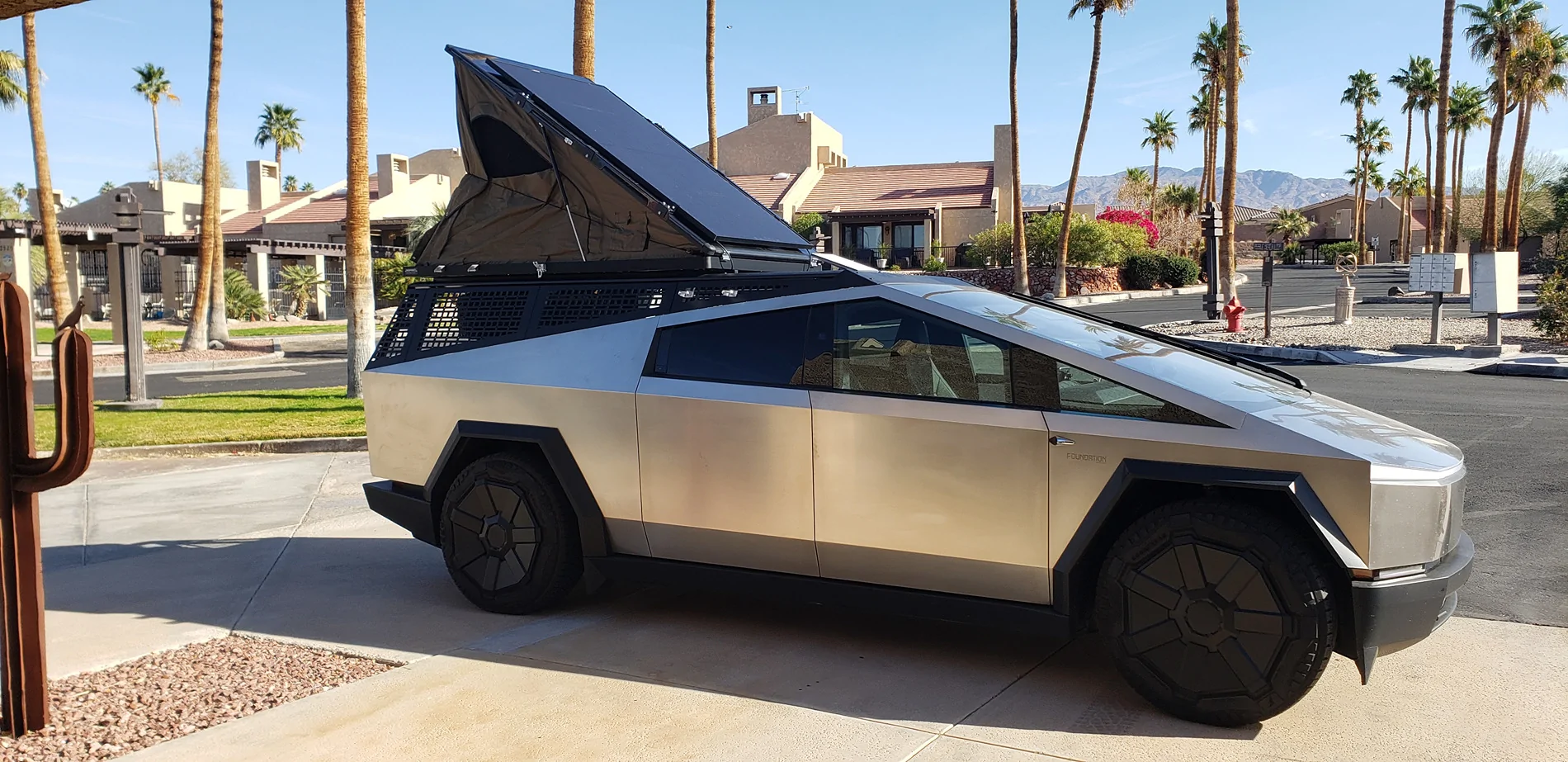

Is there a limiting factor to increasing your array? Not familiar with your set up. Nice battery solution!
I have one 420W panel mounted to the top of my roof top tent. My Renogy Rover charge controller is limited to 20A of solar input.
Very cool setup. Perfect for our upcoming south pole trip.😁 if you don’t mind my asking, what’s the panel you’re using? The size looks just about perfect.
Also, how is it mounted to the tent?
The panel is REC 420W Alpha Pure 2 measuring 73.4 x 40.9 x 1.2 in. I mounted it on Inspired Overland's Carbon Fiber Crossbar Kit which comes with stronger gas struts to handle the weight of the panel (47.8 lbs).
