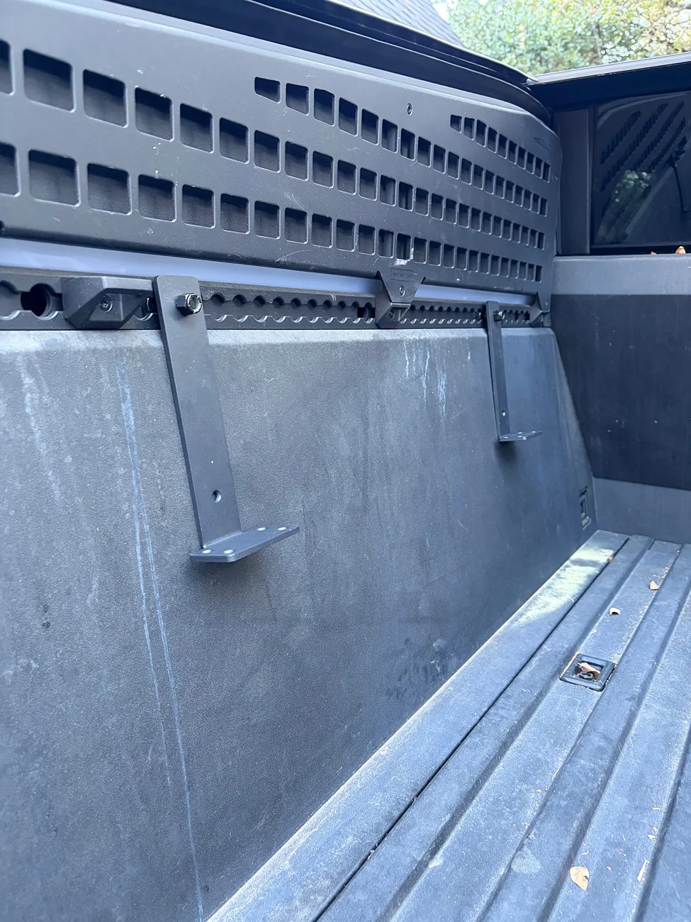

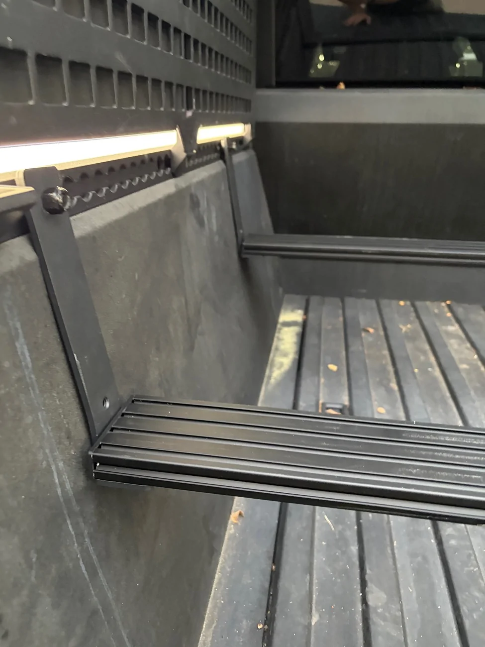

I finally pulled the trigger and bought a tent then “fabricated” a mount. Tonneau cover closes fully when the tent is folded up, with about 9 inches of space under the mounts.
Setup or break down takes about 1 min!
UPDATE:
Below is the list of parts I used, I did have some of this stuff laying around, and there are probably some cheaper alternatives, especially for the 2080 extrusions, but I thought they gave it a nice look, and they line up and bolted well to the "shelf hangers" I used for the drop down.
With the below really not much modification needed. Really just two or three things:
1. You have to cut the 2080 to length which is a bit tricky as the bed is not square and the side has some flex to it, so to get a tight fit you have to cut just a bit long.

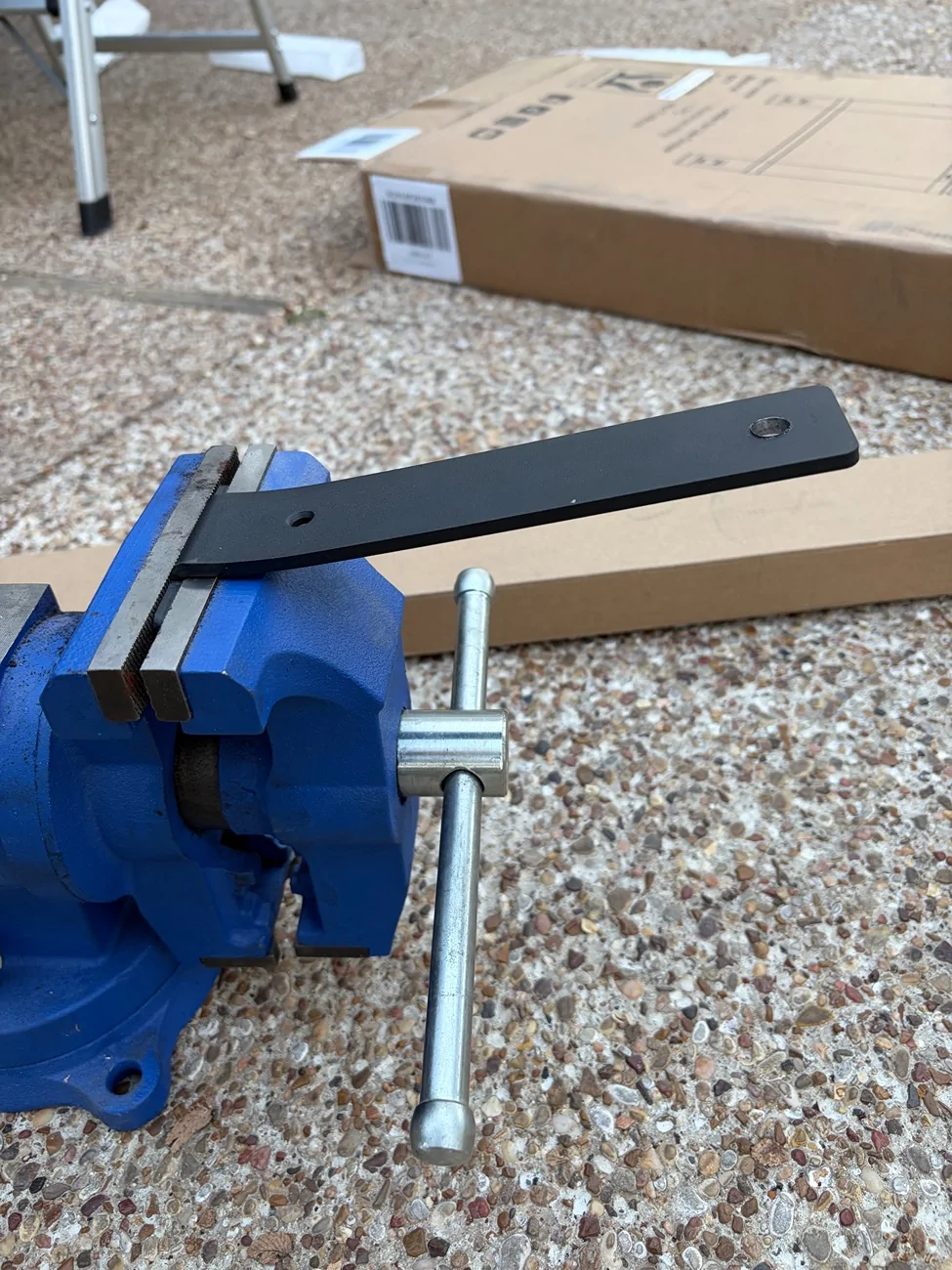

2. Drill out the top holes on the hanger to fit the t tract bolts. You have to bend the shelf hangers, I just placed the short end in a vice and bent the arm, eyeballing it.
3. Optional cut the u bolts to get maximum clearance under the tent.
I think the build is fairly straight forward, t track bolts go in the t tract, rails supports (shelf supports) attach to the t tract bolts. The 2080 then bolts to the shelf supports (holes line up). Place the tent on top, and use the u bolts secure. Just have to get skinny to get underneath to bolt it on. Probably take 2-3 hours. I am sure everyone on here will have even better ideas/improvements. I am interested to see what everyone does with it.

Thanks! I am really happy with how it turned out. I raised it as much as I could to still clear the tonneau cover, ended up with 9 inch space underneath.
Honestly most of the items can be purchased of the shelf with minor mods, I’ll dig up the links for the items. I think about 150-200$ for the mount set up, but could be done cheaper. Tent is the expensive bit, runs ~ 1 k

When you say "clear the tonneau cover" are you referring to when you flip the top half out towards the back?

Yes

It was a balance, when I say clear the tonneau, I just mean it closes without any difficulty, the tent does have to be mounted back from the cab just a bit for ladder to clear the tail gate, but not much. Of course the further back the tent is sitting the lower it has to be, since the tonneau slants down.
