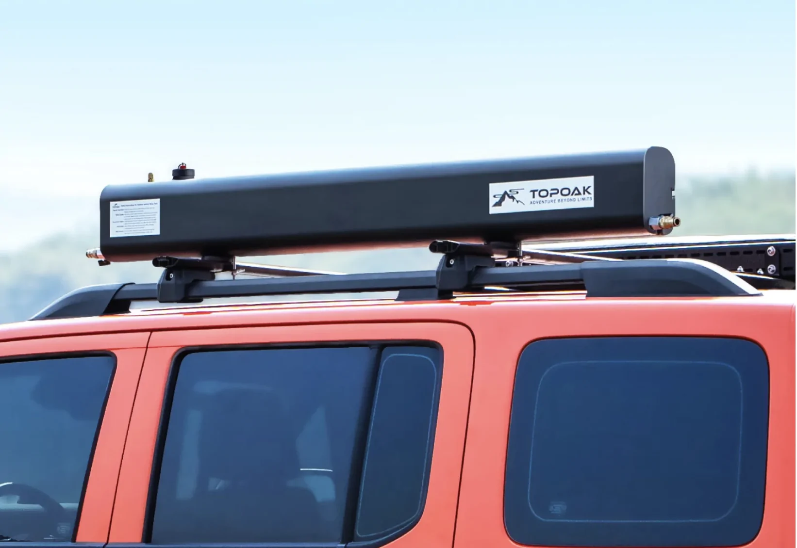

Two 8-gallon water tanks are from TopOak, here:
https://topoakoverland.com/products/roof-rack-water-tank
Tesla Cybertruck Urander Rack + Water + Shower + Starlink HP Gen 1 Solution 1772999085540-1c
They came with all the accessories needed to install them under the rack crossbars. They aren’t designed for this, but I put my “Macgyver” thinking cap on to repurpose them once I got everything and they are as solid as can be. The trick is connecting them together at the bottom so they form an incredibly stiff composite truss that doesn’t move at all. One day I may make one heated as @CT_AZ_4x4 did. But it’s 8-gallons so I’m not sure what heating element to use for that much water. There are several penetrations, like where those included temperature sensors are mounted, so maybe more that one heating element could be used. I may wrap insulation around that one as well to retain heat better.

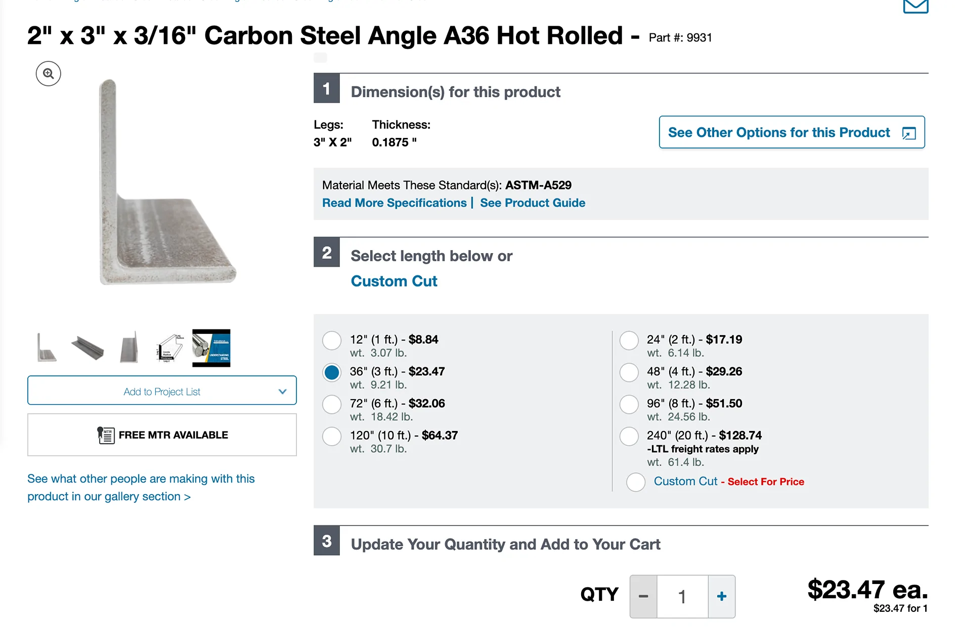

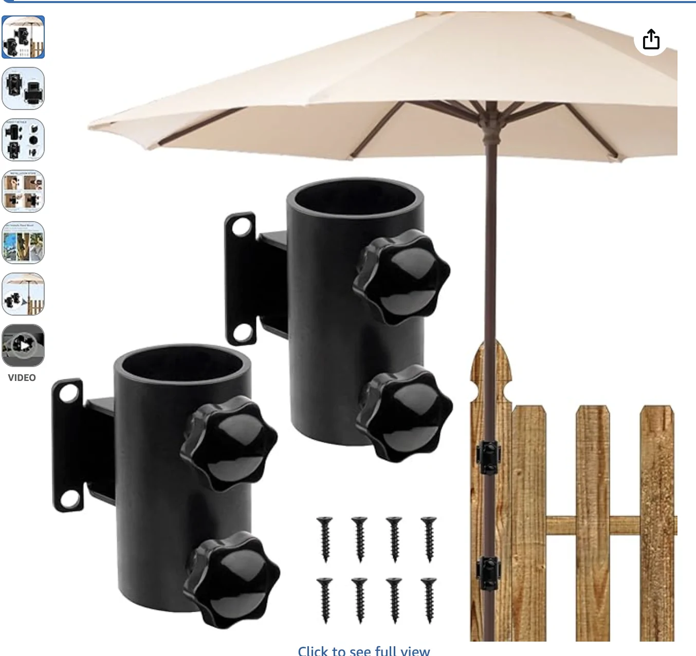

The Starlink Gen1 HP system I got off Ebay, unused, for $500. I bought a piece of 3-ft x 3” x 2” steel angle online and cut it and made the mounts myself…painted with Rustoleum direct-to-metal (DTM) black paint. The integrated pole of the dish is secured with these from Amazon:
https://www.onlinemetals.com/buy/ca...75-carbon-steel-angle-a36-hot-rolled/pid/9931

https://www.amazon.com/dp/B0FFYKNN46?ref_=ppx_hzsearch_conn_dt_b_fed_asin_title_1&th=1

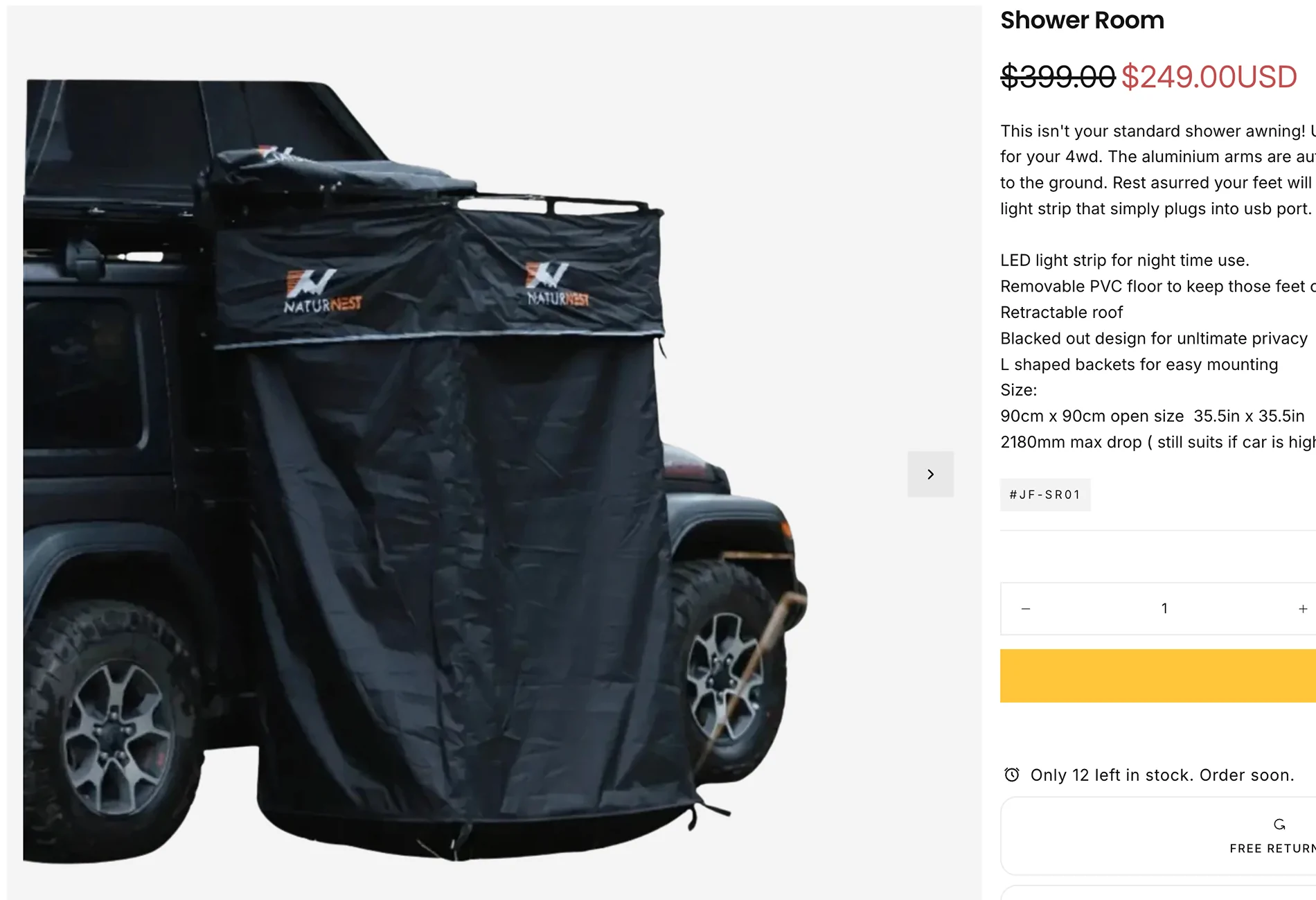

The shower is from Naturnest:
https://www.naturnest.com/products/naturnest-shower-awning

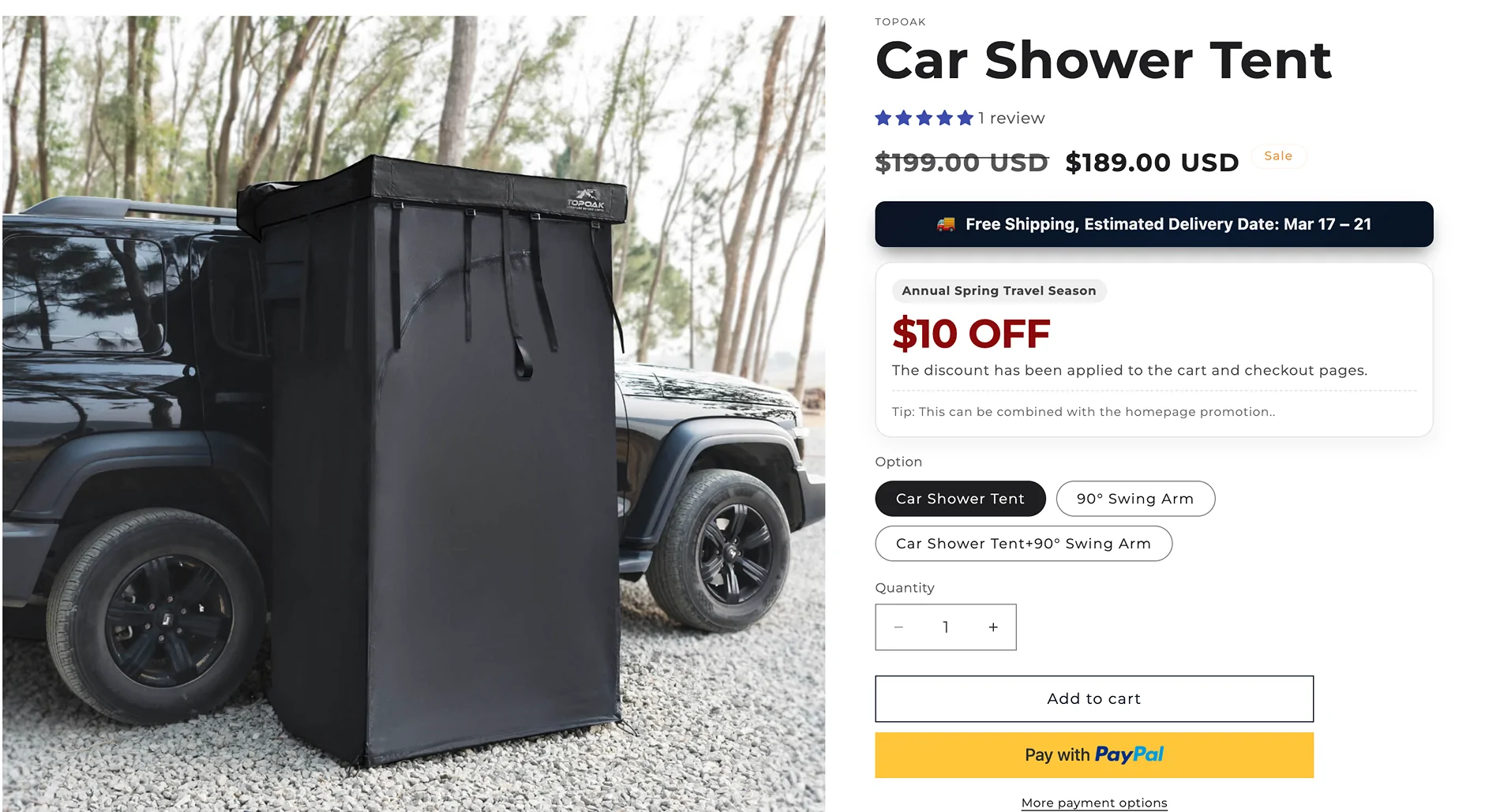

Topoak did not have a shower at the time I ordered, but I just noticed they do now, and for cheaper:
https://topoakoverland.com/products/shower-tent

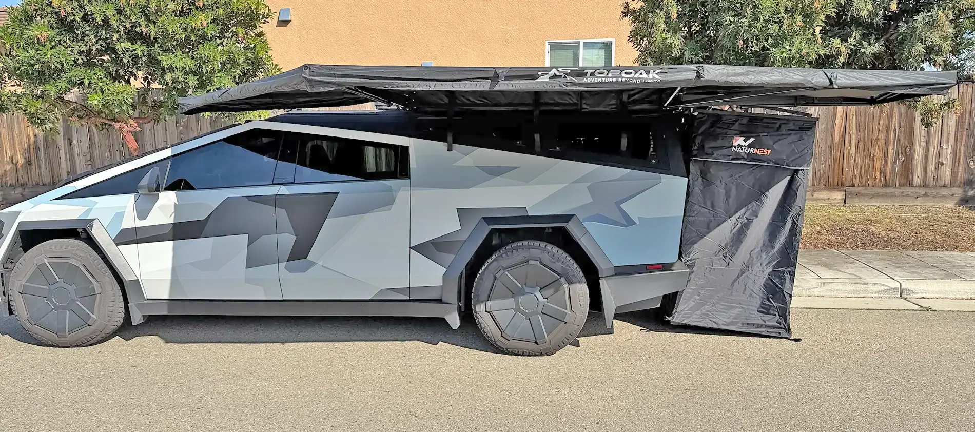

So, here are pics of the setup:
Tesla Cybertruck Urander Rack + Water + Shower + Starlink HP Gen 1 Solution 1772999308388-e4
Tesla Cybertruck Urander Rack + Water + Shower + Starlink HP Gen 1 Solution 1772999396380-h
Tesla Cybertruck Urander Rack + Water + Shower + Starlink HP Gen 1 Solution 1772999739557-mg
Tesla Cybertruck Urander Rack + Water + Shower + Starlink HP Gen 1 Solution 1772999928380-u2
Tesla Cybertruck Urander Rack + Water + Shower + Starlink HP Gen 1 Solution 1772999954492-3m
Tesla Cybertruck Urander Rack + Water + Shower + Starlink HP Gen 1 Solution 1772999981189-79
Tesla Cybertruck Urander Rack + Water + Shower + Starlink HP Gen 1 Solution 1773000010889-3r
Tesla Cybertruck Urander Rack + Water + Shower + Starlink HP Gen 1 Solution 1773000032893-27
Tesla Cybertruck Urander Rack + Water + Shower + Starlink HP Gen 1 Solution 1773000061337-5y
Tesla Cybertruck Urander Rack + Water + Shower + Starlink HP Gen 1 Solution 1773000082172-1x
Tesla Cybertruck Urander Rack + Water + Shower + Starlink HP Gen 1 Solution 1773000102657-n1
Tesla Cybertruck Urander Rack + Water + Shower + Starlink HP Gen 1 Solution 1773000128237-f
Tesla Cybertruck Urander Rack + Water + Shower + Starlink HP Gen 1 Solution 115048-1bd454d71f02defdef8baa5547e1f8a0
Tesla Cybertruck Urander Rack + Water + Shower + Starlink HP Gen 1 Solution 1773000212846-wr
Tesla Cybertruck Urander Rack + Water + Shower + Starlink HP Gen 1 Solution 1773000264005-xq
Oh, and the rack is obviously from @Urander which makes all of these add-ons possible. I absolutely love the rack....especially with the tempered glass exterior windows! And as you can see it also has Mole panel interior doors that open too. I really don't think there is a better rack out there...especially for the price:
https://urander.com/products/bed-rack
And the 270-degree awning is from Topoak as well as the RTT up top, a Topoak Vision XL. But I think I posted enough links for now since this post is so long.... but ask away with any questions!
P.S. I have my CT suspension on low or entry here. Obviously raising it up would give more headroom and also make the shower appear more stiff as the weighted bars at the bottom would go off the ground. In hindsight I should have raised the suspension before taking the pics, but oh well 🤷🏽‍♂️. Also, the shower has it's own roof but it is unnecessary when my 270-degree awning fits over top of it. Or, who needs a roof anyway if weather is good! 😊
