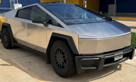

I tried several approaches to polishing. I ended up with a 3000 grit finish all around using a RO-sander and 3000 grit wet sand paper. I tried some parts with 2000, 3000, 5000, 6000, and even 10,000 grit. It seems the more I went up in grit the foggier the finish seem to get. 7000 grit was nice if you wanted to polish it afterwards with a buffer, but I found the 3000 is more practical and easy to repair scrapes and scratches if you get some.
Tesla Cybertruck Cybertuck I polished on the North Shore of Hawaii 🤙🏾🙏🏽 CT polished 3000 grit
i like this, looks a little shinier but yeah not mirror. how long did this take to do and was it fairly "easy"?
I spent about 8 hrs on it total. I used 1000 grit wet/dry just dunking my air Orbital sander into a bucket with the sandpaper ( hook and latch type ) and went over the body with circular motions until it was the same texture and then switched to 3000 grit and did the same. It cleaned up great. Then I used a car 10" buffer with BarKeeps . It will shine it just a little more.
