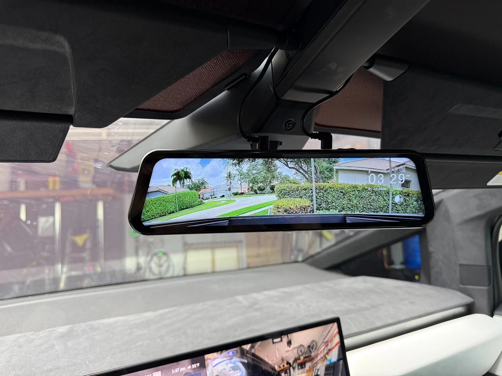

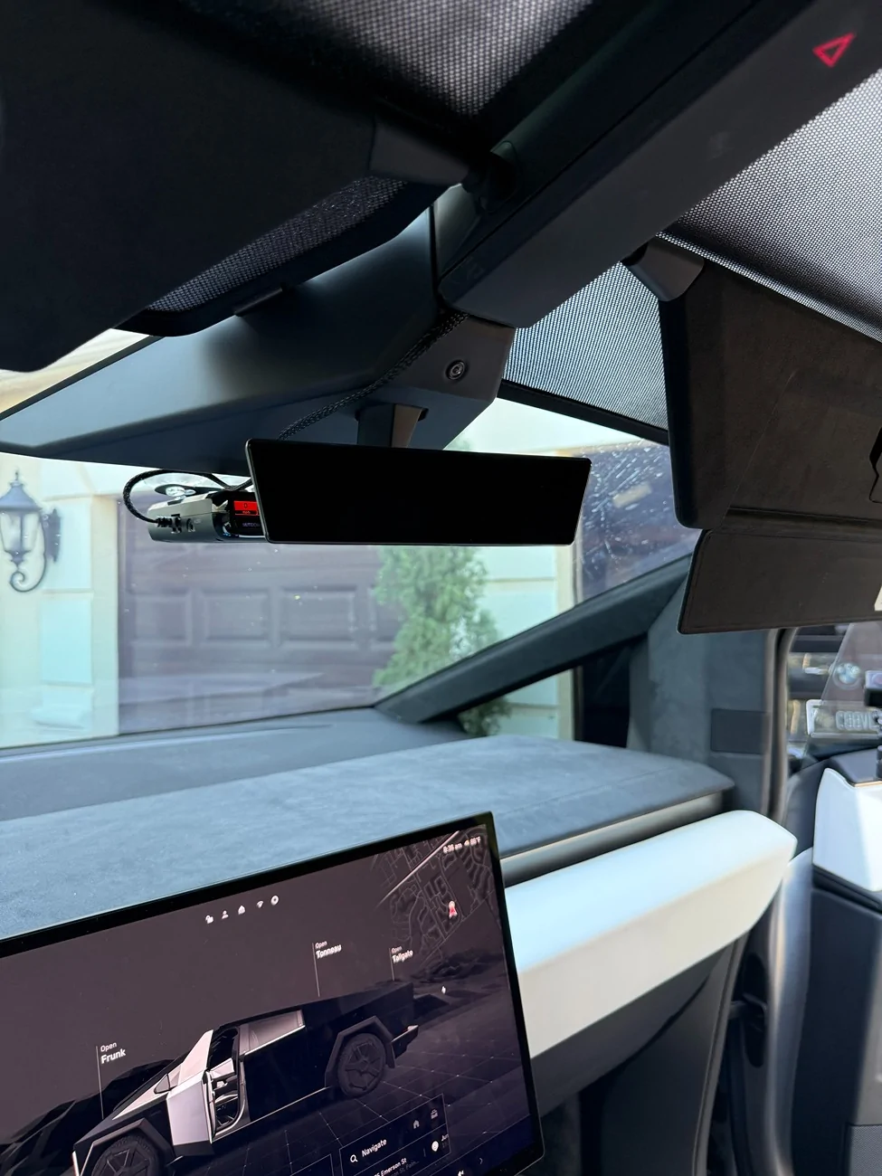

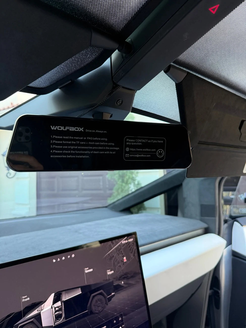

I received this product at no cost in exchange for my honest review below.
Opening the box I was initially quite impressed. Shipping was really fast and they included a lot of items, all individually packaged. It might be silly, but the quality of the packaging was higher-end so I could tell they cared. I opened each of the packages and soon realized that this was going to very much be a "figure it out" install and not a Cybertruck specific process. The kit and included materials were all generic meant for your typical 12V vehicle. The kit came with no installation instructions aside from connect power, connect camera. I didn't think I was going to be able to use it for 2 reasons - the OEM mount for the mirror is not compatible with our vehicles and the multiple power cables they sent were all for 12V vehicles. I contacted support and while responsive and very willing to help, I don't think they understood the Cybertruck nuance and how atypical this install was. Eventually, they pointed me to their OBD2 power cable, which was the simplest way to get power to the screen. They also sent this free of charge and that was the piece I needed to finish the install. The other issue was the screen mount. I ended up using the straps, but they fit loose since the OEM mirror is so small that the Wolfbox tends to bounce and shake a bit while driving. It is usable however.

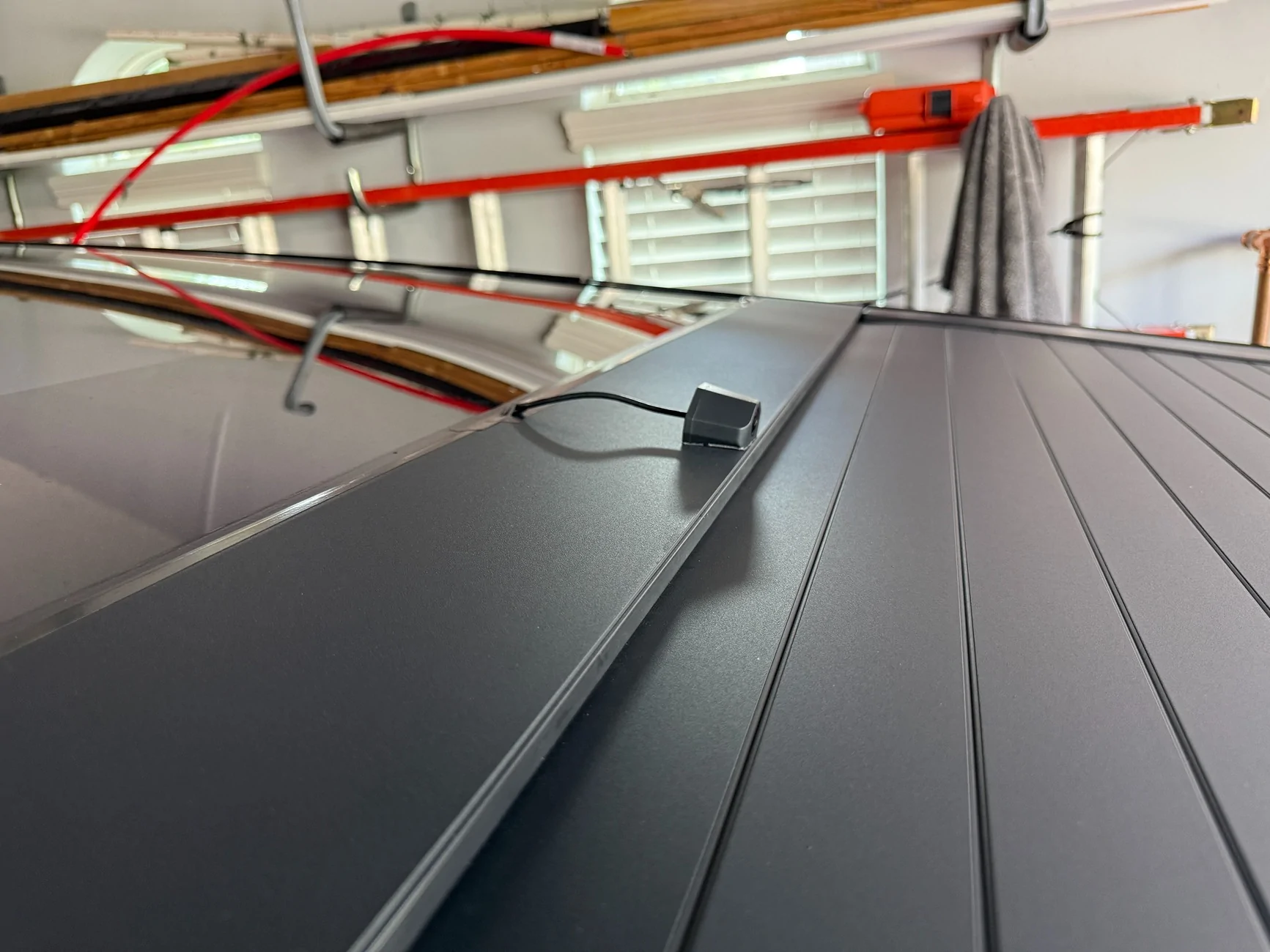

Moving on, I used a couple of YouTube guides to install the power and camera cables. Power cable was pretty straightforward. The length was perfect and it was easy to run with not much guidance. The camera cable was bit trickier but also not too bad. The length of the cable I thought was going to be an issue (it's way too long), but I was able to wrap it under the side panels above the doors.

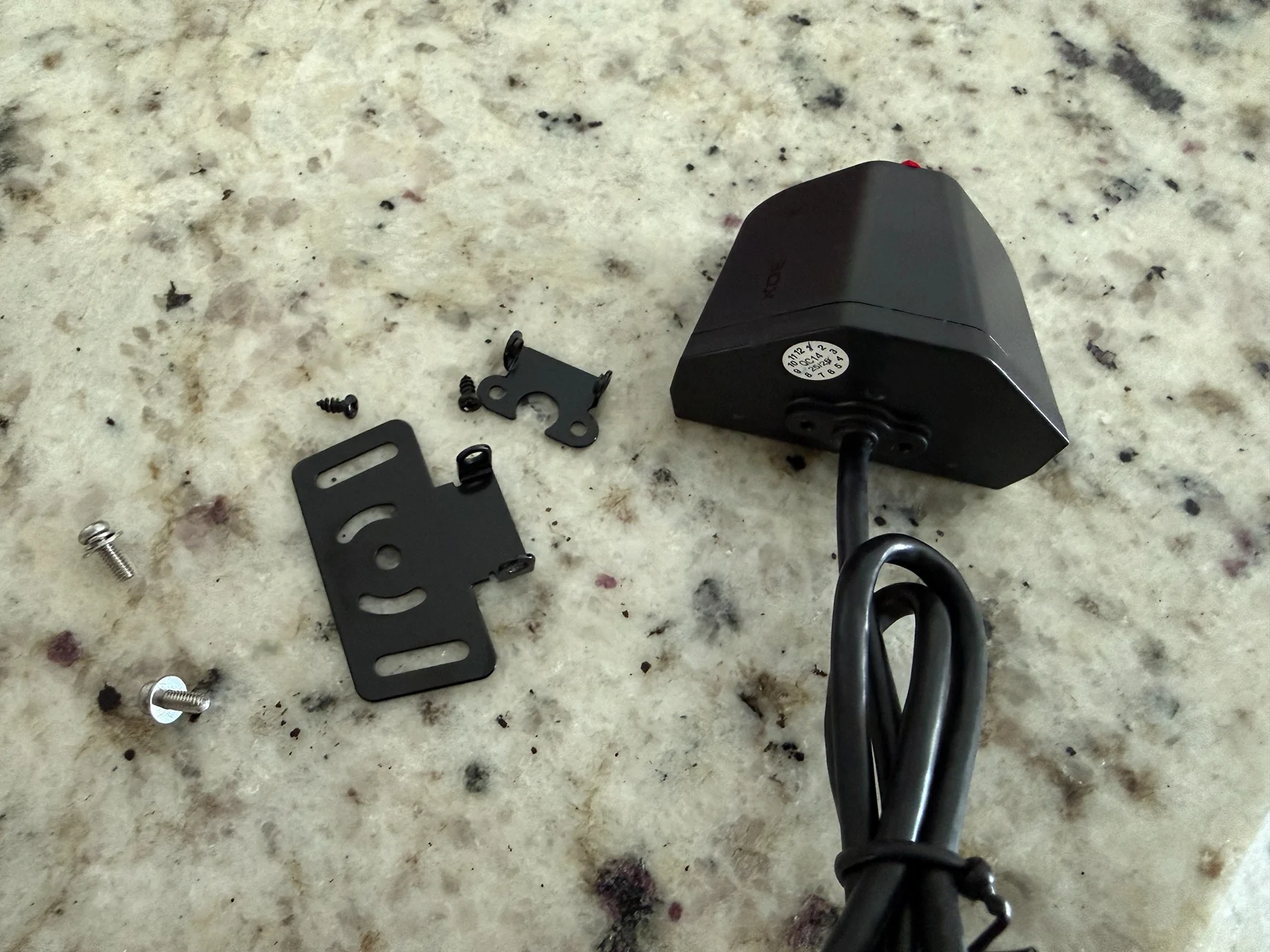

I removed the camera mount and used VHB to fix the camera directly on the panel above the tonneau cover where everyone else puts it. I put mine a bit lower on the panel so I could see in the truck bed, which led to about 5-6" of wire that are driving me nuts (see pics). I will figure out a way to hide it, I already have a few ideas.
The screen itself is massive, quite a bit bigger than I would have purchased on my own. Quality is great however. Clear picture (often better than the OEM one) day and night and a very responsive menu. I didn't bother to install the GPS since I really just wanted the rearview camera. I'll attach a few pictures below.
Aside from the install, my only complaints are 1) it doesn't turn off automatically since I think the OBD2 port gets power all the time, so I have to remember to turn it off if I'm going to be somewhere for a long time. 2) The FOV of the camera is exactly like the OEM one, which is way too wide to be able to judge the distance of a vehicle behind you. I may try to use a replacement camera if I can find one on Amazon that's closer to 80-90 degrees.

Yeah I agree. That would be a lot cleaner. I imagine they didn’t because it could interfere with the oem mount they offer.

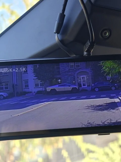

I have the G900. It works pretty well. Solves the problems of dirt/rain on the OEM rear camera, and having tailgate down. Extra dashcam angles are a plus too.
Quick tip on the really wide angle. At least on the G900, you can swipe up/down at the far right side of the touchscreen and it will adjust zoom. Swiping up/down the center pans the image.
This thread shows where you can tap into for power.
https://www.cybertruckownersclub.co...ar-view-mirror-compartment.20118/#post-357744
Step down converter, from 15V to 5V USB: https://www.amazon.com/dp/B0CMT4PM7J/
Flat USB-C cable: https://www.amazon.com/dp/B0DP4HRQDP/
Some adapter-ing, soldering, and/or tapping wires may be required.
Thanks for that. I was able to adjust the zoom. Screen was being finicky and didn’t respond well so had to power cycle it to get it working.
I wanted to power it from the gear selection panel but already have my radar detector plugged in there. Not sure there’s enough juice for both.

@GardensCT Interesting and valuable installation review.
While digital mirrors offer now a very good definition, similar to the video image than you get with a cellular phone, the major concern that I noticed with the different digital mirrors that I tested was often the lack of luminosity during the day, especially in a sunny day compared compared with regular mirror.
- I wonder if the Wolfbox G900 Pro mirror has an automatic luminosity adjustment
or provides a slider button allowing to adjust manually the luminosity setting?​
I wonder if there is no special mounts for the CT to make the install looking like OEM.
See for example: WOLFBOX OEM Bracket for USB C G900PRO Mirror Dash cam
I wonder if the ODB2 voltage drop from 12V to a lower voltage, when the CT goes to sleep,
a feature used by some devices to go into Standby Mode?

I’m still waiting for a complete solution that’s proven to work seamlessly. I have a S92 on the bench but won’t install it until they provide a power connection that leaves the right side speakers operational. Your always-on issue and mounting incompatibility kills this one for me. Thanks for posting.
I have mine wired up with the USB-C from my center console. I got tired of waiting for a solution to the power issues they had. This is the cable I used, I got the 15V instead of the 12V. I can't remember what the reason was, but I something to do with power output. It's not hard to set up at all, just a pain to route the wires.
Wow thanks. There’s a direct plug-in or did you cut it and wire to the mirror harness?

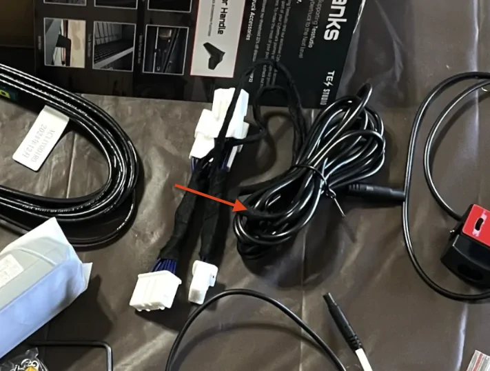

I have the older version that just had the cabin camera tap, but if this is the harness, it's likely that if you unpeel the tape where the arrow is pointing you'll see just two wires, maybe three.
If it's two, it's just power and ground. If it's three (Yellow, Red, Black), these mirrors use the Yellow wire as a "Key On" since they were originally meant to retrofit older cars. Take the Red & Yellow, twist them together, that goes to the positive on your 12V source, black goes to negative. Mine had the R/Y/B combo.
If you want to send me pix of your harness, I should be able to help you out better.

@GardensCT
As far I can tell there's no auto brightness setting, although it can be adjusted manually. It's plenty bright at the medium setting I have it on.
@GardensCT
I should have mentioned I ordered it with the OEM bracket, which looks like the part in your link, and is of no use to us.
@GardensCT
They do have some OBD2 power options on amazon that indicate they will do this - but they one they gave me was free so I used that one.
