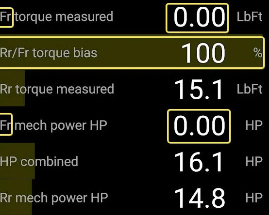

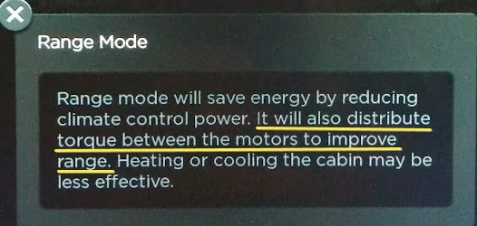

On my 2017 Model X, I have 'range mode' that biases the rear over the front and I use it for road trips. Not sure what is going on with the Rivan, but I do not seem to have excess tire wear on front vs rear.
Note that any acceleration and the front immediately "kicks in."
Tesla Cybertruck Tire life / longevity for Cybertruck? Post yours HMgFCwo
Testing using ScanMyTesla screen
With range mode -- using Rear motor (see 0 HP and LbFt below on 'Fr')

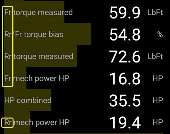

Without Range Mode turned on it is using BOTH front and rear.

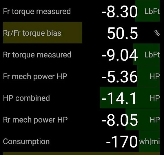

Regen uses both still.
