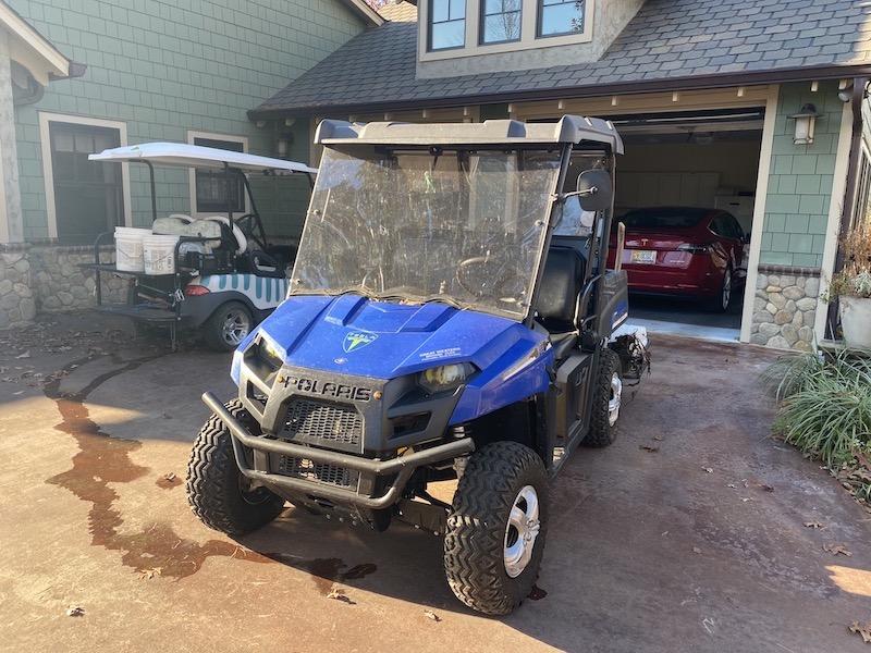

Polaris has been putting this type tire on their military off-road vehicles for a number of years.
