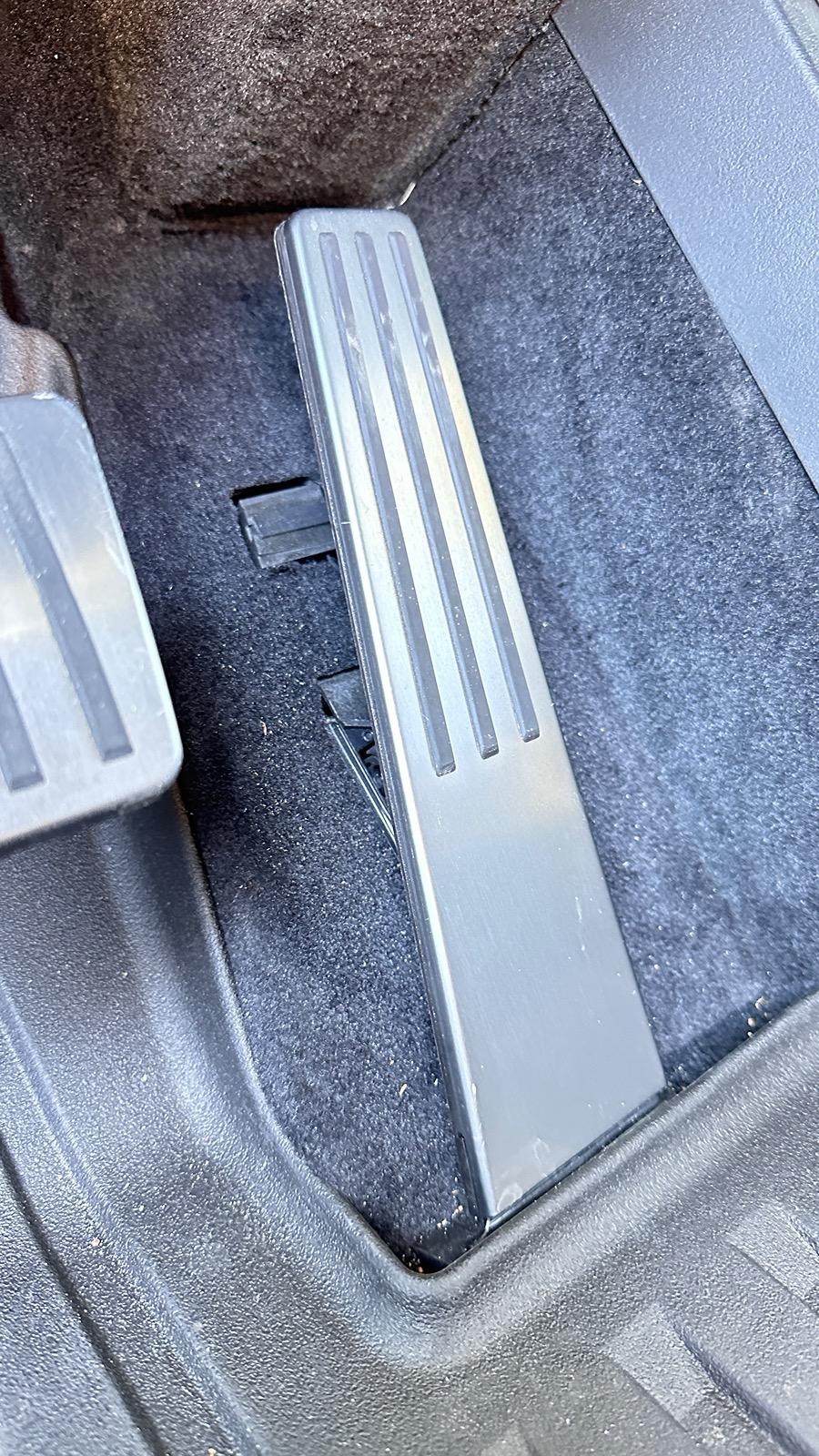

I popped mine off without trouble. Only held on there by two plastic clips. For now, I’ll just drive without the cover.
If yours is secure like some are reporting, I wouldn’t worry about it at all. Just be aware and also keep in mind that you can press the brake pedal to override the accelerator.

After thinking about this some more, I’m not sure this is the issue. Communication didn’t come from Tesla, and our information is just from people online playing with their accelerator pedals.
The metal accelerator cover has a rubber casing, and it’s not slippery. IMO, it’s unlikely to slip forward even under heavy acceleration. In order to pop it off, I had to apply a perpendicular force in the direction towards the driver, which is the opposite of what would happen under acceleration.
