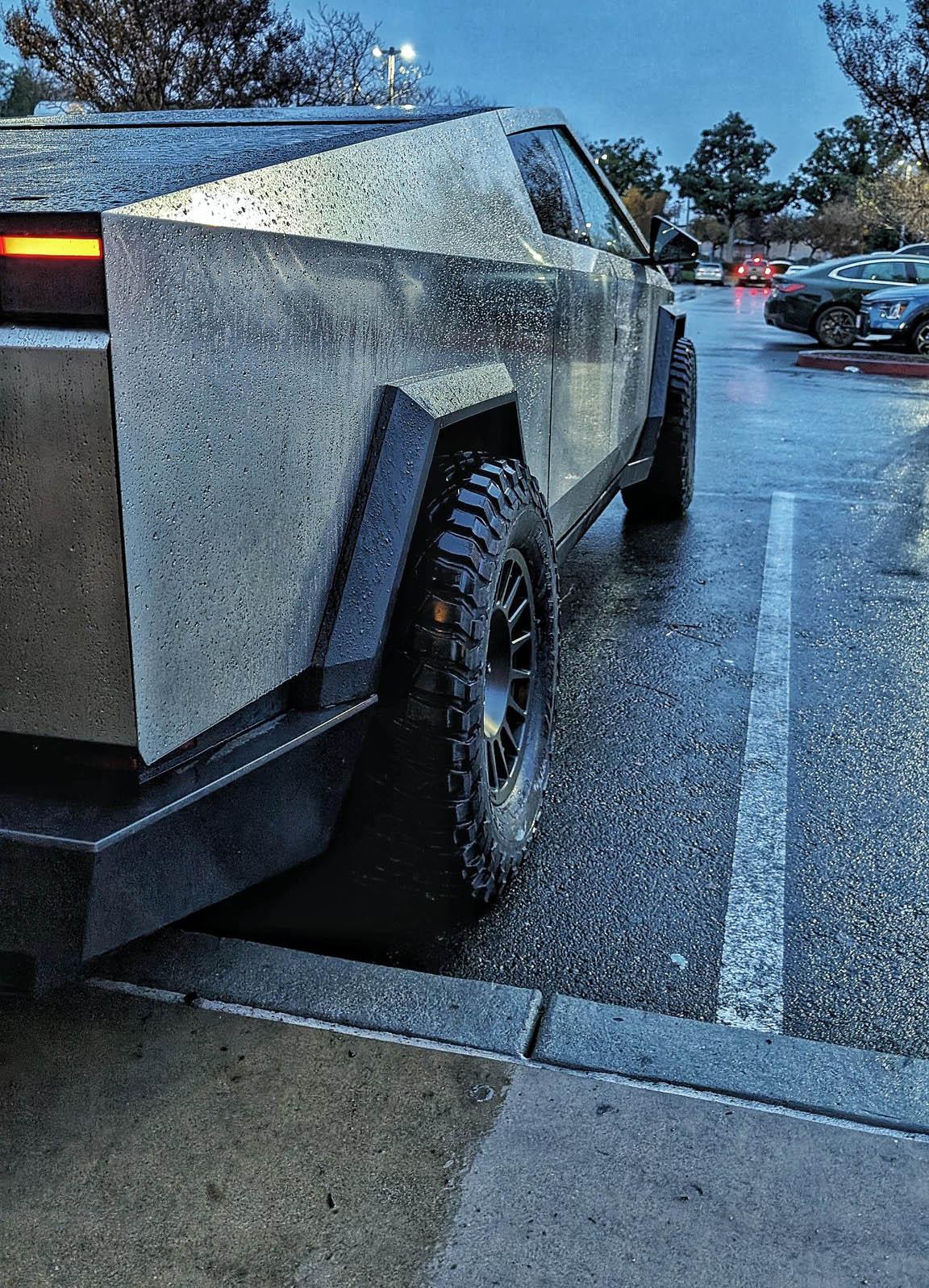

From the owner:
I've currently got 325 wide mud terrain tires installed with an aggressive back spacing which is significantly less efficient than stock (but looks amazing) and have seen ~460wh/mi over the last 150 miles.
Tesla Cybertruck Aftermarket 325 wide tires + 18" Method wheels installed on Cybertruck 325 wide tires 18%22 method wheels aftermarket Cybertruck 1

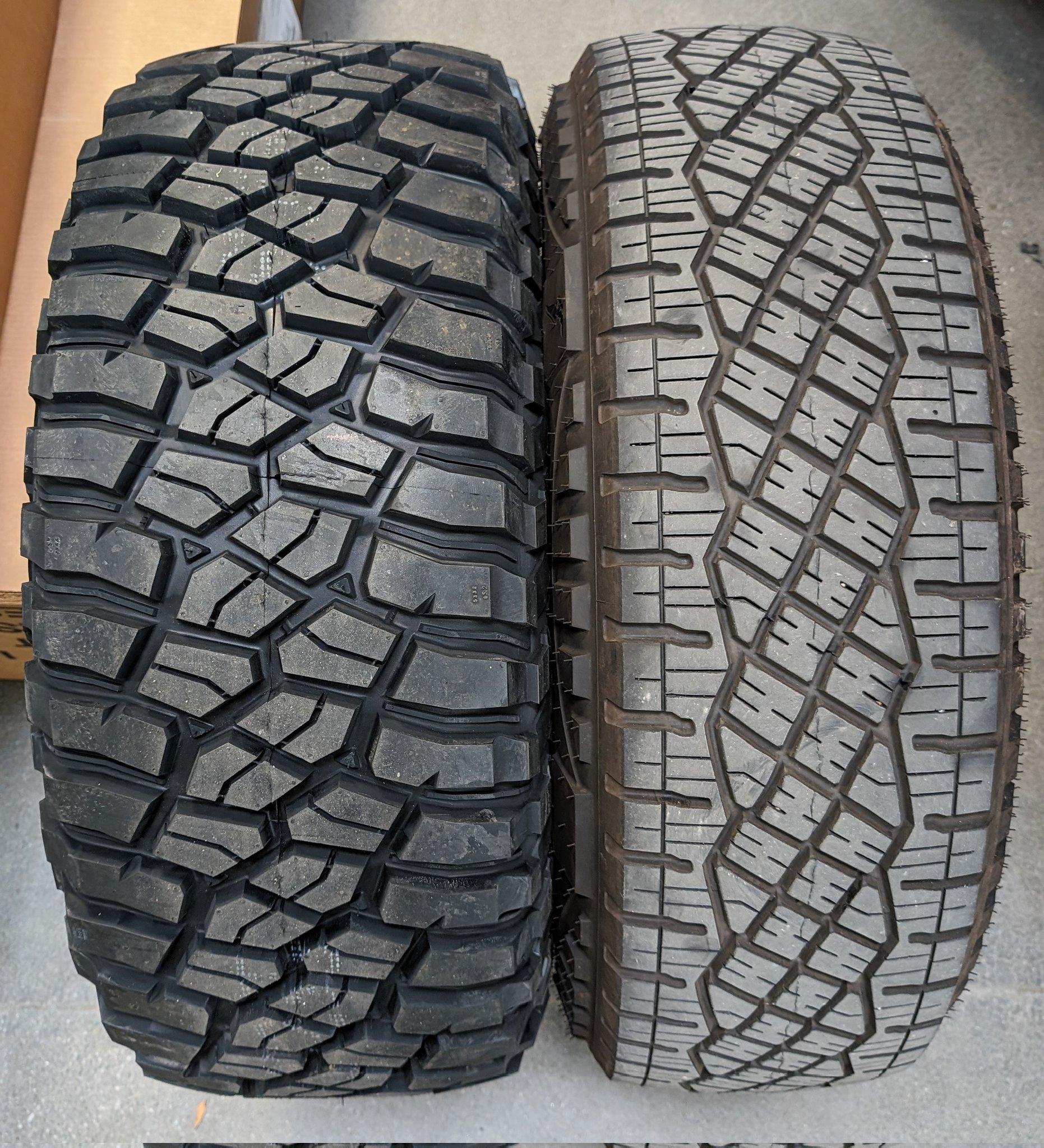

Compared to factory Cybertruck A/T tires:
Tesla Cybertruck Aftermarket 325 wide tires + 18" Method wheels installed on Cybertruck 325 wide tires 18%22 method wheels aftermarket Cybertruck 2

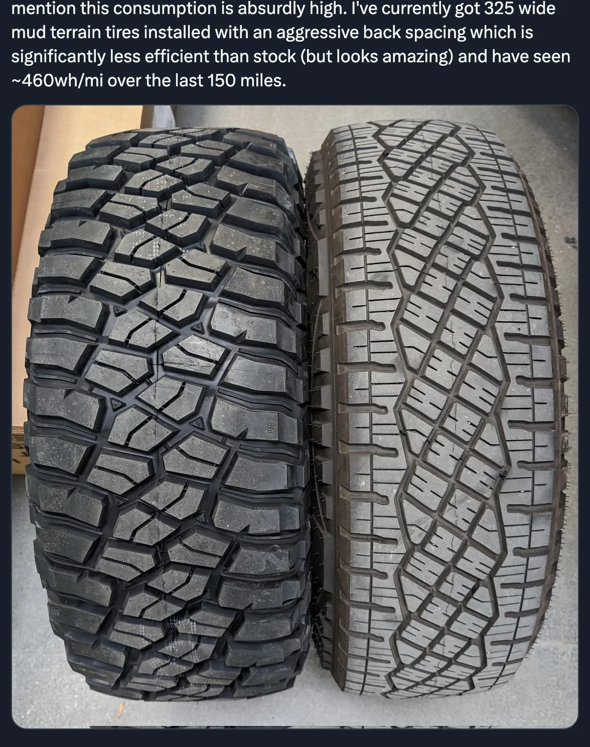

Tesla Cybertruck Aftermarket 325 wide tires + 18" Method wheels installed on Cybertruck Screenshot 2024-01-22 at 9.10.18 AM

Any idea how less efficient it is compared to stock tires?

You could have achieved the same “look” without as big of an efficiency hit if you’d go with a wider offset wheel, or even spacers, instead of such a wide tire. Less chance of rubbing too. Mud terrains on a street vehicle is not my first choice, even for an avid off-roader. A/T or hybrid terrain is the way to go from a daily driver standpoint.
With this setup, you’re taking a significant range hit due to increased rolling resistance from wider contact patch, taller lugs, and heavier tires, to name just a few. But yeah, it looks good!

Right but it’s possible he wasn’t going for looks. Maybe he just didn’t want to shred the crap out of those weak ass tires over rocks and boulders or take chunks of metal out of those ghetto 20 inch show wheels.? Idk ? Possible if he’s using it as an actually “truck” ?
I don’t know what has been your experience running the BFG km3 tires ? They’re not as loud as you would think and have way better coefficient of friction on road dirt mud or rocks. They bite in snow very easily and eject lots of water when rolling on the highway no problem with the lugs. Also, when you deflate with those bead locks at super low pressures, they deform very nicely and not symmetrically like some off-road tires helping you spread that rubber over rocks and such. But yeah, I don’t know what has been your experience with them?
