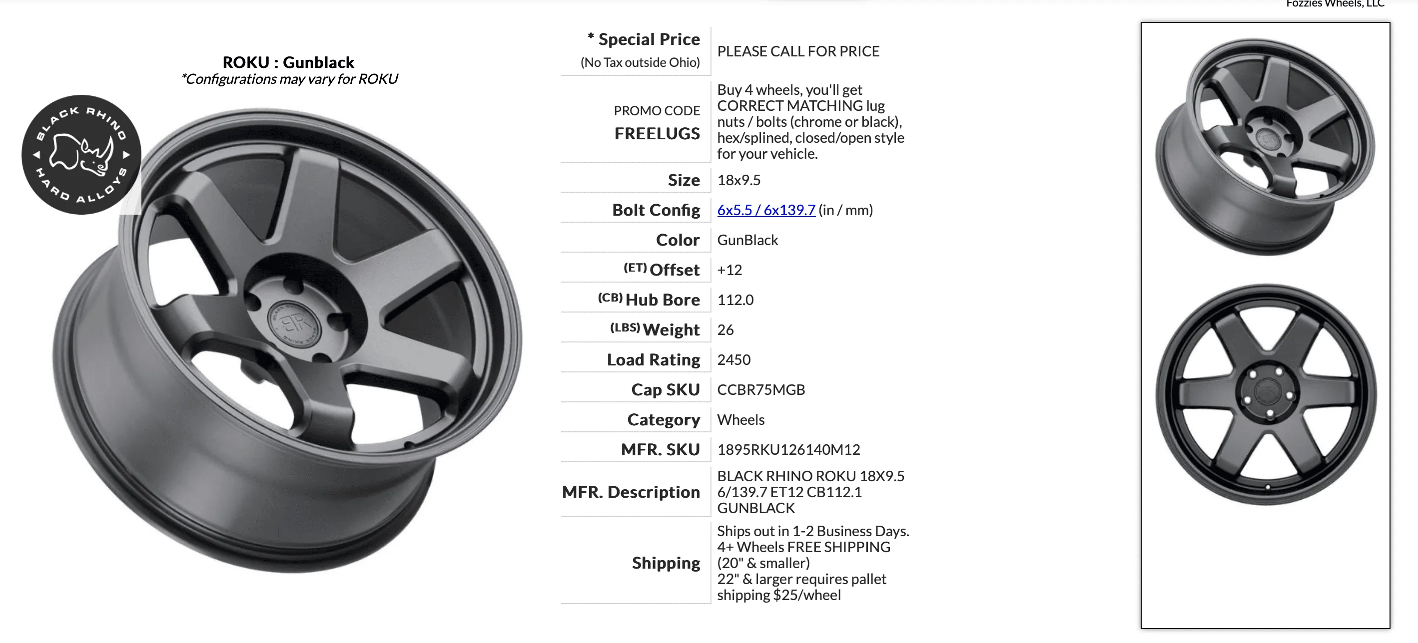

They also come in the Cybertruck's 6x5.5 bolt pattern with a +12 offset in 18s. Would love to see how these look on it.
these are clean! ....but CT needs a 2,620 load rated wheel.

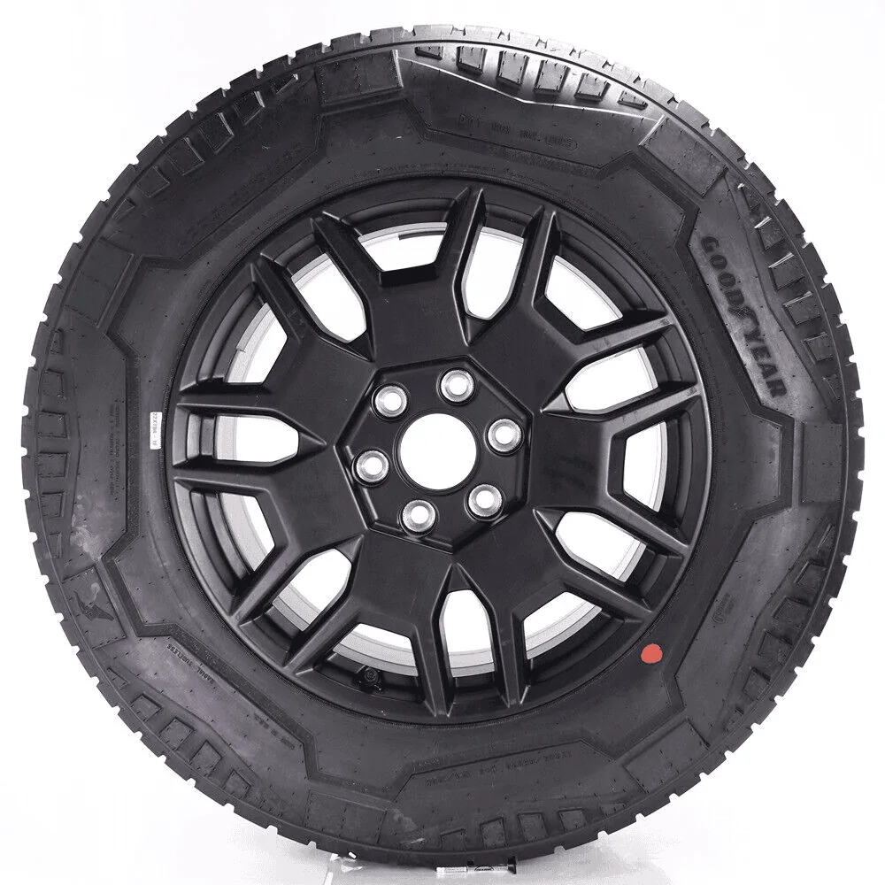

I don't see the load rating on the OEM Cybertruck wheels. This is taken off ebay.

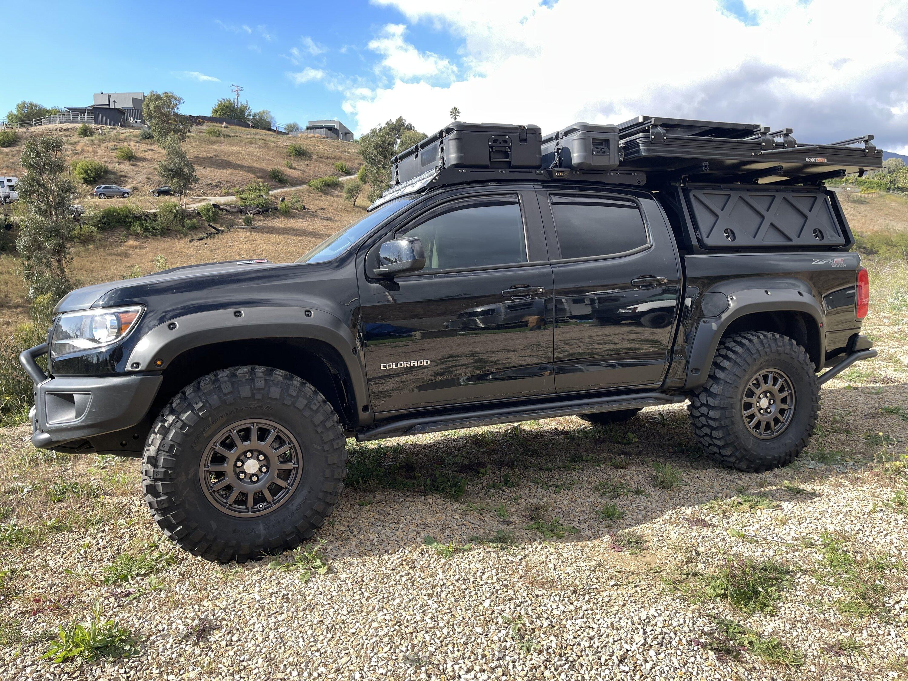

I just recently put 37s on my Chevy ZR-2, AEV Bison Edition, with no lift and no rubbing. Granted I did use AEV Highmark Fender Kit, which required a lot of cutting and added a “dished out” fender close out in the front.

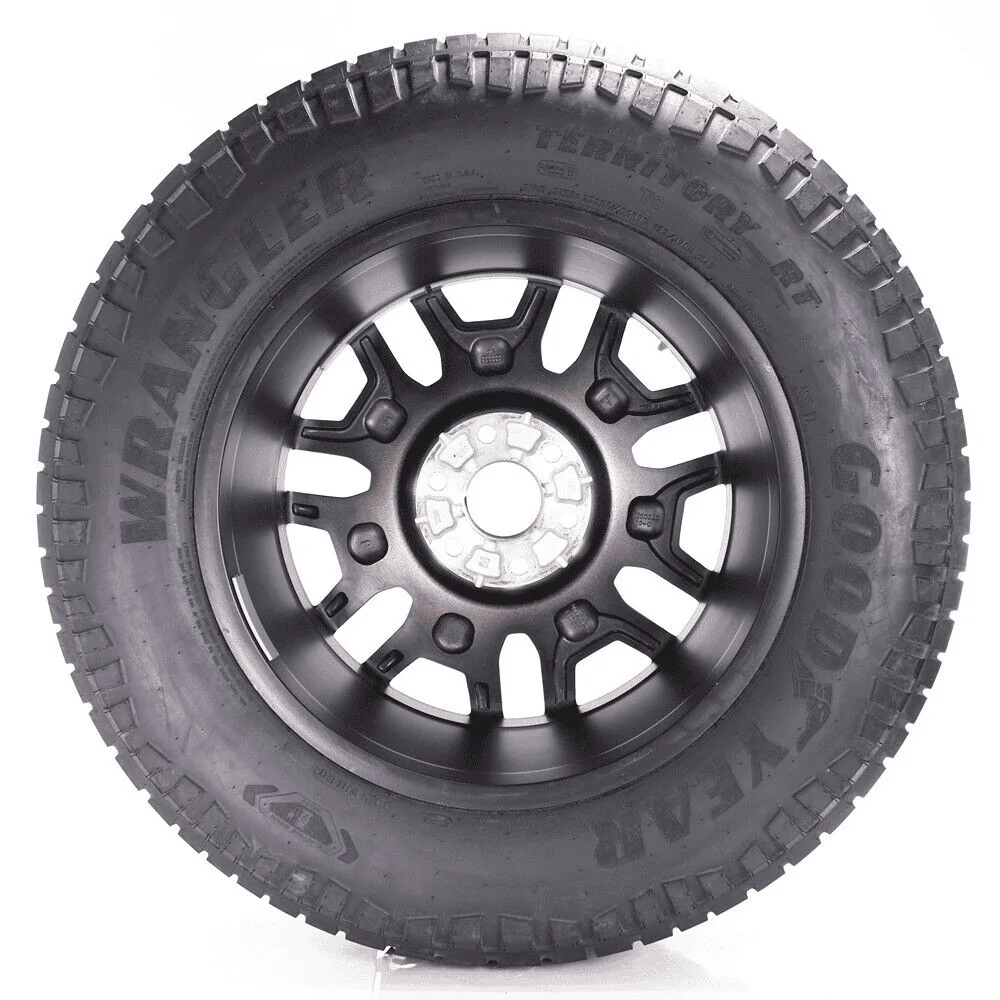

resolution too low. they're casted in the pockets.
rear Gross Axle Weight Rating is 2,380kg.
divide that by 2 = 1,190kg (2,618lbs).
so all these 18x9.0" wheels from the KMCs and Methods of the world are going to fall short of minimum load by a solid 118lbs.

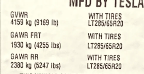

on my door sticker.....

Thanks for that. Exactly what I was looking for. That weight includes the additional max 2500lb payload, current aftermarket wheels are not in spec but should be work unless you are carrying very heavy loads. I'm a lifelong truck owner and haven't seen many aftermarket wheels past the 2500lb weight rating.
