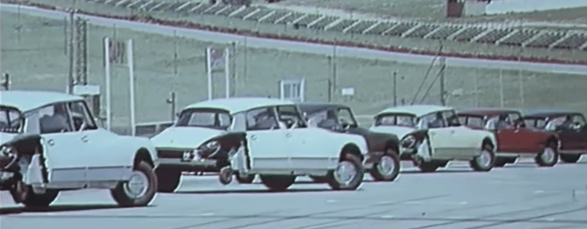

Here is a different way to do it: (i.e., this is not exactly what I had in mind, but this ~works)
Wheel change without a jack! Citroen C5 Hydractive III+ suspension
Wheel change without a jack! Citroen C5 Hydractive III+ suspension - YouTube
Have a read at this person's comments on this YouTube video above:
Stravos Kontos
3 years ago
I had Citroen cars with hydropneumatic suspension since 1975. (GS, BX, Xantia I & Xantia II Activa and a C5 now). All those suspensions could do that kind of tire change and they could all be driven with three wheels only, as long as you had one of the back wheels out. The most amazing of all was the DS, CX and GS, where the jack (more like a fixed height tower) was fitted in the middle of the side. Those cars were so well balanced that if you had a flat at the front and put the jack, the car would lean its back side and raise the front so you could change the tire easily and vice versa. Once you put the spare on it would come to the center again. It was so well balanced that the air's weight would make a difference!
