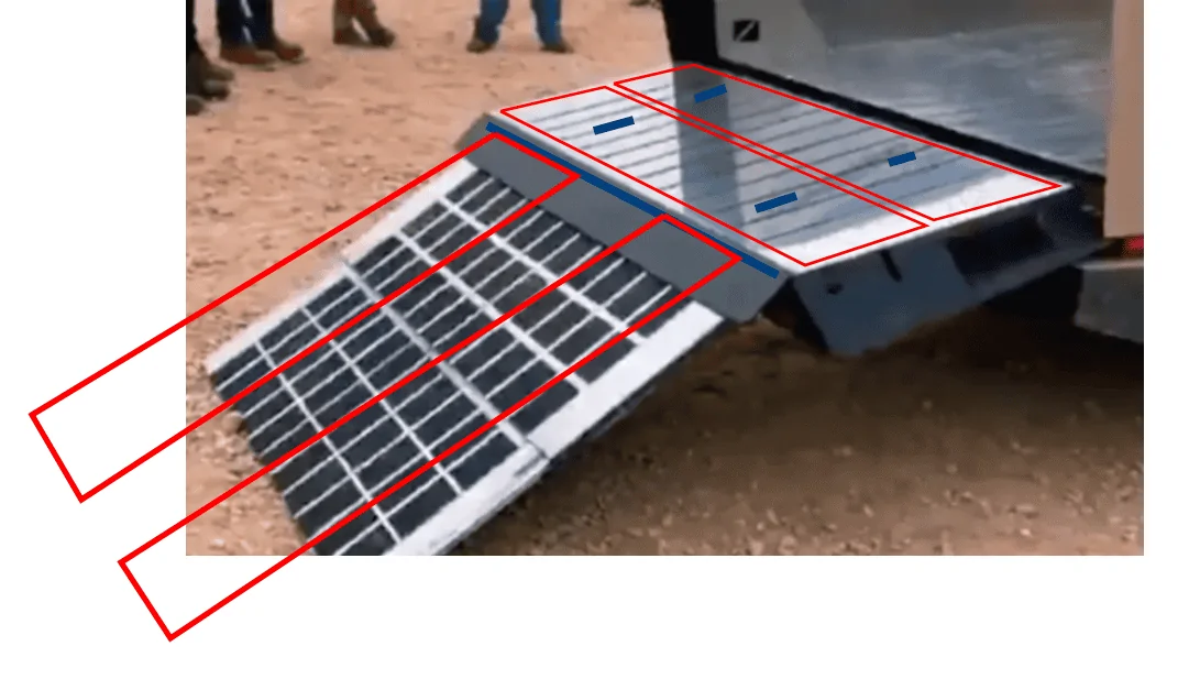

Personally I think Tesla is going to fight like hell to keep the CT close to performance and prices at reveal. That said some of the features are proving to be challenge at the price point. The tonneau, wiper, and tailgate, got just a little more complicated in the real world.
The telescoping tailgate will have some of the same problems as the tonneau with dirt, ice, and maybe just heavy. If you dent anything on the telescoping mechanism it will probably need to be replaced. You have to worry about dirt and moisture accumulating in the bottom of the tailgate if you close the ramp wet or muddy.
Basically what I propose is to make the tailgate like a waffle slab. Then have removable ramps nestled in the voids. Use the hand holds with a latching mechanism to remove them from the tailgate and place them on bar with the width of your quad or whatever.
This would be lighter, cheaper, stronger (more depth to work with) less prone to gumming, if you damage a ramp you simply order a new one. Everything is sealed with the only moving part being the latch in the handholds. KISS
Elon, I will take one quad motor CT for my napkin brainfart engineering services.

i like this because I can pull them off and stash them in the vault basement and don’t have to lift them every time I open or close the vault.
