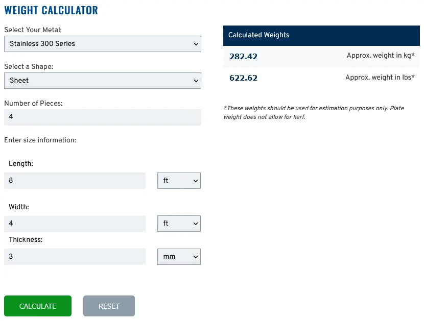

I don't think his weight FUD points are totally valid either, even though it's always preferable to reduce weight whenever possible. Of course we don't know the actual weight of the BIW or Stainless Steel portions, but I'd estimate the 3mm thickness sections would be roughly equivalent to the area of four each 4 by 8 foot sheets 3mm thick. I know the stainless likely comes in different dimensions from that, but this is just using a familiar representative example of surface area. Actually I think it's a little generous as the CT surface area of 3mm stainless is likely a bit less. But using that surface area for sheet stainless 3mm thick, and a Metal Weight Calculator from TW Metals, we get the following:

https://www.twmetals.com/resources/calculators.html
I don't think 622 lbs is a range killing weight for the stainless steel at all, because any body skin material is going to have to weigh something. Even if the material is reduced to half thickness, that's only 311 lbs of saved weight, which is a tangible difference, but not a major one, considering what the overall weight of the Cybertruck will be. We should remember the skin weight is likely less anyway as the estimates above were being generous.

Poorly written article with no base in facts. The CT SS skin weighs around 280kg (600lbs) in 3mm thickness, 185kg (400lbs) in 2mm. It's less than 8% of the likely vehicle mass, and mass has only about a quarter of the drag impact at highway speeds.

For example making the CT SS body "bulletproof" but not the glass, is not really that useful overall for making an armoured vehicle, whereas making a paintless durable exterior covering is. Now 1-1.5mm thickness will likely be just as durable as 3mm thickness in 95% of impacts, at some point 3mm will only be useful if the underlying structure can also support the impact.
This only demonstrates the amount of compromise that is required to optimise the design to the point that it still retains the "right" amount of feature for the amount of resource used to make the part.
This applies to the manufacturing process as well as to the product itself though, especially in high capex and very automated manufacturing.Deleting a paint shop in the manufacturing process, even if you produce a somewhat heavier project, but at lower overall cost per unit, is of course a no brainer, regardless of if the range is reduced.
In this context range must also under go a sensitivity analysis, in that it is also a function of battery capacity. If you have cheap battery production, you essentially can use that to more than offset the range deficit by using the savings of the paintshop, and still end up with a cheaper, higher performing product.
It sounds silly, but the paint alone, of around 2 gallons plus primer and clear coat, will cost more ($1k) than the SS panels of the CT costing $900 just for materials alone. Given that paint is not structural in any way for crash or impact protection and ingress, it's a no brainer which way this compromise falls.
