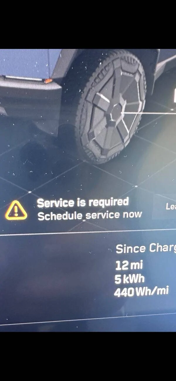

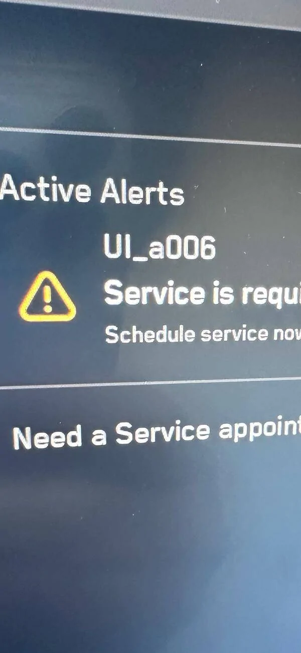

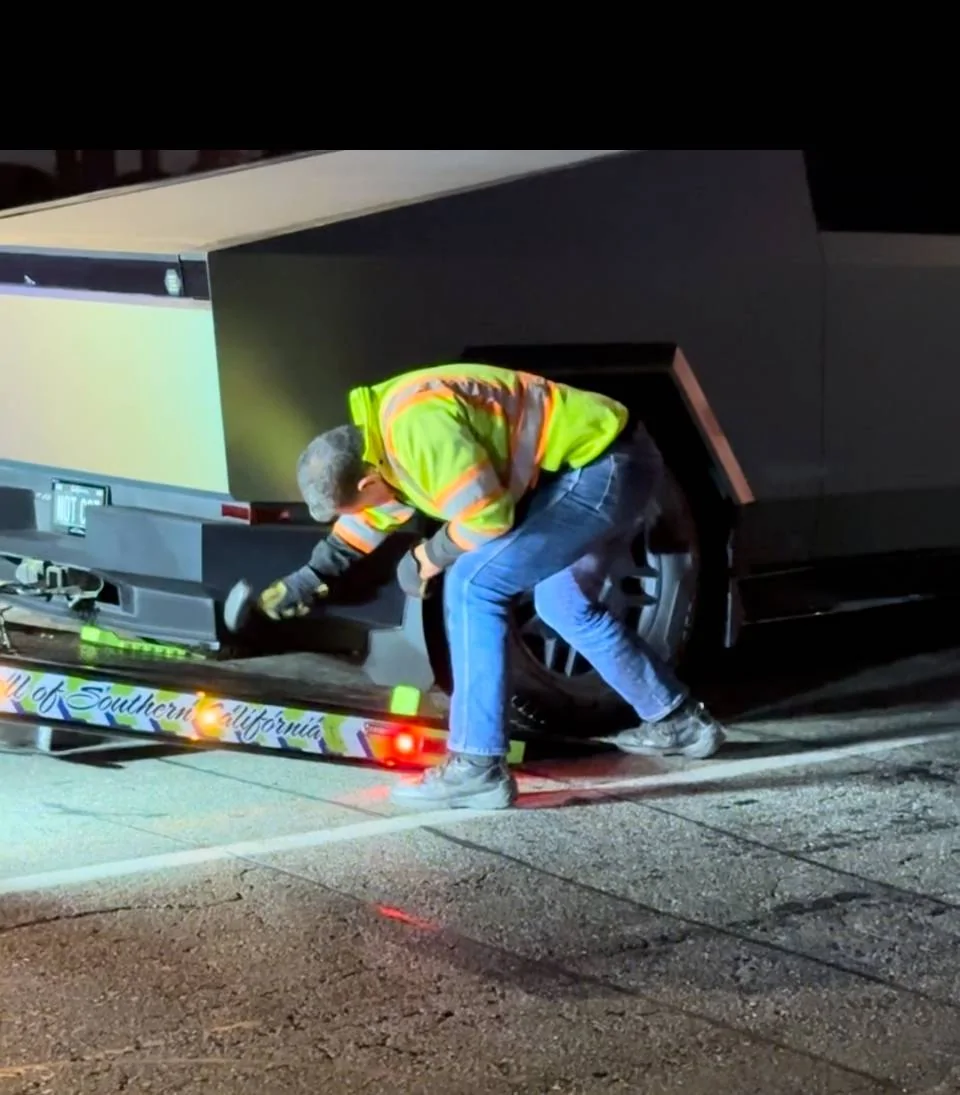

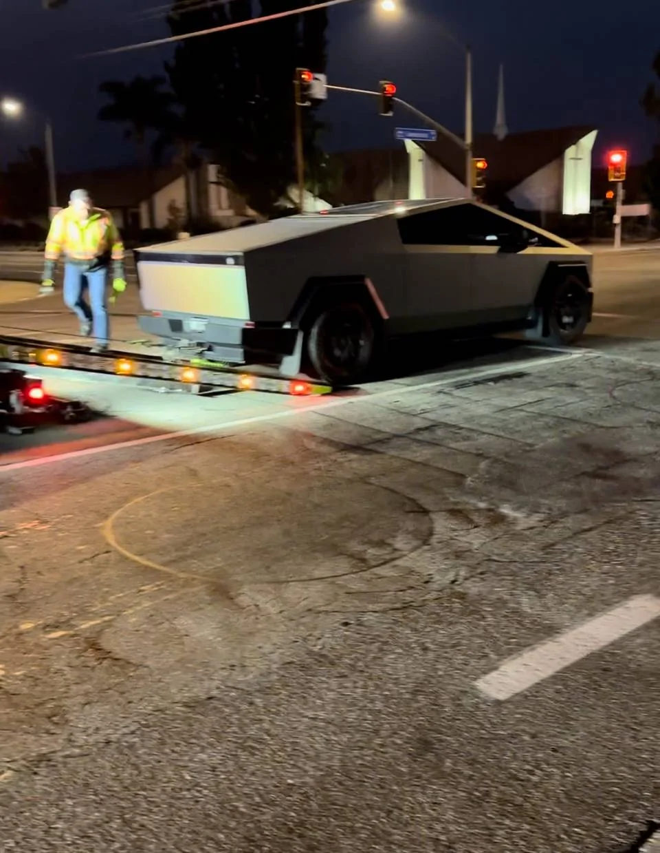

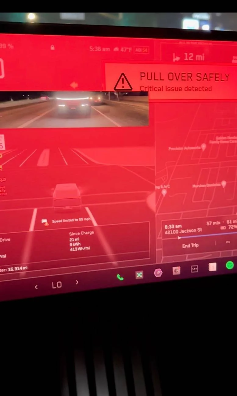

Might be helpful and might just save your life…read on…2 days ago, truck alerts for required service (code UI_a006). Code didn’t provide much info and all i could do was schedule a service appointment (which was 2 weeks out). Continued to drive the truck and approximately 18 miles later, boom, the pyro fuse for the rear inverter blows sending the truck in a hard jerk. The truck immediately stopped and would not move. This was extremely dangerous, as I was in the fast lane of a 45mph road at 5:30am (still dark). After trying to get the truck to respond it decided to simply shutdown and become unresponsive (even killing the hazard lights). I had to get out using the manual door handle override and get to the side of the street and watch car after car almost rear end the truck. Rounded up some traffic cones, threw a flashlight out on them and continued to hope to avoid disaster. Tow truck finally arrived 25 minutes later and had to snatch the truck from the lane of traffic and we were on our way to the SC. Of course the SC said this has become super common on these CTs and they would have it fixed within a few days. We will see… So, if you have a dual motor and have yet to experience this, carry flashlights, flares, or something in case this happens at night to you. This one was tough because i was not allowed to use the front motor to drive it at limited speeds which has been widely reported.
