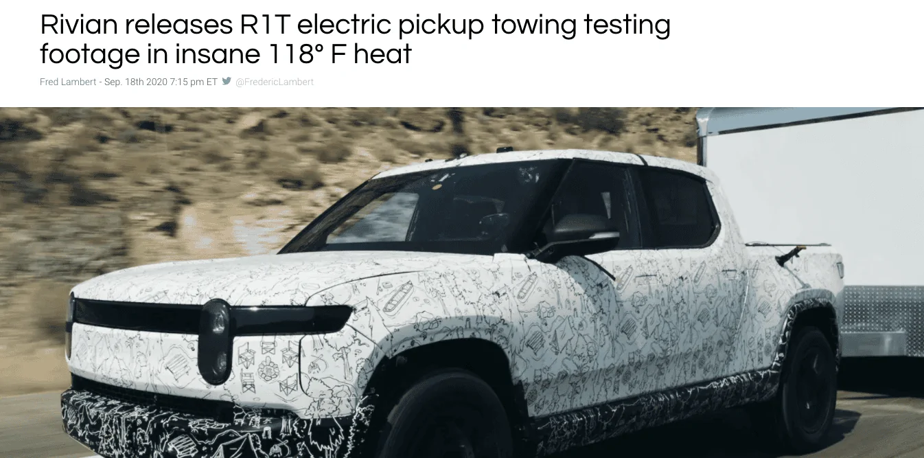

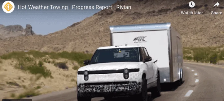

Rivian has released a video of the towing testing for its upcoming R1T electric pickup in some insane 118º F heat.
We are seeing a trend lately of companies planning pickup trucks showing the capacity of their trucks as the race to bring the first electric pickup to market heats up.
Yesterday, Ford released testing footage of its F-150 electric pickup prototype and a day before that, GM unveiled footage of its Hummer EV electric pickup testing its ‘Crab Mode’ feature.
These electric vehicles are still a year away, but automakers are working hard to validate them and bring to production.
Now Rivian, who is also trying to bring to market an electric truck on the same timeline, released a new video of its team testing the towing capacity of its R1T electric pickup truck in some insane heat:

It's cool to see them testing but this info was hardly relevant to what we need to know in the real world.
For example they state that they easily exceeded their (ridiculously low) "maintain 40MPH" up a grade. But they didnt say by how much or what speed they were able to maintain. I'd HOPE they were able to maintain at least 60MPH.
Also it doesnt really say how much range was reduced by towing or under what conditions. They said it was about 50%. But it's really important to know what flat towing vs hill towing does to range. If hill towing crushes a battery by 80% then that's really really bad. Whereas if flat towing only reduces range by 20%, that's hardly a dent. Or did they see that 50% reduced battery range consistently regardless of terrain type? All this scenarios require different evaluations on vehicle capability
I saw this video and I immediately thought that I would love to see this kinda stuff regarding the Cybertruck. I know that Rivian is a bit further in development and this really helps their case, but it would be nice to see the CT in videos like this. Unfortunately as we've seen with preorders, Tesla doesn't have to market like this. So I wouldn't hold my breath for a Tesla Cybertruck video like this even though it would totally scramble my eggs...
