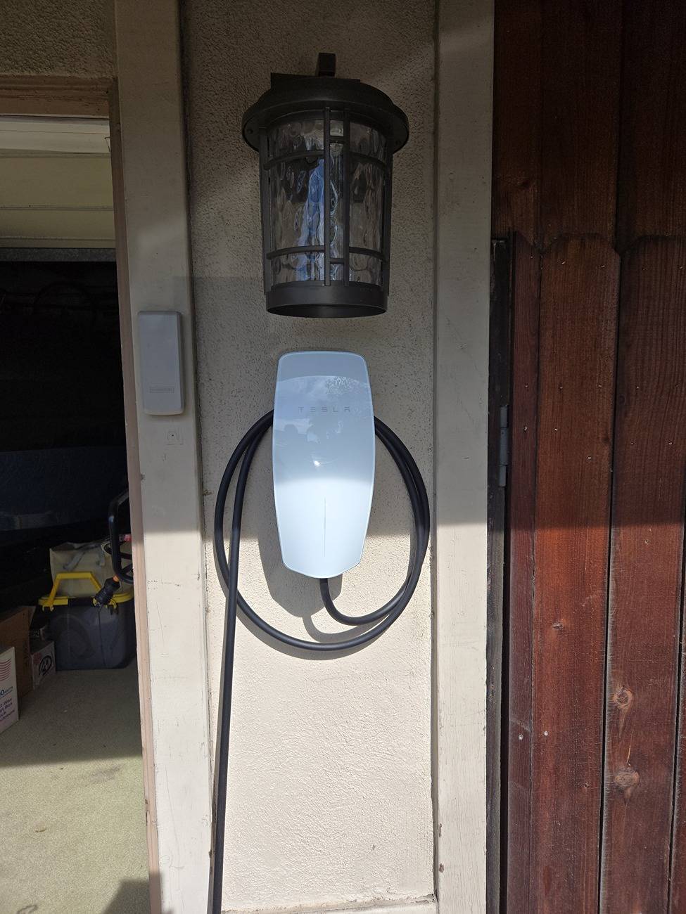

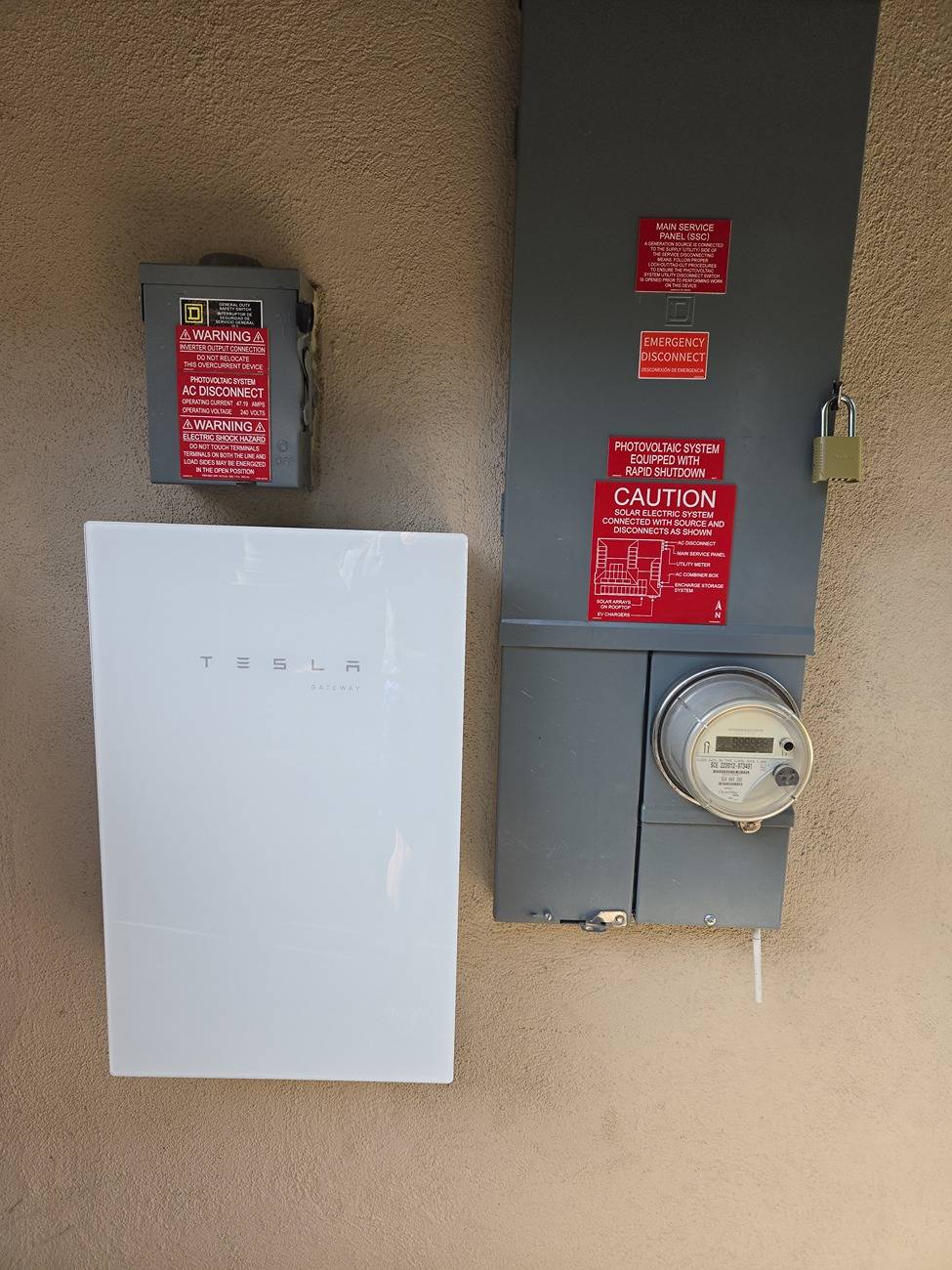

I got mine installed about 4 months after receiving my Cyberbeast, with no visible external conduits, gateway surface mounted next to electrical panel, my main electrical panel was converted into a subpanel that backs-up the entire house, the gateway is now considered to be the main electrical panel, Universal wall charger was installed about 30 feet away from gateway, on the outside corner of my garage which accommodates charging an EV from 5 different, surrounding parking spots including 2 spots inside the garage, all for $155.00 out of pocket not including the original price of my beast of course.

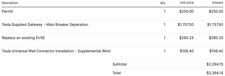

My Powershare installation was $2,394. Was an AWD, so no credit, but that shouldn't change the job. In my favor, I had my wall connector installed previously in my 2nd garage (75' run) so it was only $280 to replace that. The supplemental work was moving a single 20A circuit (my fridge) from my 2nd panel to the one being backed up.
The job took 2 people most of the day. New lines from the meter to the gateway, lines from the gateway to the main panel, separation of all grounds and neutrals in the main panel (it's a sub-panel now). Installer provided the 200A main disconnect breaker for the gateway and a new 60A breaker for the wall connector. Gateway uses Eaton breakers, so couldn't reuse my SquareD. They used copper wire, so they were obviously making enough profit on the job that they weren't motivated to go with much cheaper (but harder to work with) aluminum. All told, I'd estimate $500 or so in installer provided materials. It required a meter pull by the utility and clean inspection to get it turned back on by the end of the day, so I'm content paying a premium.
