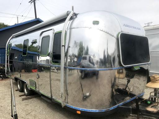

Polishing stainless steel to a mirror like finish takes some effort, even more so than aluminum because it's a harder metal. A small Airstream travel trailer will take roughly 200 hours of labor. Anyone plan on going this route instead of a custom wrap?

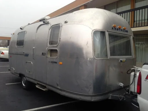

Polishing an Airstream would be more work than the CT.
3mm stainless steel wont warp much, if at all, while cutting and polishing, unlike the Airstream.
I'd sand with 400 grit, then again with 600, then "cut & color" with Airway pads, rouge, and a 6000 rpm variable speed buffer. I'll bet a pro could do the CT in 40 to 50 hours.
