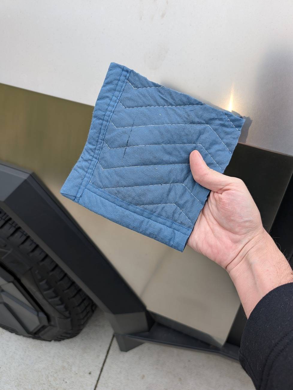

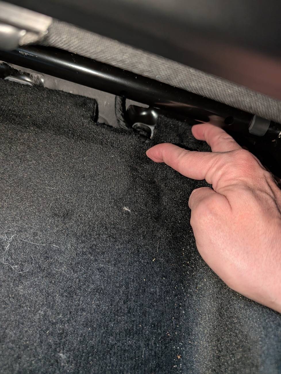

I found the rattle is coming from the carpet panel, which has a hard plastic backing. It rattles against something hard behind it. I cut a piece of a furniture pad, and stuffed in between the carpet backing and whatever was behind. The rattle is 100% gone.

Yes, all I did was put a piece of 3M double-sided tape on the flap right around it. Just put a tiny piece of tape when you have the music turned up and you will know exactly where it’s coming from.

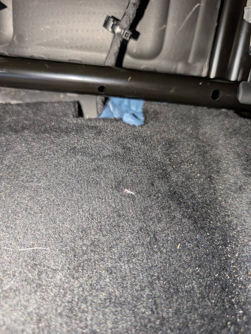

Does this help? It's under the passenger side seat. The blue cloth is a bit of furniture moving pad I shoved in. Works excellent even with bass and volume at 100%
Ah, that’s great, thank you!
I thought it was below the rear seats. Good to know it’s under the front passenger seat.

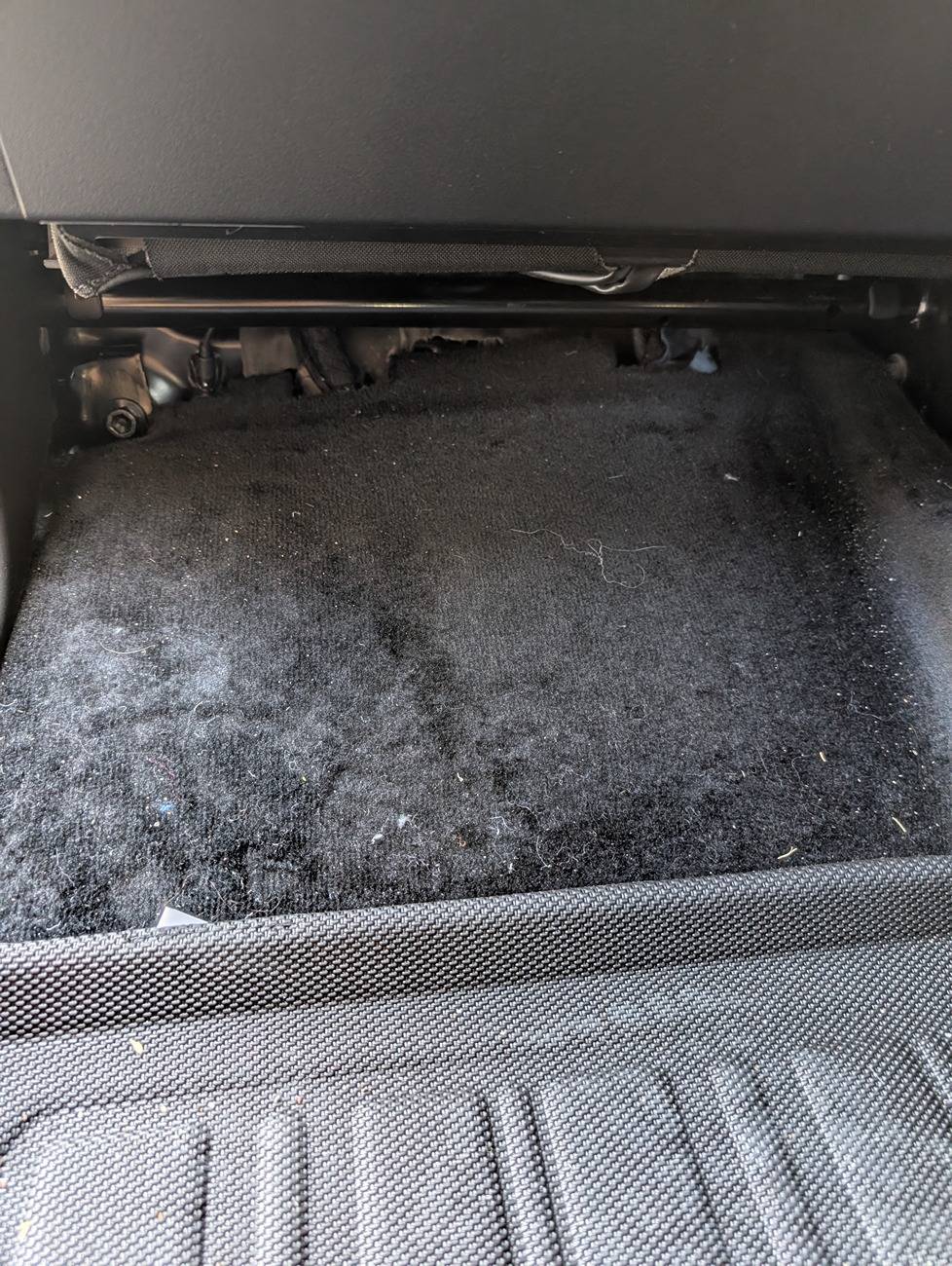

Ah I should have specified, it is the rear passenger seat. The seat is folded up in this picture.

It is below the rear seat. Very obvious once you flip the seat up. And it 100% eliminates the vibration.
