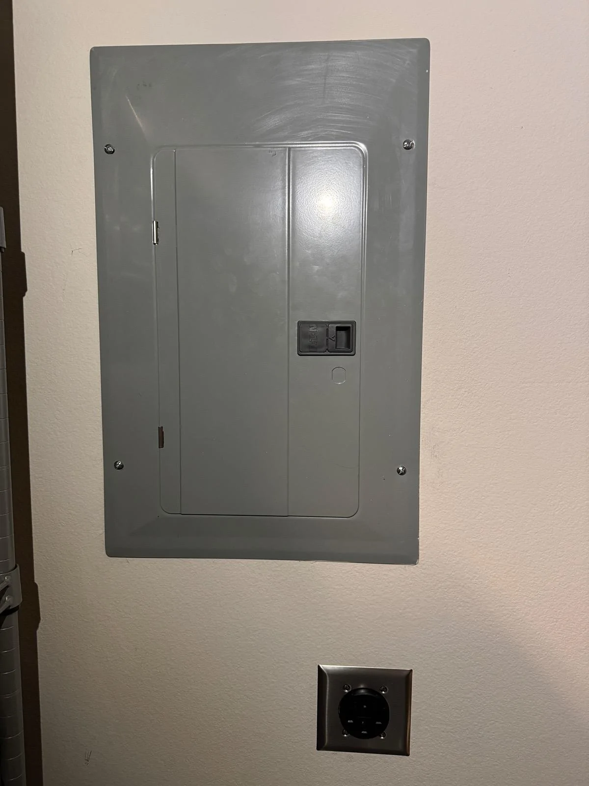

My sister's Benz has Free charge but I want to have an outlet to charge my CT when visiting her. What parts do I need and considered good brand name to have one at her house about 10' from her main panel?

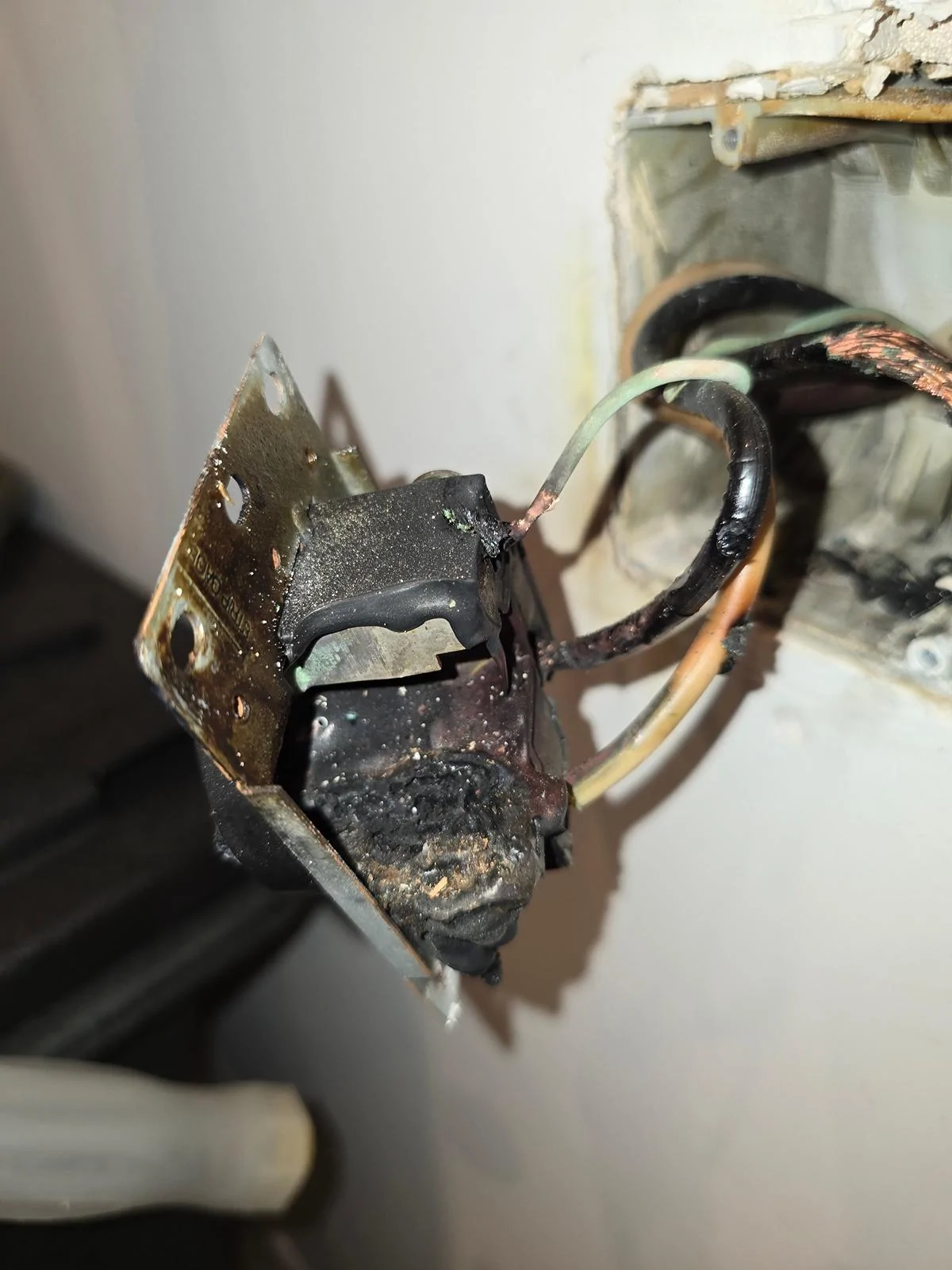

Do not use the cheap $15 Leviton outlets from Home Depot. It could have burned down my house after using it to charge the CT. It's rated for 50amps, I only used it for 30amps and it burned up after months of use.
I bought the $50 Hubbell Lighting HBL9450A to replace it based on a recommendation.
Agree with Pops on this one. I did some research myself and Hubbell 9450A is what you want to go with. I recently installed it using 6 gauge wiring going to a 50A breaker. Of course this is if you are going NEMA 14-50 instead of Wall Connector or Universal Wall Connector.
