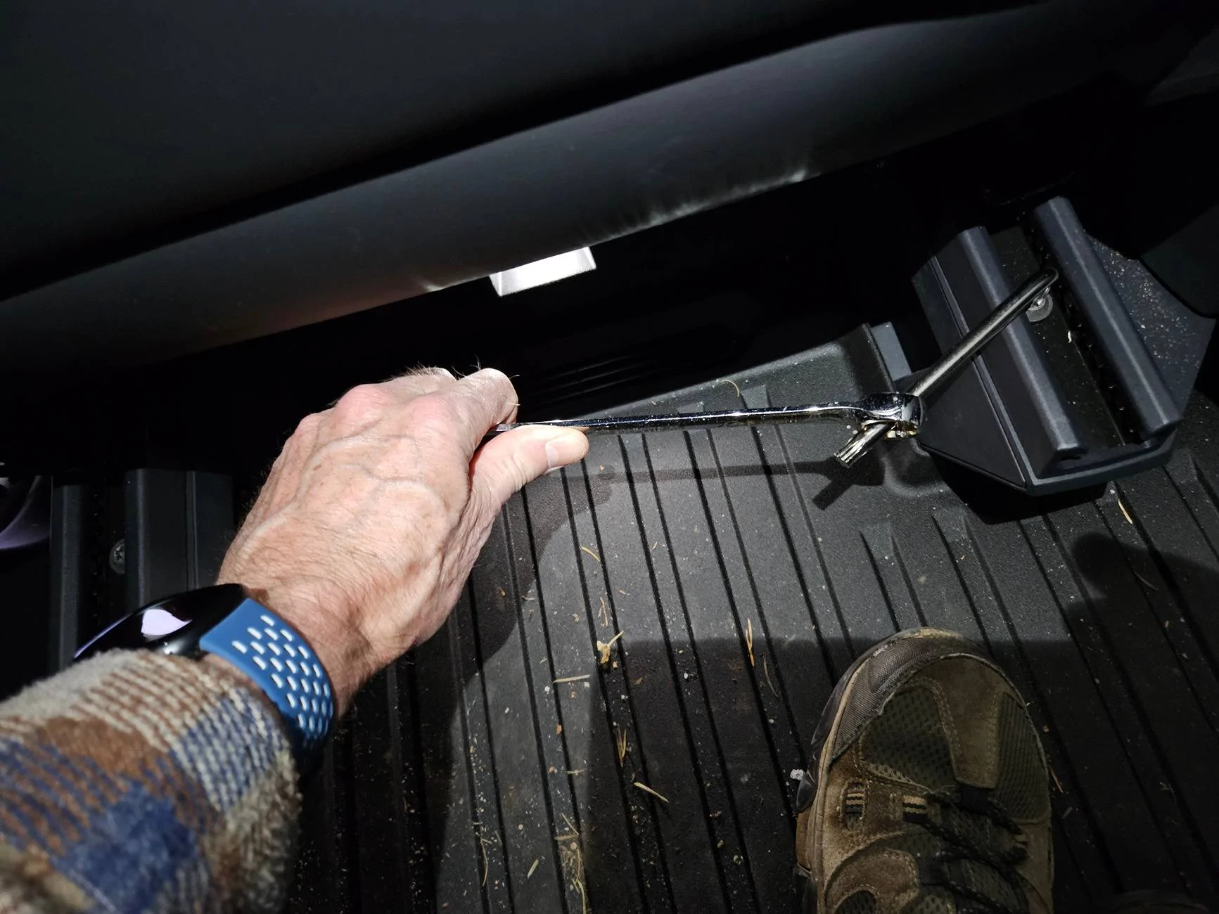

I installed mine today. I really like it. Very easy to access while sitting in the Driver's seat.
As for installation goes, it's pretty simple to do, if you're comfortable using wrenches. Others have commented that the included T45 Wrench is difficult to use. I had no problem, because I used a box end Wrench (17mm)
Tesla Cybertruck BestEvMod - Front Under Seat Drawer Safe for Cybertruck 1000066390
to act as a cheater bar to get each screw loose (see picture). after a 1/2 turn the Wrench was fine by itself. The whole install took 40 minutes. And another 5-10 minutes to set my fingerprints.

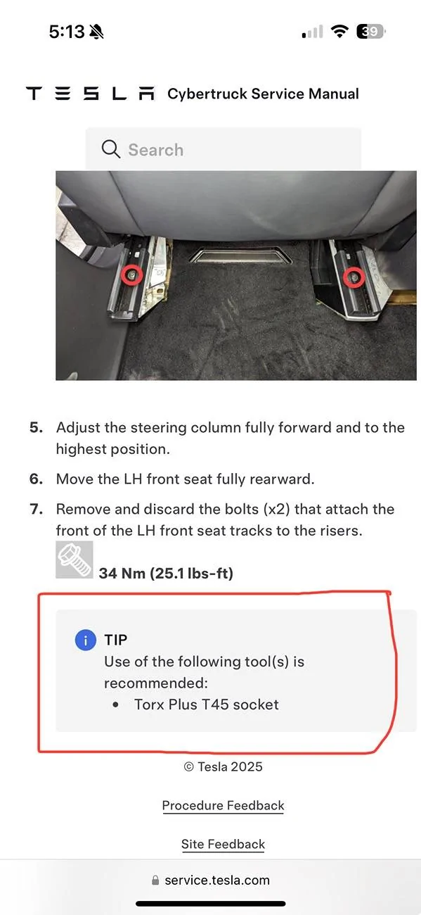

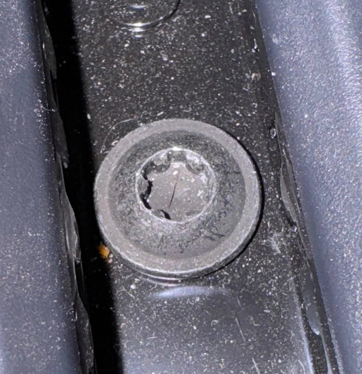

I tried to start install today and couldn’t even begin to get the bolts off. I noticed they send a T45 wrench. The Bolts on the truck are actually TP45 (Torx Plus). I confirmed this in the service manual. The T45 was striping out, so I stopped trying. They need to send a TP45 with this kit at a minimum. Or point out you have to buy your own TP45 wrench / socket

It’s definitely a TP45. I bet if your bolts were not torqued down as much, the T45 would work, even though it’s not a precise fit. my bolts seem to be very firmly in place. I will need a correct socket and a longer arm to break it free.

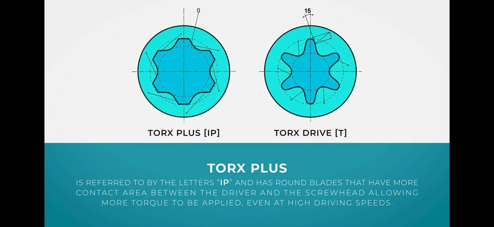

Here is the difference below and picture of my seat bolt. I believe the Torx Plus is used because it works even better with impact wrenches.
