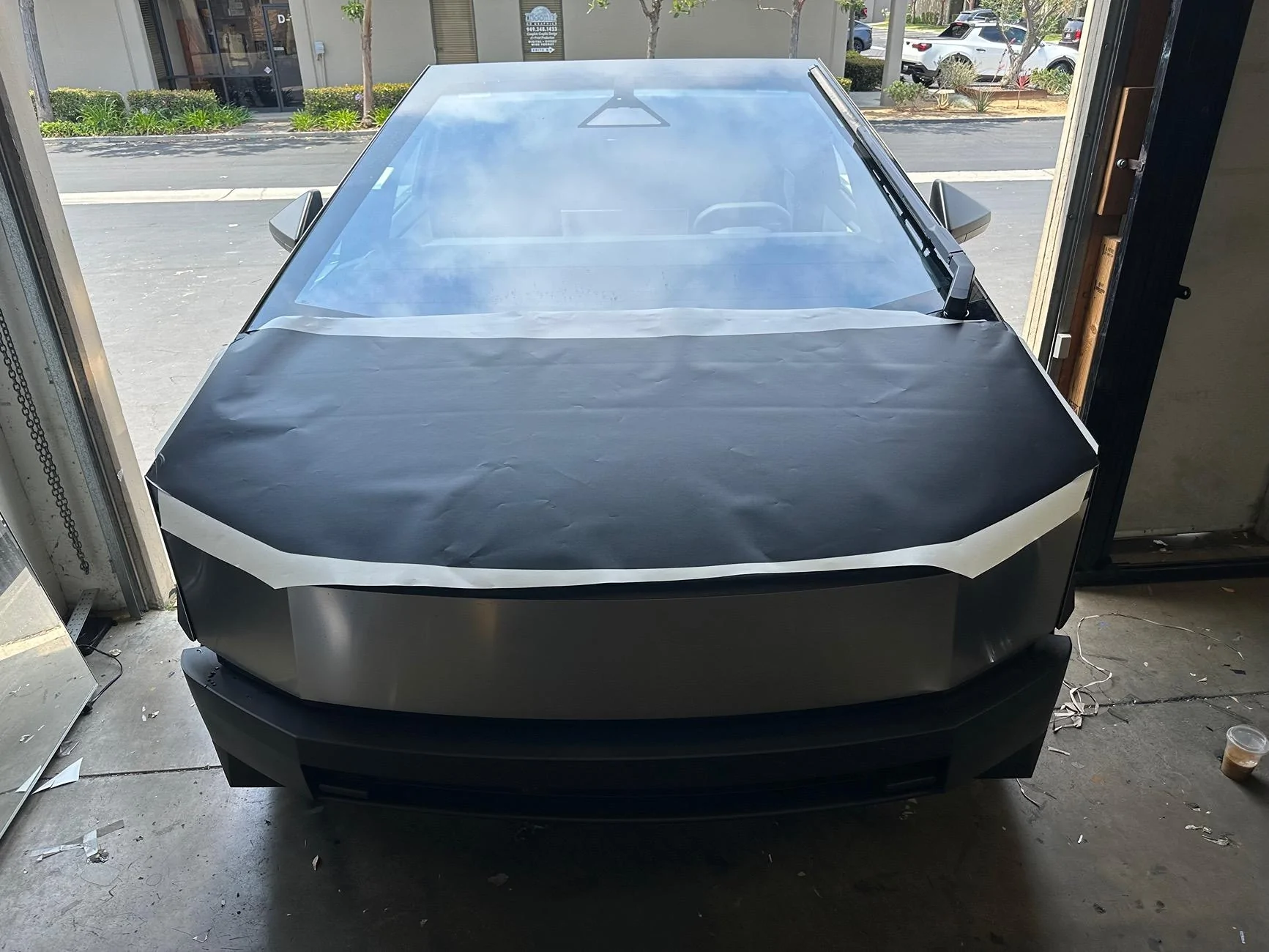

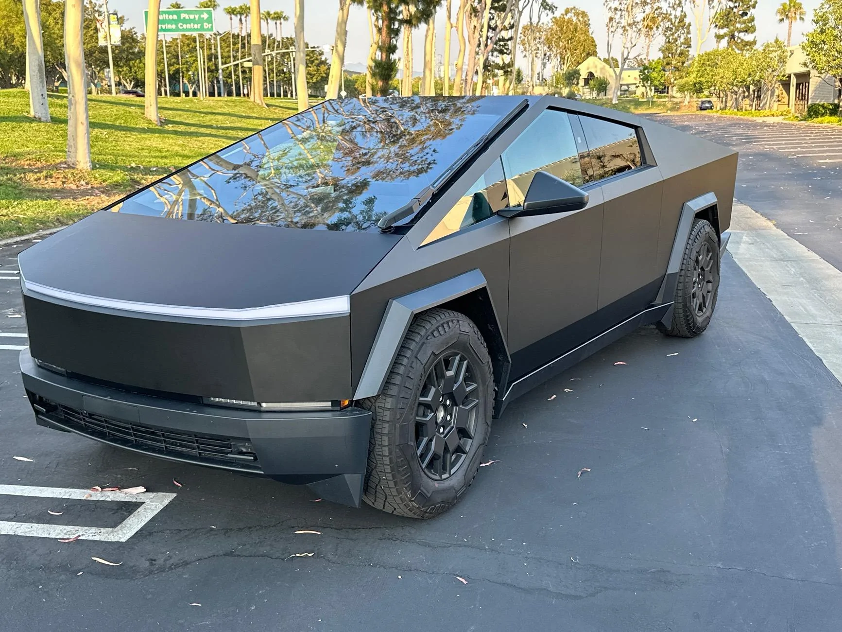

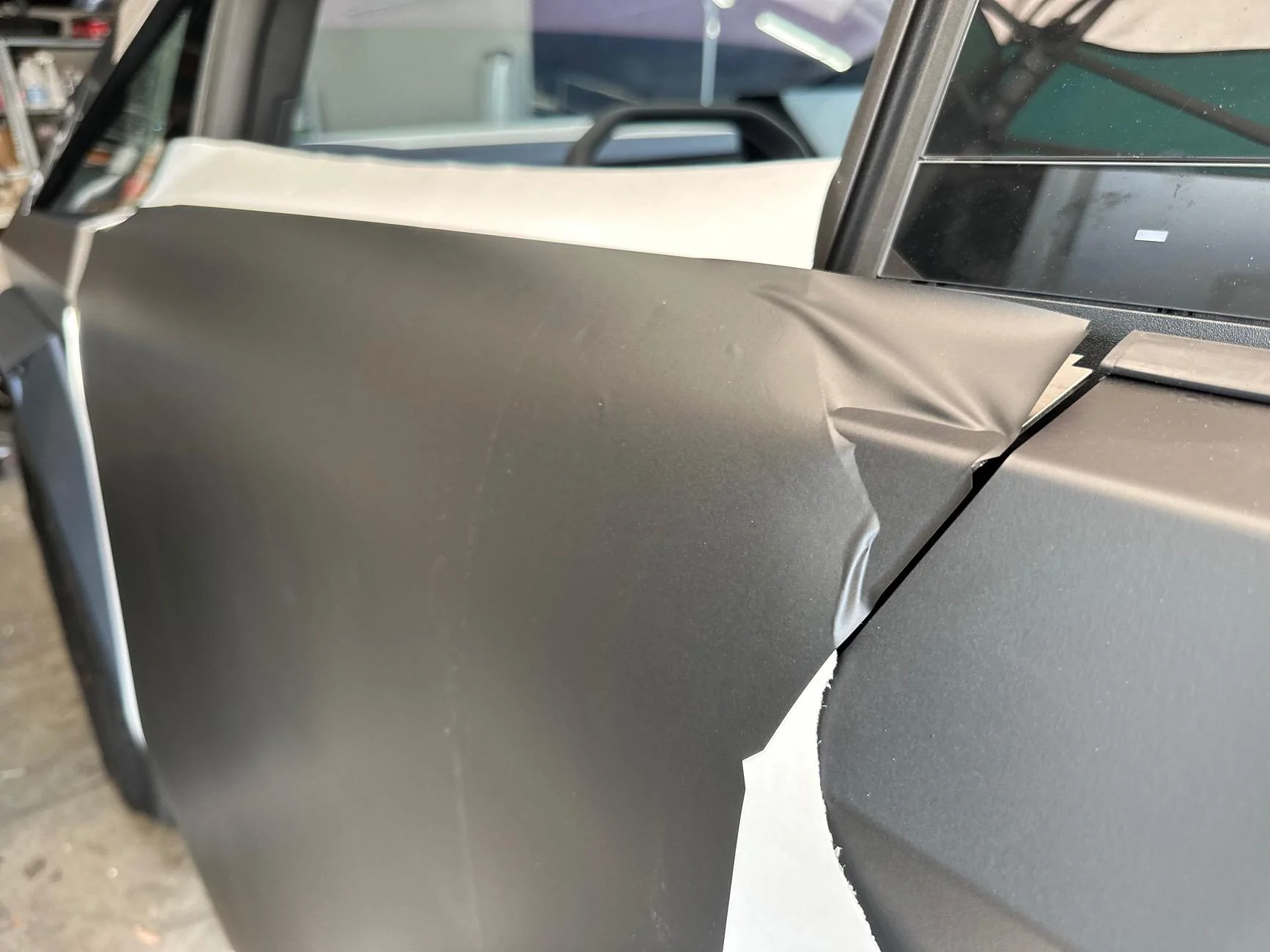

Decided on matte black Avery Dennison, Beyond Slick in-house developed patterns, did not remove the base of the fender flares, just the cover. It is approx 0.25inches in regardless. Did it at my warehouse in Orange County.
Took me 6.5 hours after prep. What are your thoughts?

Nice job!!! Looks good. Saved a bunch of cash too!

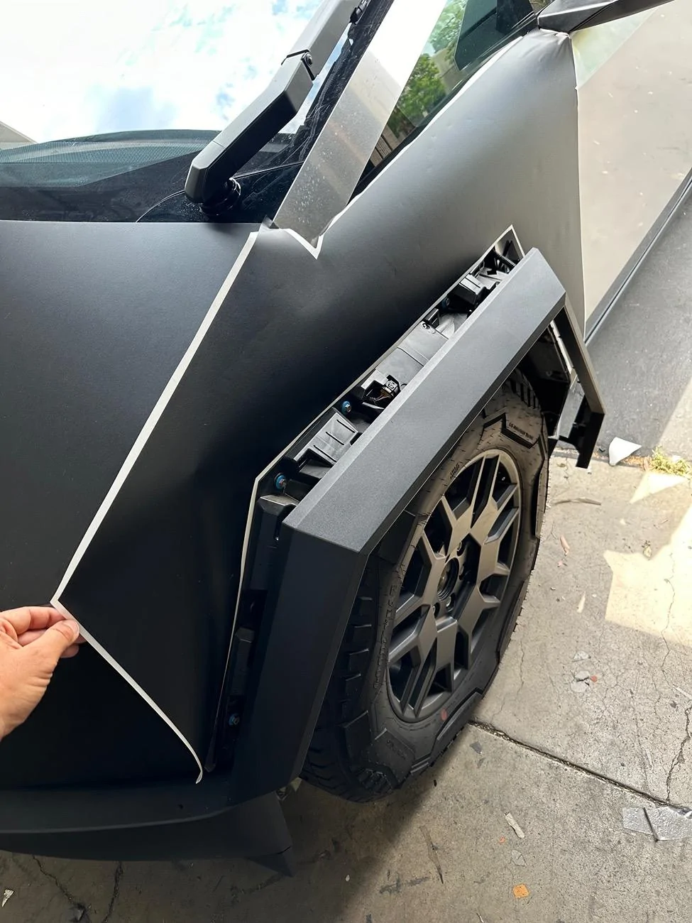

How did you handle the fenders with the cameras in them? That is my slight worry.. especially with calibration

How did you do those fenders with the cameras? Did you unplug the camera? I’m worried it will cause calibration issues
I have detached the outter cover and taped it down so it doesn't fall/move. Camera harness is long enough that it doesn't necessarily needs removal
