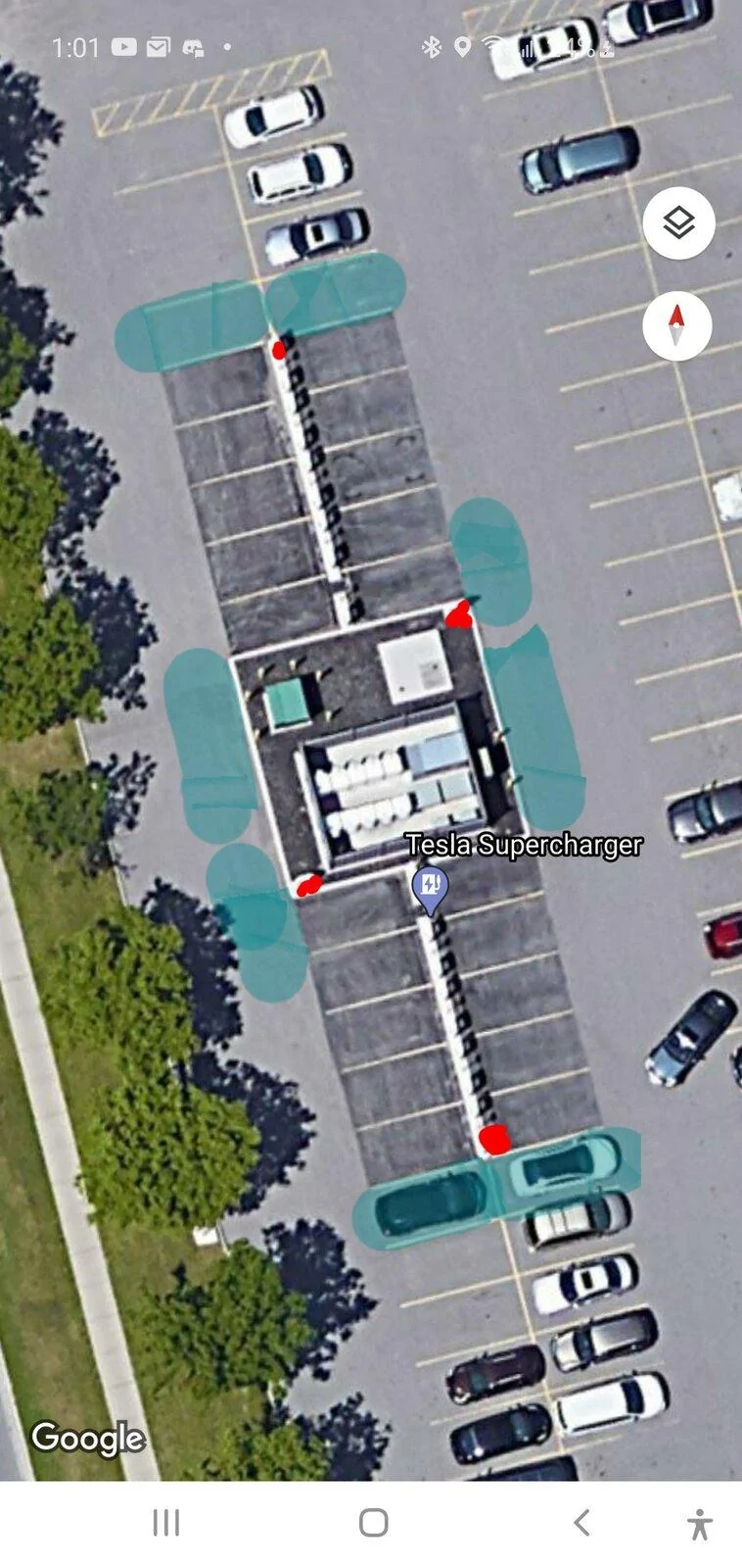

...which makes an assumption that trailer-supporting chargers won't be available in the future. ...
So true. They will be coming. I have seen plans for Superchargers with wider spaces specifically for cybertruck.
Although not really officially set up for it, I think you could charge in any of the 4 spots I have marked at the local Supercharger without unhitching a trailer
Tesla Cybertruck Can I make it to the lake and back with my bassboat? 20210111_130454
as long as you were respectful of the other cars there.
