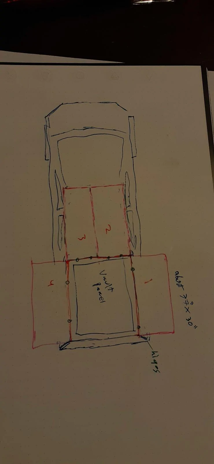

Hey all, I'm thinking of making a simple fold out 4 panel system that will sit on top of the bed slope. for when I take trips deep into the woods.
my questions are:
-Will I need a battery buffer between the panels and inverter that the 120v tesla charger will plug into? Like if a cloud passes by, would it be bad for the truck or charger to just turn on and off like that?
-if so how small can the battery be?
-I know very little about electricity,
How fast would the truck charge if each panel is 300watts? That would be 1.2kw/h meaning it charges at about 1kw per hour?
The panels would be 4 total about 30x77 inches each. I would add 2 more but they would cover the vault panel. Here's a little pic. I would just manually fold it out.
Any info would be appreciated! Thanks :love:
Let's start with this question.
With the technology you can buy today a "panel" yields about 1/4 kW at 240 VAC. You might get a bit more but let's use that as the math is easy and you call always adjust the answer down by 10% if you think systems will be better by 10% when you do the project.
Four panels at 1/4 kw = 1 kW when the normal to the panel is pointed directly at the sun, there is no haze and no clouds and the sun's elevation is greater than, let's say, 30°. But let's hold off on that aspect for a minute. Feeding 1 kW to the trucks charger will send about 900 W to the battery. The CT's will probably require 350 - 450 Wh/mi. At 400 you would get something like 2.25 miles per hour of charging per hour under the optimal conditions we've discussed. By dividing the kWh collected from a panel by it's ideal circumstances performance you can calculated the effective number of ideal hours in any time period. Over the last year I averaged 3.33 hours per day. That means that on average I would be able to add about 7.5 miles per day from a 4 panel system. On the best day of the year I got just over 7 hr. That was in June (when the summer solstice occurs though the best day wasn't at the solstice). That would have added 15.8 miles to a CT. In December of last year on the best day I got 2.66 hrs and the average for that month is 1.61. These numbers come from a system that experiences pointing loss of about 5% so you might be able to improve on them by having your rig track the sun or manually tracking it. You will also do better or worse than the numbers I gave depending on whether you live in a place with more or less sun than I get. NREL publishes maps and tables of insolation. You can consult them to get a rough idea as to what you can expect. Keep in mind the truck will tax you as much as 12 miles per day for phantom/vampire drain (battery energy used to run the computers and modems when the truck is parked). You can do things to reduce this somewhat. Thus, and I'm always telling people this, the proposed Tesla built in array or a project similar to the one you are contemplating might cover your phantom drain with a bit over in a sunny clime but you had better not arrive at your campsite with 10% SoC and rely on solar to get you back to a SC 100 mi away after several days camping. OTOH were you to stay 10 days you could lose as much as a quarter of the battery to phantom without such a solar system but lose nothing to it with one.

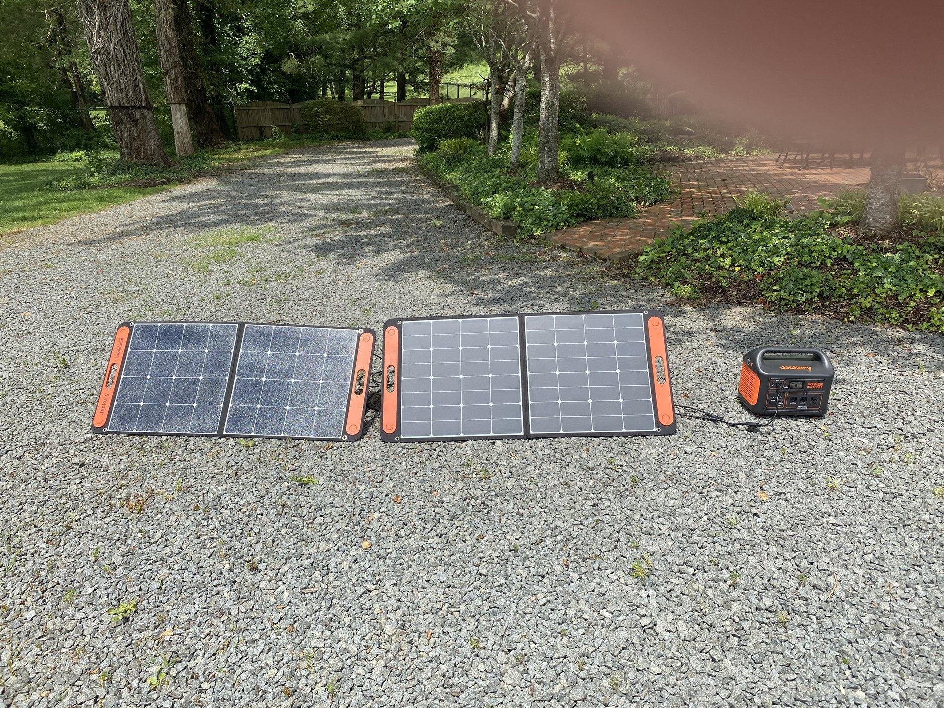

The picture below shows the system you want (but the one pictured isn't as big as you want)
The box on the right is a Jackery Explorer 1000 and it contains all 4 of the items listed above. A Tesla can be plugged into it (using a special adapter that fools the UMC into thinking the Explorer is a house) and will charge the car at up to 1 kW (this model's limitation). When solar panels are connected, as they are in the picture, energy from them goes to the car if it is drawing current. If it isn't that energy goes into the battery. The Jackery box is a miniature off grid system i.e. just what you would have for an off grid cabin but scaled down.
So that picture shows exactly what you want except that these are 100W panels capable of producing at most 200 W and, at the time of the picture, producing more like 110 - 120 W because while it is obviously a sunny day it is hazy. Thus if I start with a full battery and plug the car into it will get 0.1 kW from the panels and thus take .9 kw from the battery. As it's a 1 kWh battery it will be completely discharged in 1.11 hours. At this point it will shut down.
Clearly what you want is a product just like this from Jackery or another manufacturer that will accept 1000 amps of panels rather than just 200.
To get more insight into this note that we express the battery size in Wh. Thus for this battery C = 1000. Watt Hours. If we discharge the battery at some rate r*C it will be fully discharged in 1/r hours. For example, if r = 0.9 the discharge rate is 0.9C we are drawing 0.9*1000 = 900 W and the batery is discharged in 1/.9 = 1.11 hr. If we discharge at 0.9 C but charge at 1.0 C the net drain is (0.9 - 1)C and the battery will actually charge. But if we can only charge at 0.8C the battery will discharge at (0.9 - 0.8)C and discharge in 10 hours.

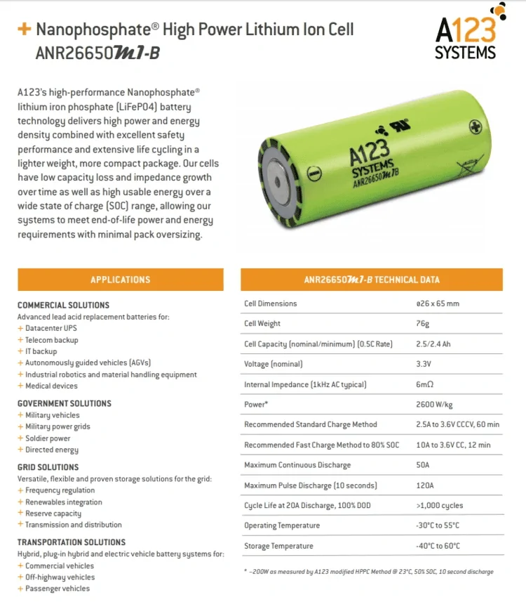

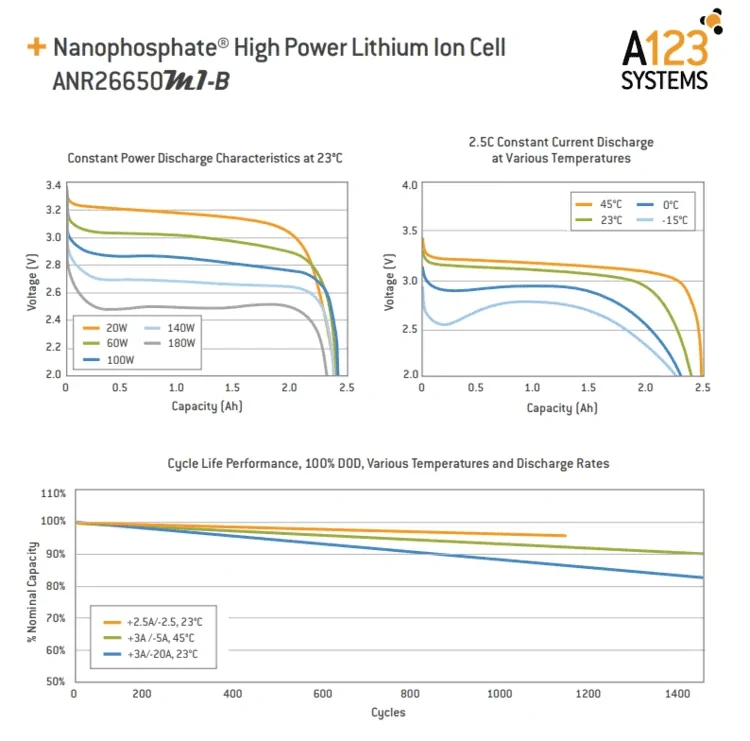

I also have a couple lifep04 lithium battery packs using a123 26650 battery cells from a hybrid bus.
these things are pretty cool. much lighter than the lead batteries obviously and they can allow 50amp max continuous discharge
I was thinking of making a decent sized battery from theseto replace the lead acid that isnt performing as i hoped.
