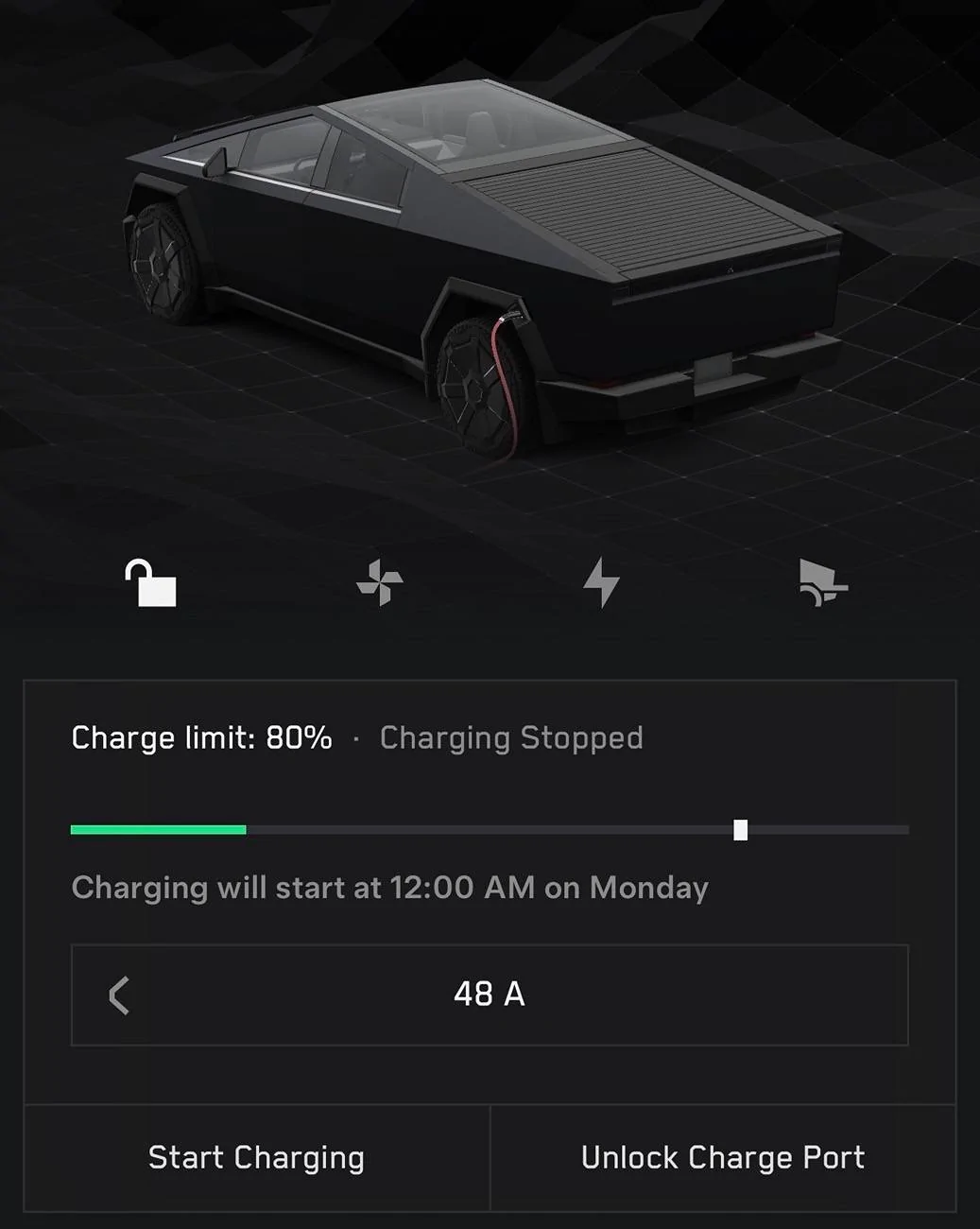

My wallchargibv showing red error / light and Ct as well (pic attached). Any idea why that's happening?
Tesla Cybertruck Charging error.. red cable IMG_1605

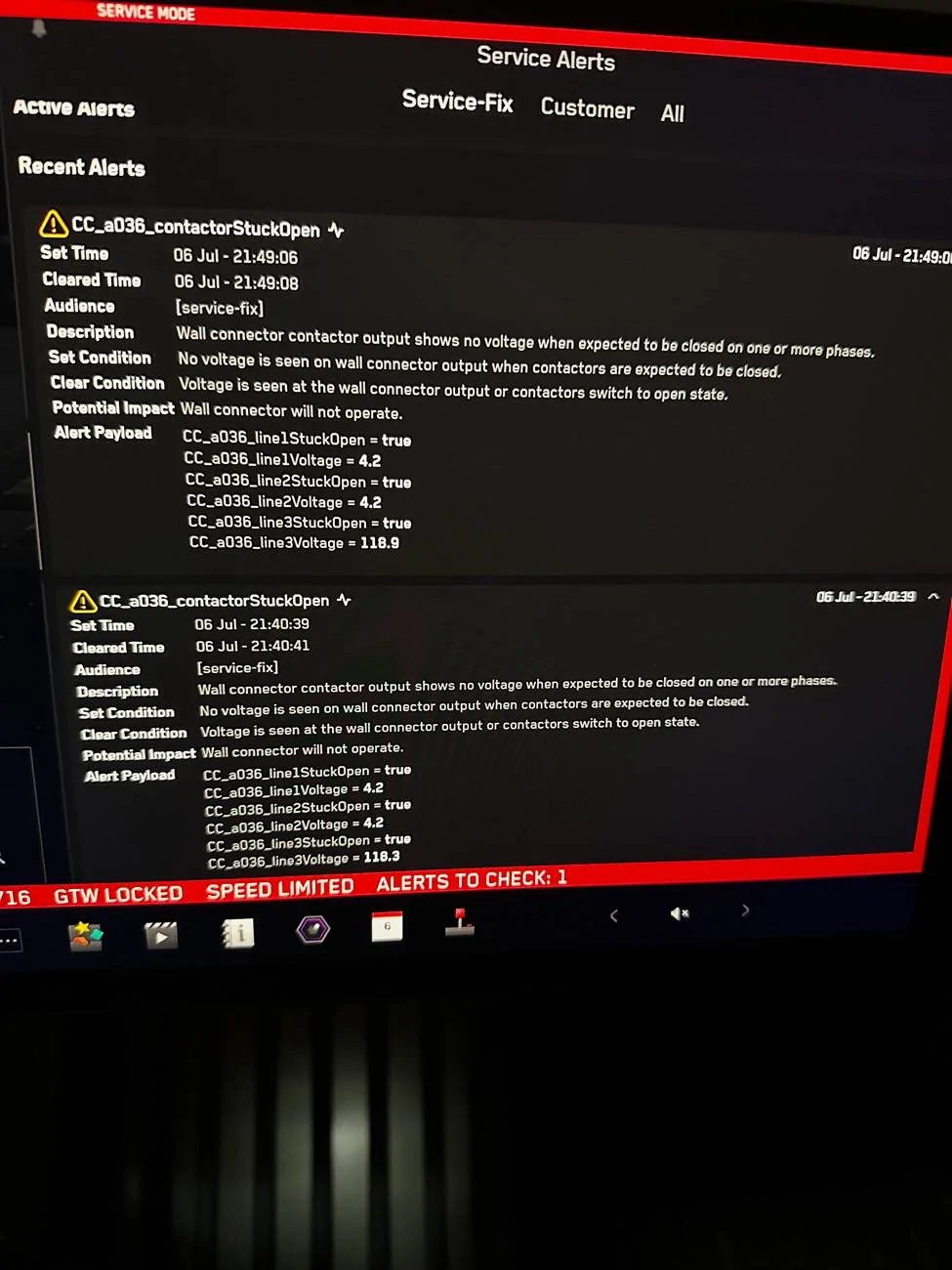

Service menu shows this.
Tesla Cybertruck Charging error.. red cable IMG_1606

Only 4.2 volts on L1 and L2 of your wall charger? Have you power cycled it yet?
Flip the breaker, wait 5 mins, then turn back on.
