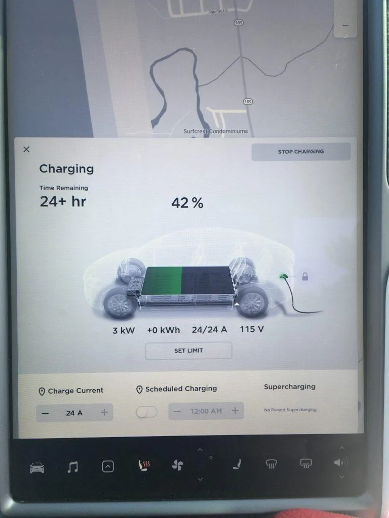

Do you typically use the NEMA 14-50 for your RV or the TT-30? Are you at the same site for several months? Tesla used to include the 14-50 adapter for the mobile connector with the Model S and X, but now you have to buy it separately.
https://shop.tesla.com/product/gen-2-nema-adapters
There’s also various splitters for a 14-50, this one gives you two 14-50 females, it could save you from unplugging, but you’d need to make sure you’re not charging the CT while running anything in your RV.
https://www.amazon.com/RV-Power-Splitter-Lighted-Female/dp/B07D4PT7T6/ref=as_sl_pc_tf_til?tag=&linkCode=w00&linkId=&creativeASIN=B07D4PT7T6
Campgrounds can vary quite a bit on what they offer for power, even from one site to another at the same location. I’ve been to one where I only had access to a TT-30. I bought this third party adapter, it was quite slow since it’s only 110 volts.
https://www.evseadapters.com/products/tt-30-adapter-for-tesla-model-s-x-3-gen-2/
I’ve also been to a campground with a pair of Tesla destination chargers onsite. Just parked our Model X near their main building to charge which was only a short distance from our campsite.

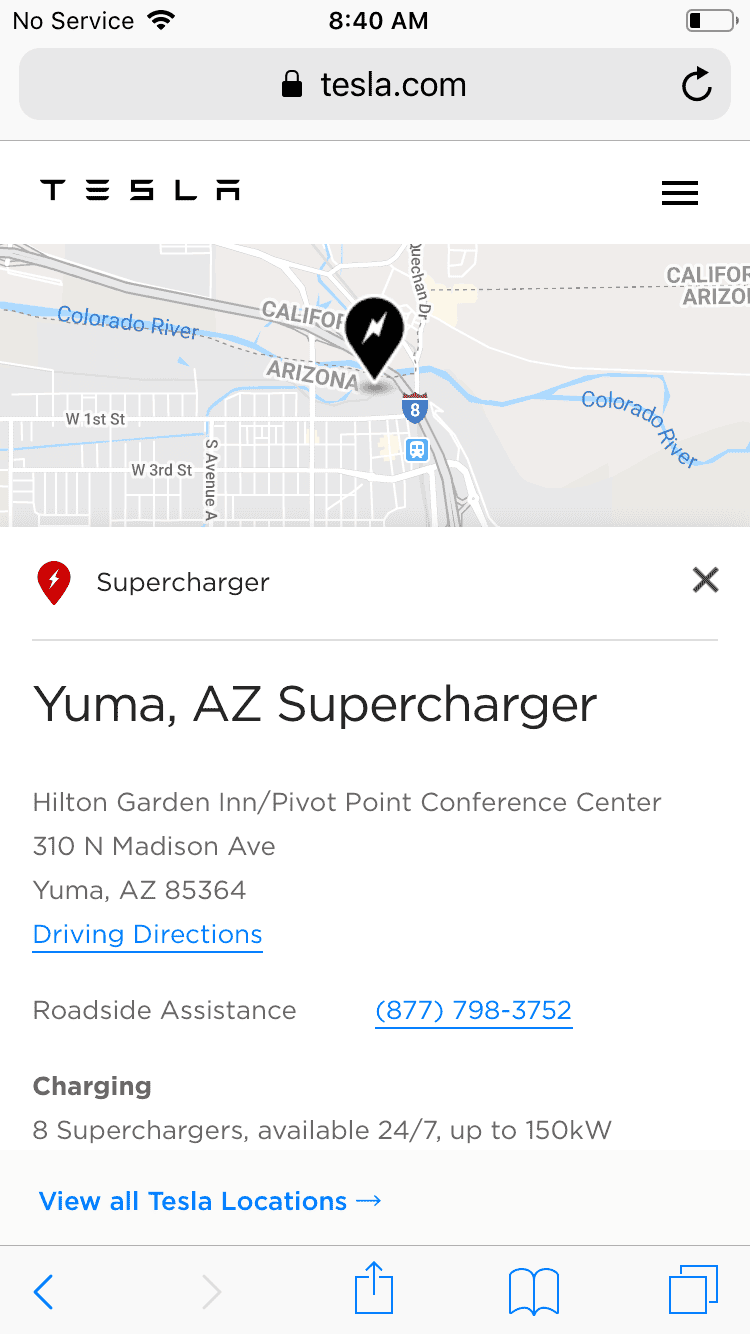

In case you ever need faster charging to go somewhere, there’s a supercharger in Yuma too.
