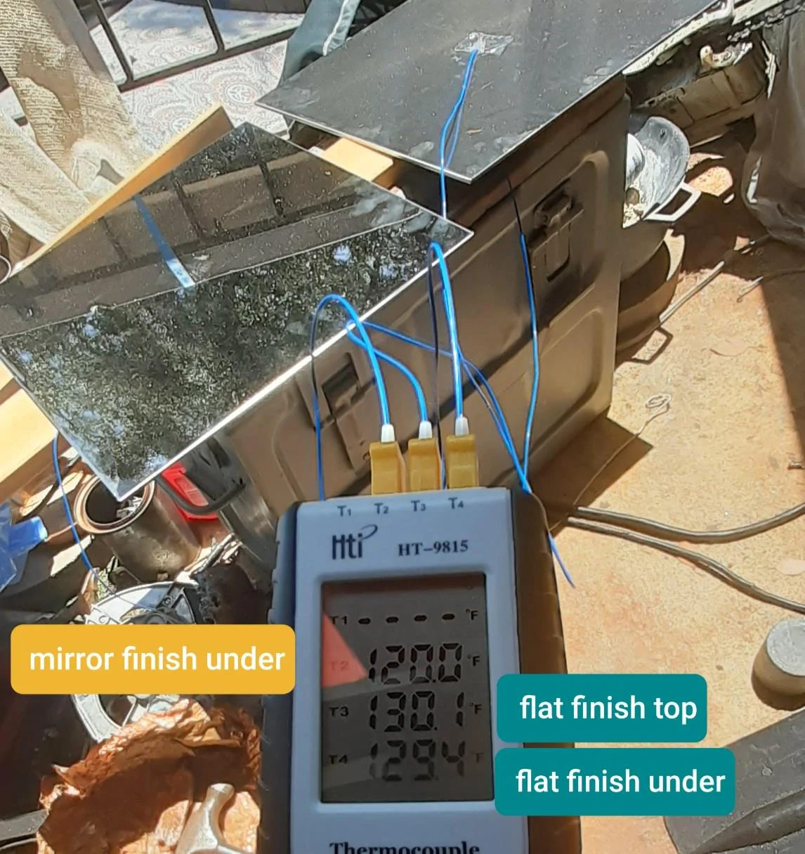

2nd test mirrored and flat finishes after all day in the sun ambient temp 78f very slight breeze.
Mirrored : measured under the plate with k type thermocouple taped to it. 120f
Flat : on top (facing sun) 130.1 f
Under 129.4 f
some1 asked about magnitism- Its basically non existant, super strong neodymium can barely hold itself on

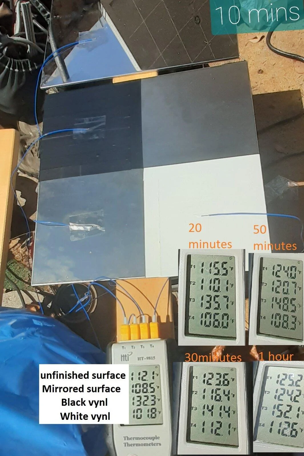

New surface temp test with vyln wrap tape type material on it. ( i figured painting wasnt really relevent.
Pic should be self explanatory but ill write the cliff notes here.
ambient temp about 80F
-White coolest 30-40F cooler than black
-mirrored next coolest
-unfinished surface 2nd hottest
-Black hottest
@ 10 minutes in sun: unfinished surface: 112.1F
Mirrored: 108.5F
Black vynl: 132.3F
White vynl: 101.8F
@30 minutes unfinished surface: 123.6F
Mirrored: 116.4F
Black vynl: 141.4F
White vynl: 112.1F
@50 minutes Unfinished: 124F
Mirrored: 120.7F
Black Vynl: 148.5F
White vynl: 108.3F
Ill do some 1 on 1 tests: 1 plate all black vs 1 plate all unfinished.
I think having the colors on 1 plate eventually (past 1 hour), started effecting the other temps. also will leave for 3+ hour to try an find a max temp
