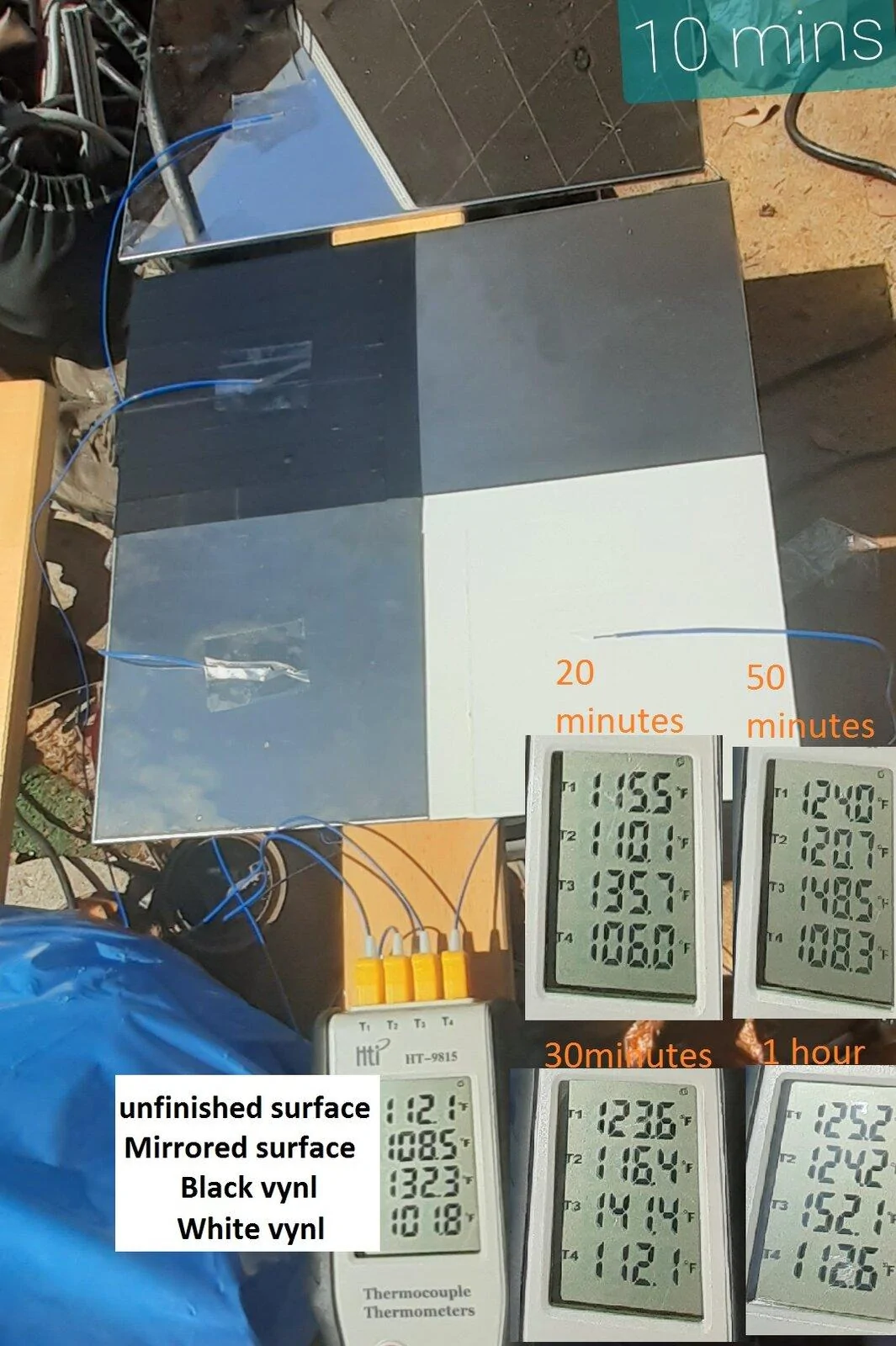

New surface temp test with vyln wrap tape type material on it. ( i figured painting wasnt really relevent.
Pic should be self explanatory but ill write the cliff notes here.
ambient temp about 80F
-White coolest 30-40F cooler than black
-mirrored next coolest about 5-10 more than white
-unfinished surface 2nd hottest difference between unfinished and white was about 10-15degrees (probably getting larger the longer its sitting in the sun). might be worth wrapping
-Black hottest
@ 10 minutes in sun: unfinished surface: 112.1F
Mirrored: 108.5F
Black vynl: 132.3F
White vynl: 101.8F
@30 minutes unfinished surface: 123.6F
Mirrored: 116.4F
Black vynl: 141.4F
White vynl: 112.1F
@50 minutes Unfinished: 124F
Mirrored: 120.7F
Black Vynl: 148.5F
White vynl: 108.3F
Ill do some 1 on 1 tests: 1 plate all black vs 1 plate all unfinished.
I think having the colors on 1 plate eventually (past 1 hour), started effecting the other temps. also will leave for 3+ hour to try an find a max temp

Thank you for all you do. I made my choice, it will be unfinished. As I can see the temperature does not really play on it
np Tim, glad you got something from it. I was plannin on having unfinished also. I really like the look.
I was thinking since the metal is thicker it would hold more heat, so far that dosnt seem so, but i have yet to do a full 12x12inch sheet in black all day. Im pretty interested in how hot it will get
