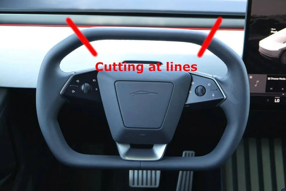

I am considering modifying the Squircle into a Yoke. I would like to mount a display behind it without its view being impeded. I do not use the top part of the wheel while driving. I know there are steering wheel options for the S,3,X,Y but there are no aftermarket options for the CT yet.
Does anyone have any experience, recommendations, or considerations they can share?

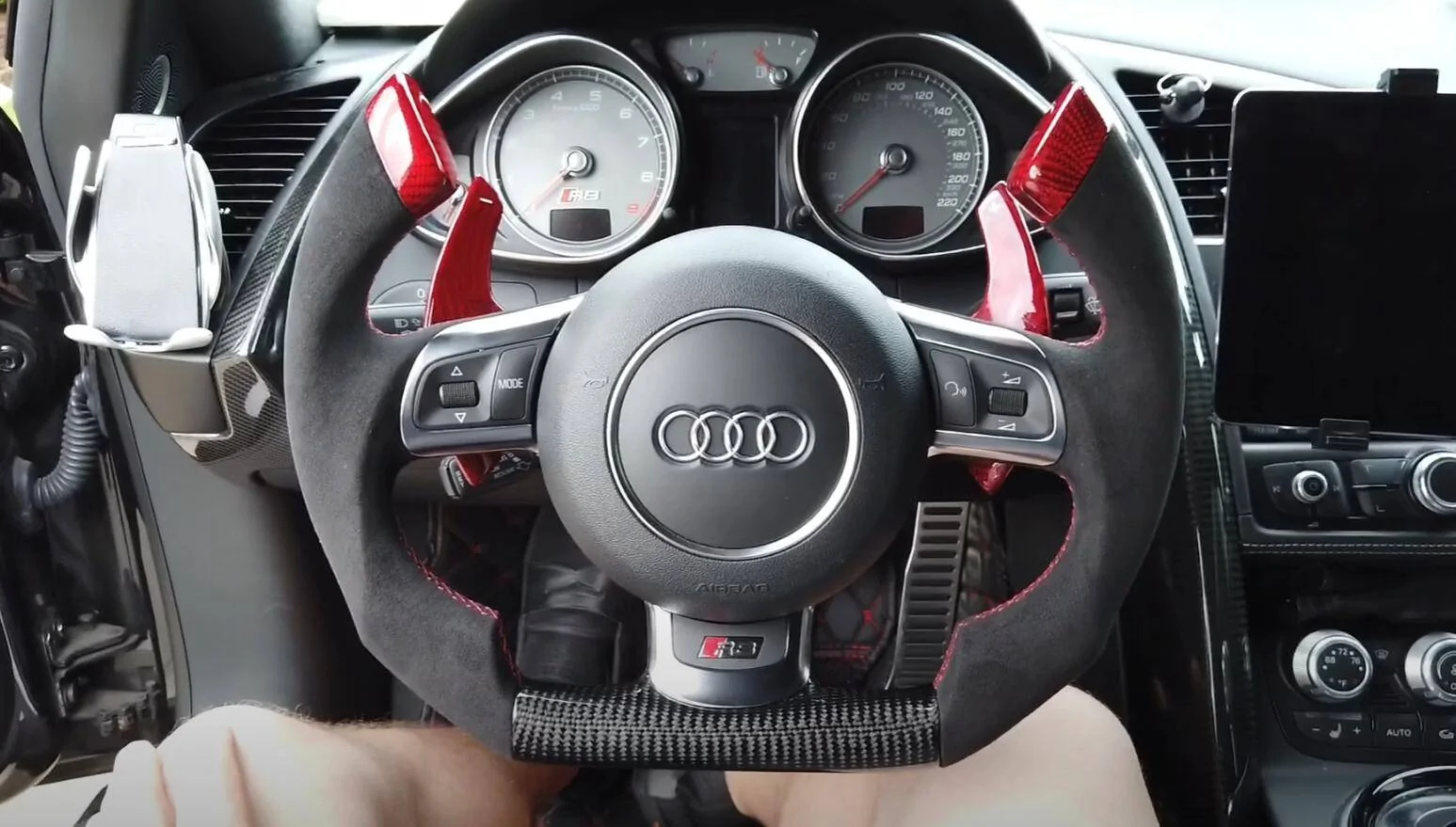

Result would look similar to this
Tesla Cybertruck Converting the Squircle into a Yoke 1729788817262-ha

Probably going to cut through some heater wires there, probably. Something about the Audi steering wheel looks off, maybe the caps or something.

Ahh thanks. I had not considered that. Last thing I want is faults/errors popping up.

My recommendation is leave it alone and get used to it.

Pimp my EV has confirmed to me via email that they are soon to offer steering wheel options for the Cybertruck so you can just wait until those are released instead of trying to hack through it yourself.

Thanks for the info. I am all about the path of least resistance, and this is it.

Aside from the heating function in the wheel, the other issue I see is the 48V architecture. Unless someone can confirm, with a voltmeter, that the airbag system (behind the wheel's center horn) is 12V. You might just have to wait until 3rd party solutions, such as "Pimp My EV", comes out.
Another alternative is this:
1) Purchase the steering assembly from Tesla Parts directly.
2) Perform the cut as you intended.
3) Finish the ends of the cut with end caps or pleather.
4) Assemble it and see what happens.
5) Most likely you would lose the heating feature, but if you live somewhere warm/hot then it's a nonissue.
*Note* As this is experimental, if the entire steering assembly stops working then you will lose out on the purchase price of the part, but at least you'll still have your original steering wheel to fall back on.
If and when you do perform this, make sure to disconnect both the power from High Voltage Battery and the 48V. Finish the work. Reattach the power. Then go to the "Service" menu, and then choose "Steering Calibration" in order for it to work.

You mentioned wanting to do this in order to have a clear view of a 2nd display. Since there is a lot of depth to the top of the dashboard, couldn't you simply move the display further forward?
