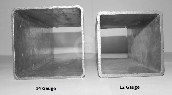

Corrosion, at least on the stainless steel portions, will be a non-issue.
Have you seem this? Tesla says they are using 3mm of cold-rolled stainless.
3mm is slightly thicker than 12 gauge. It's almost an eighth inch thick.

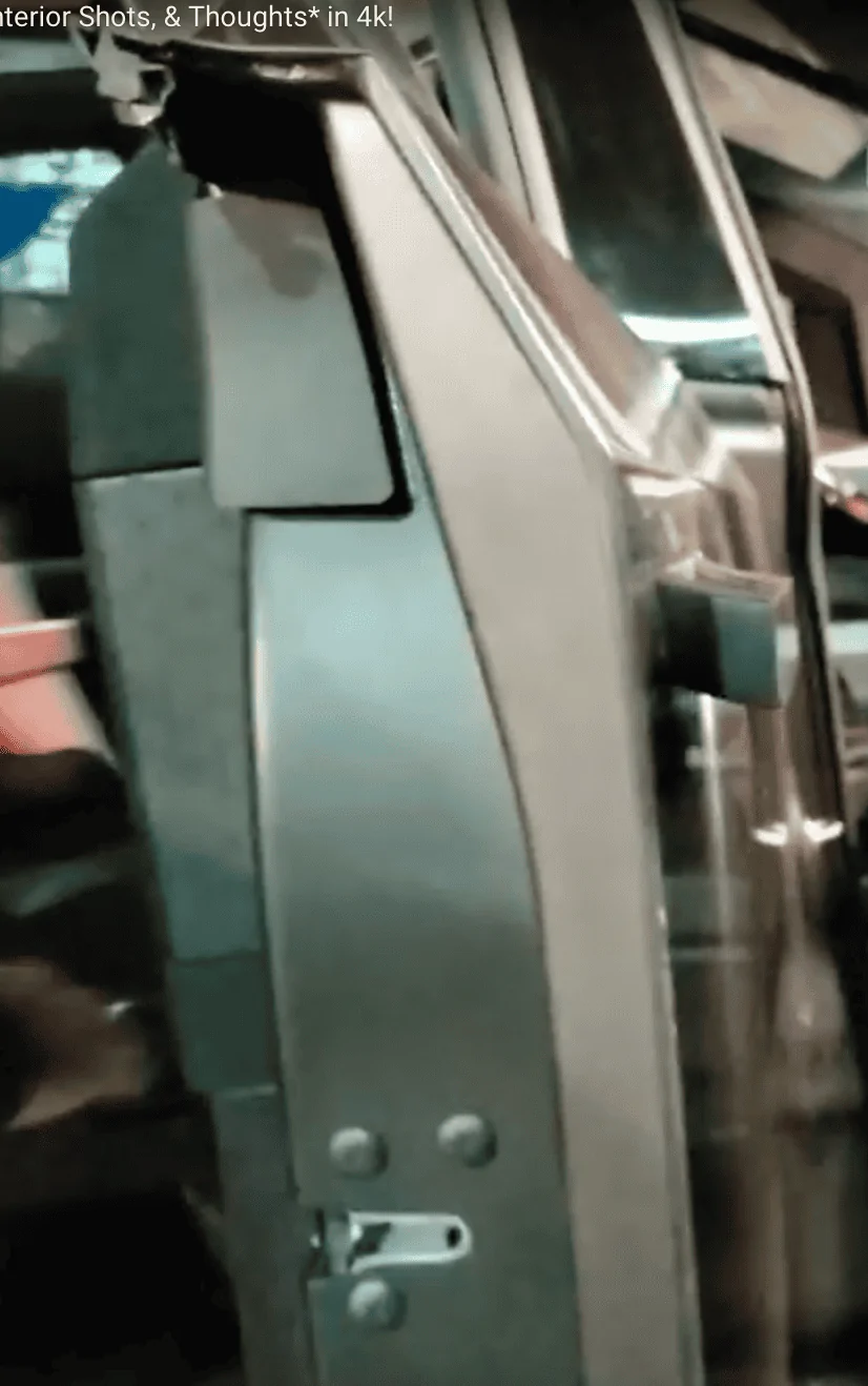

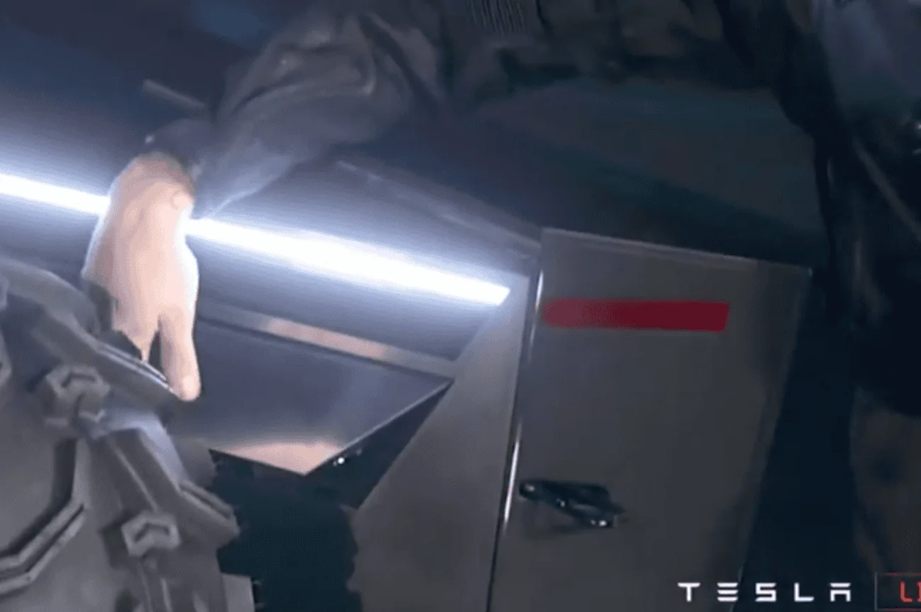

Have been looking for more pics showing the steel edge-on, to hopefully get a better idea of how thick...
Here's a couple of screen caps. Both are from the unveiling event.
This is inside the bed, with the tailgate down, and you can see the latch the tailgate hooks to.
Look just above the red rectangle. THICK!
Under his arm is the track that the vault door uses. It looks like there's 3mm steel both at the top and bottom of that track.
Being held open is the door to the charging port for the CyberQuad. That door is not 3mm thick.
And here is the side of the door. THICK SKIN!
But something is missing at the top fold, it's too thin.
