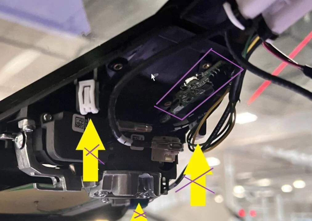

The Hansshow is a game changer: It has a better night picture than the stock camera, plus you have the option of using it as a trailer camera (with the right accessories).

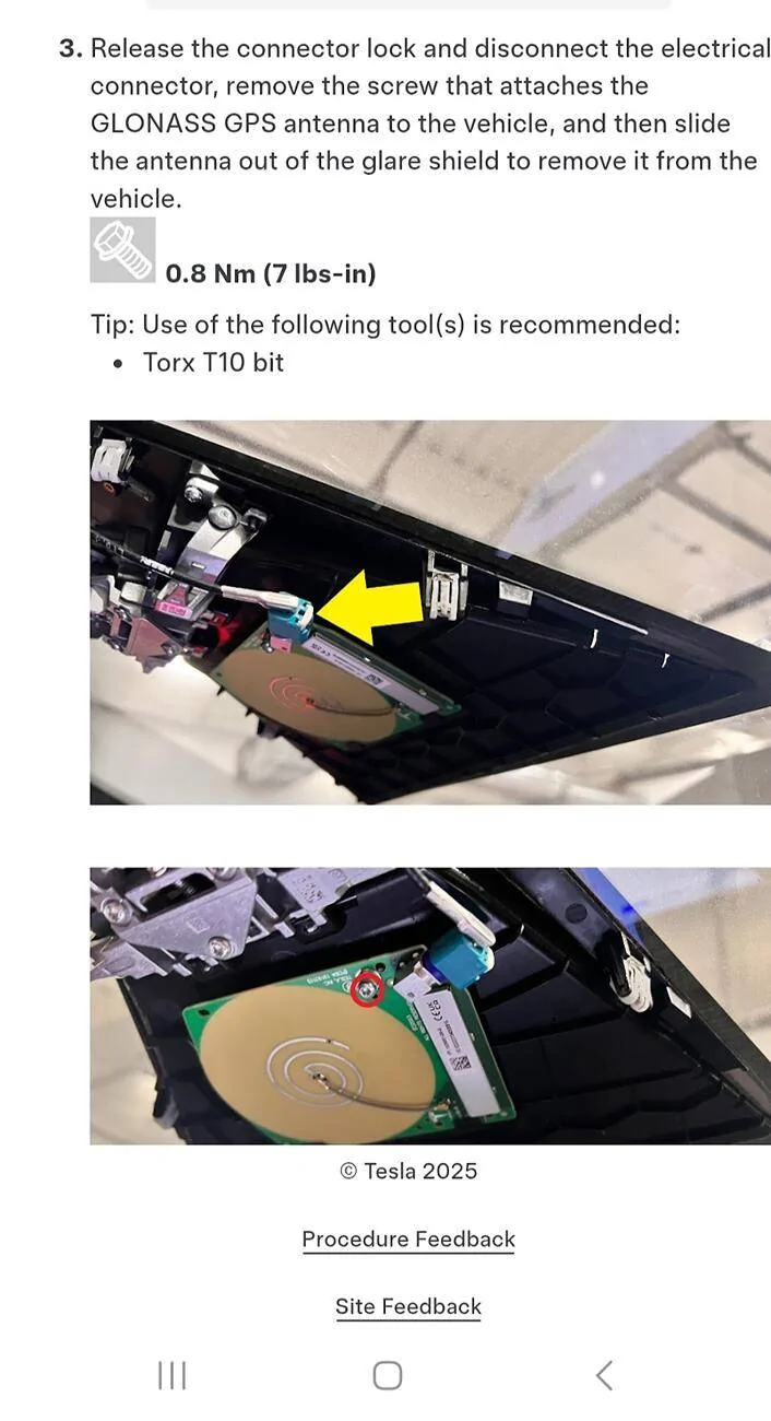

I note that the GPS antenna is above the mirror, and seems to be sensitive to interference. My truck complained a couple of times about degraded GPS performance, so I moved all wiring away from the antenna and it seems good now.
