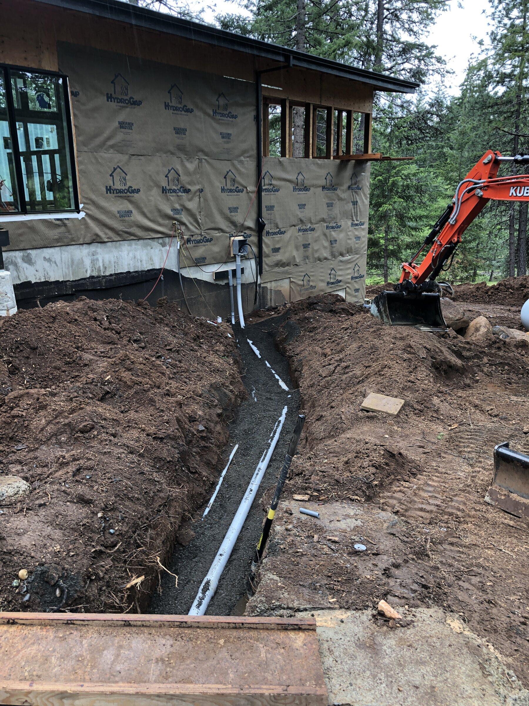

"Overkill us underrated". 4
“Just make sure the conduit is big enough to pull another wire through”… said nobody who has ever pulled 4 gauge wire through a long section of conduit.
AWG 100amp. 4" conduit and aluminum 4 awg is the only way to go. If you don't need it, it still carries current below amperage rating. A life lesson that has payed off several times.
