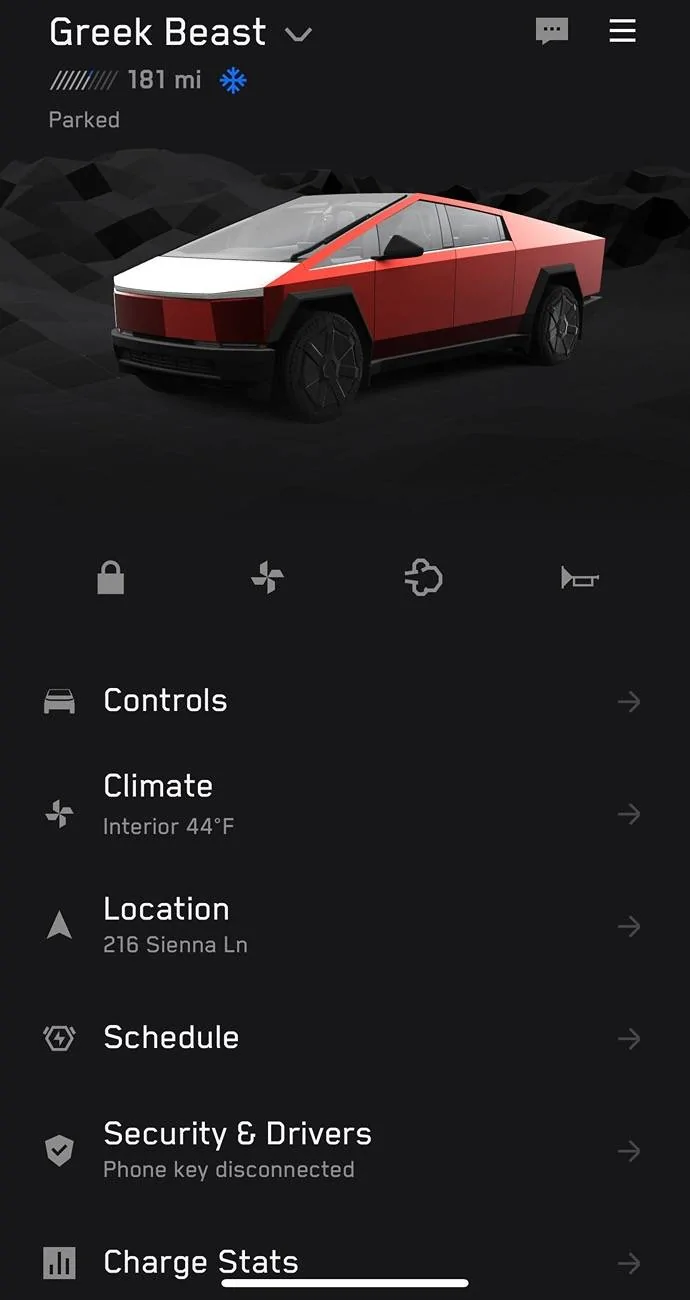

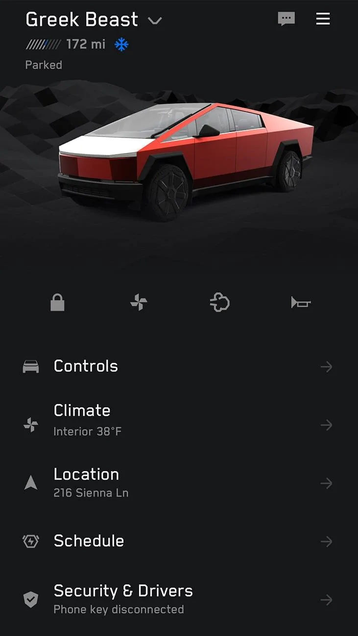

Does this happen to you?
I was 181 miles at 10:30pm and the next day at 8:30am my CT showed 172. Sentry mode is turned off when I am at home. I lost 9 miles overnight. Is this normal?

Yes. This is normal behavior on all electric cars, not just the Cybertruck. It’s wintertime, so you’re seeing thermal management. A big hint is that snowflake!

The pack is cold and is really at 60%
Blue bars is energy not currently available due to cell temperature.
Tesla Cybertruck CT loses electric miles overnight (vampire drain) Screenshot_20241209_091345_Firefox
2% = around 7 miles
9 miles = around 3% additional cold loss
No it's how li-ion cells work. There's actually different kWh capacities for warm and cold temps.
2% = around 7 miles

Yes, completely normal, especially in the cold.

Could just be adjusting to the temp. Observe %, instead of miles.

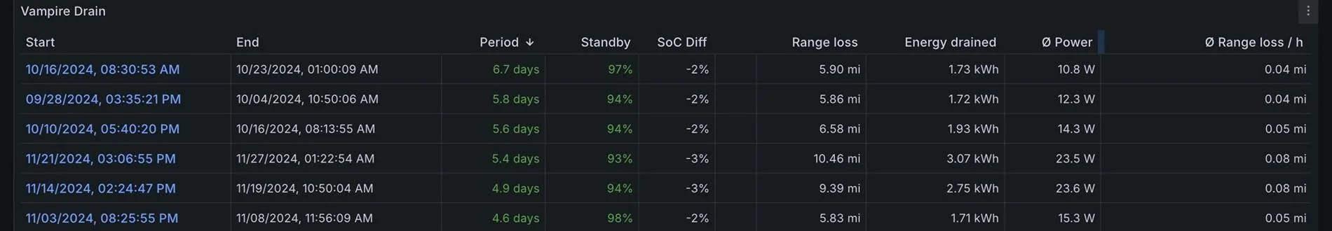

Wanted to post some data from our 2020 Model X for reference on the statement ā€œGive Tesla time, they will get the software fine tuned.ā€
Our X does amazing with vampire drain. Keeping in mind we make sure our key fobs are away from the vehicle so they do not keep it awake. No Sentry Mode active. Often see it ā€œasleepā€ for 4 plus days.
