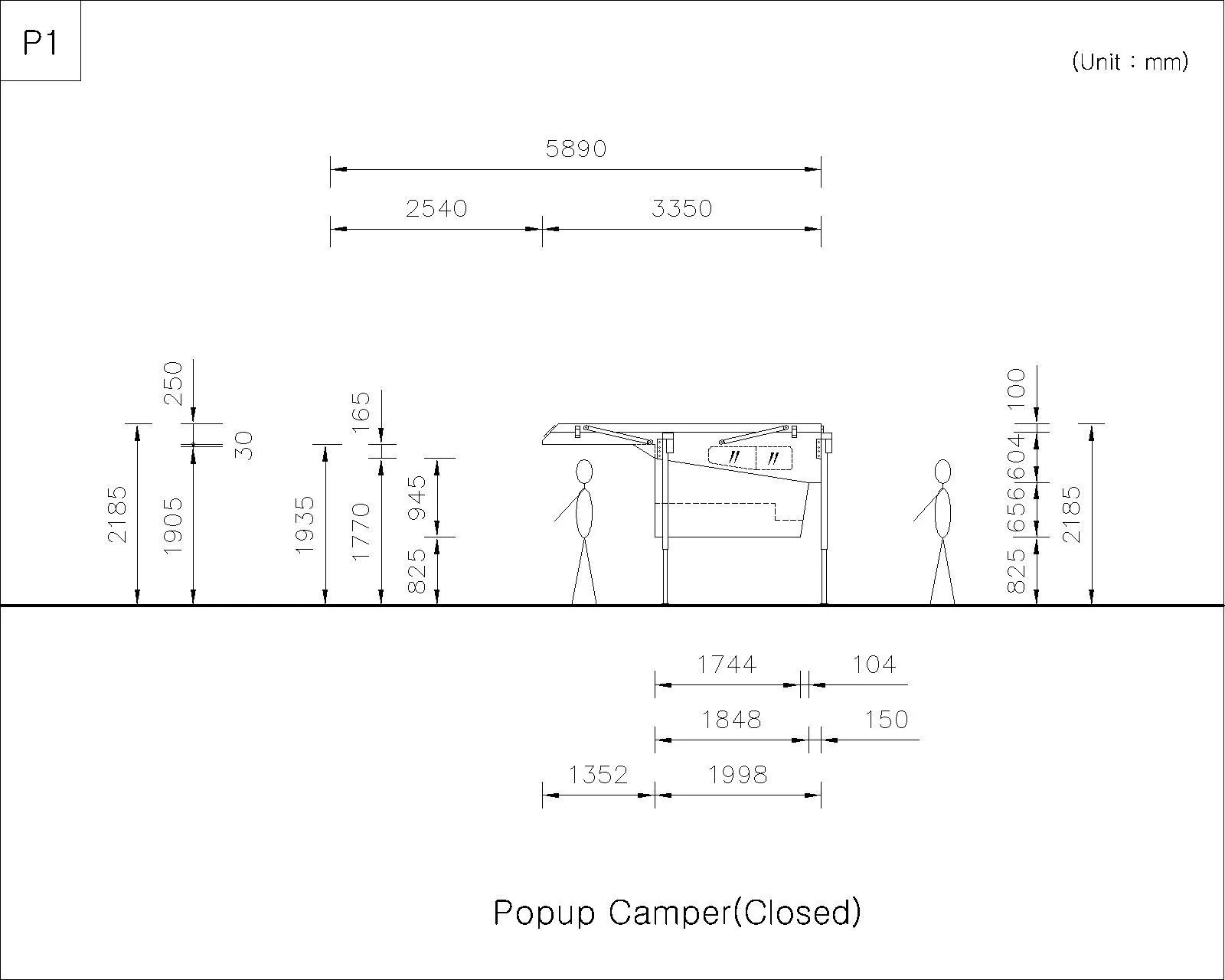

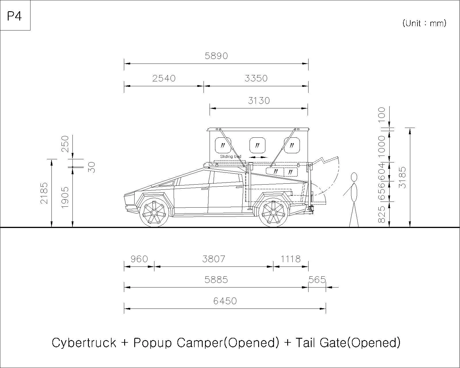

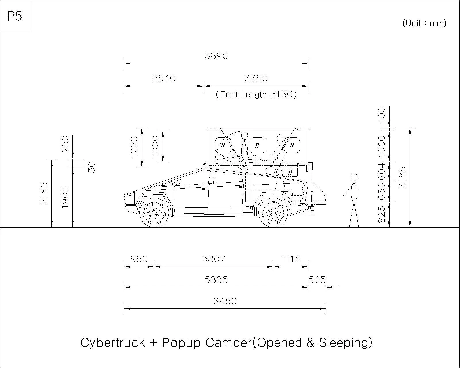

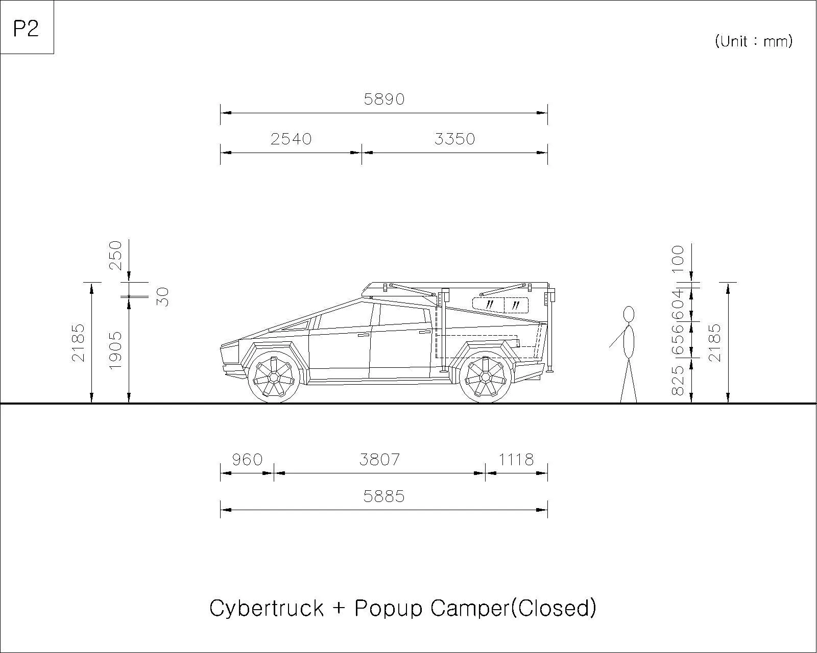

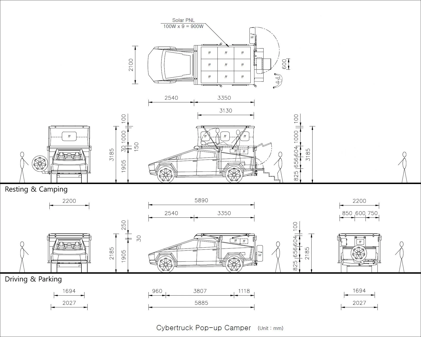

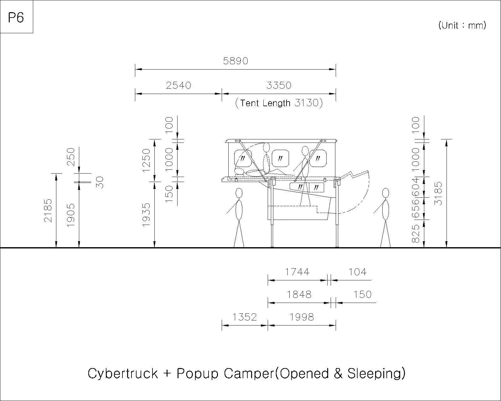

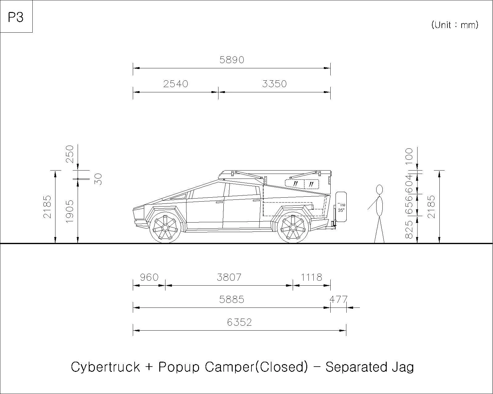

I designed the CT-Popup Camper.
The biggest features are:
- The CT body and the pop-up camper can be separated with a jack.
- Access to the underground parking lot with a height limit of 2.2m.
- The aerodynamic design does not affect the CT range.
- You can drive with the tailgate closed.
※ I'm sorry! In the interior design, the level of the sofa and toilet is in error and erased.

nice....cost = ?........~ $9,500usd, just my swag

This will affect the Cybertruck's range quite a bit. Likely at least a 20-30% range hit.
Just the increase in frontal area alone is a pretty big hit. The big flat sides that extend out past the Cybertruck's cabin are like big air brakes.
Even if it was perfectly aero (it's not), it's going to increase the truck's weight significantly which will decrease range.
Bunch of neat things here otherwise. Nice drawings. I think this is more realistic than the Cyberlander concept myself.

Great work!! This looks much more realistic for me than other rear camper designs I've seen. Namely, the ability for it to stand on it's own and drive out from under it. I am the type of camper that needs my truck bed more often than not, so the ability to drop off the camper anywhere without special tools/equipment would be paramount.
Personally, I am likely to just go with a trailer camper, but I do like your design!
