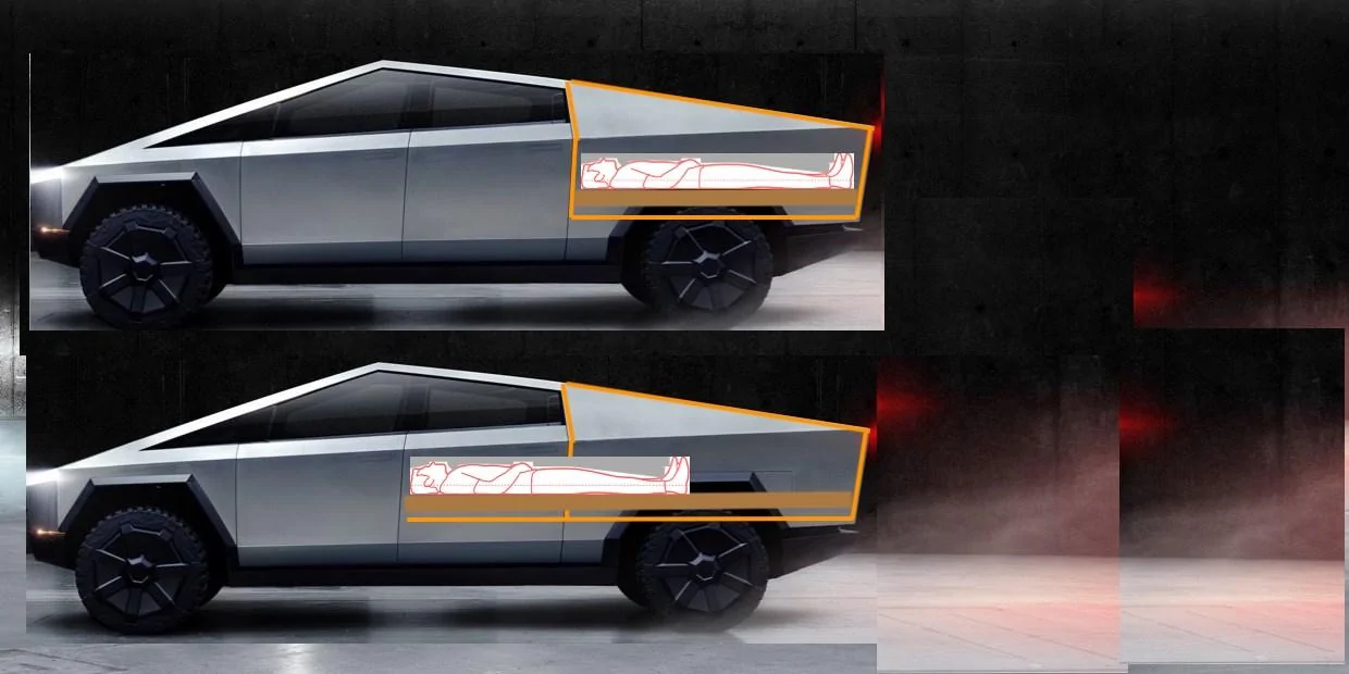

Here is two views of a guy my height (6'3")
1. in the windowless vault (incredibly claustrophobic)
and
2. half in the vault/half back seat. (feels do-able, but requires a Mid-gate)
Another reason I feel so strongly more room is needed (like a pop-top) is bathroom breaks at 3AM. I urban stealth camp a lot so bathrooming requires both planning and space.
1. in the vault and
Another reason I feel so strongly more room is needed is bathroom breaks at 3AM. I urban stealth camp so bathrooming requires both planning and space.

Ogre have you camped a lot? I squat at Walmart a lot. No tents on the ground there. The vault itself would feel very claustrophobic. No windows. A 6" mattress would leave you only 18" at the feet and 28-30" at your head. To me it would feel like a coffin. A Mid-Gate would allow 24" at the feet and maybe 33-36" at your head. Plus windows. A very likely scenario for me. I currently have a Colorado camper van pop top on a Promaster van. It feels like a palace to me. I wish Tesla would make that.

If it's just the vault, it will be very claustrophobic. If there is a midgate or even just a good passthrough, I think it'll be tolerable. Right now we're sleeping in the back of our Model Y and it's decent. But the Model Y is open to the front seat and you have windows all around and above you.
It's hard to know how dealing with middle of the night pee will work in the Cybertruck without seeing the final design. If there is a midgate it will be simple, just pop out the door. Being 6 feet off the ground and having to climb in/ out of a roof top tent does not sound like an improvement to me regardless.

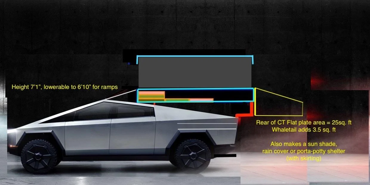

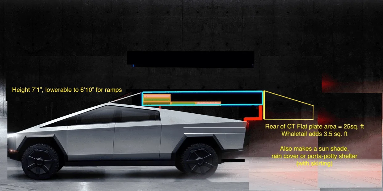

I did some math comparing space increase versus aerodynamic drag increase.
CUBES
The vault has 84 cu. ft.
The Bundu in the lowered position adds 67 cu ft above the vault, an increase of 80%
The Bundu raised adds 175 cu ft. Total above the vault 232 cu ft. Nearly quadrupling the vault's cu ft
DRAG
The ‘plate area’ of the CTs trailing surface is 18 sq ft
With the fold out ‘whale tail’ the Bundutop adds only 3sq ft of plate area, an increase (in drag) of 16%.
TRADEOFF
So for a 16% increase in drag (& reduction in range?) I can add nearly triple the cubes.
My wife has had a Model Y for a year and after 15,000 miles my range anxiety is greatly reduced.
These numbers suggest a Bundu on a tri motor formally should get 84% of 550 miles or 462 miles. Real world maybe 350 miles? I am fine with that price for a comfortable bed and a warm place to pee.
For stealth urban camping I could leave the Bundu down. At 51" internal height it would seem to be much more usable than the vault alone.
These are my guesstimates.

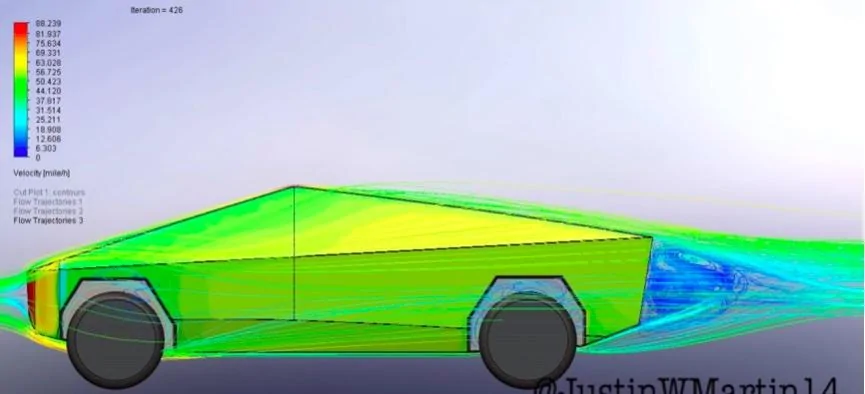

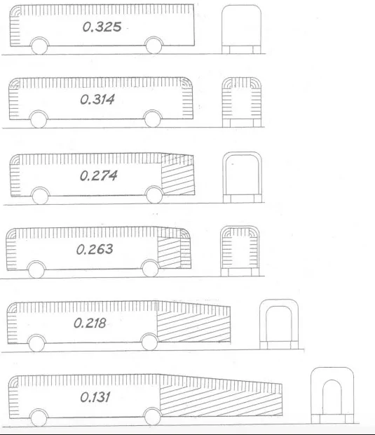

Here are two images that inform my thinking about aerodynamic drag.

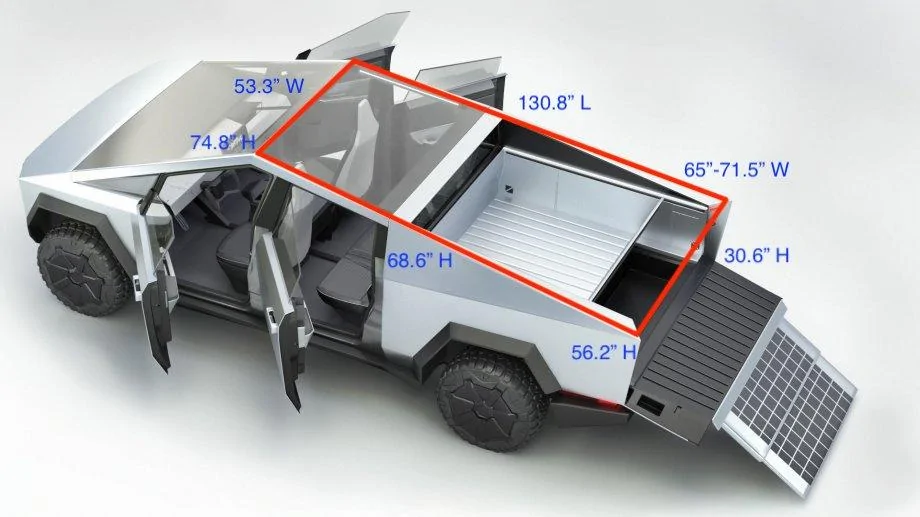

Some dimensions of the vault and pop top seal rim.

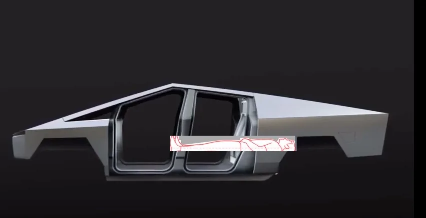

So, OK, for the moment just thinking about the stock CT. Here is I think the optimum sleeping position, head to the rear about 20-24" thru the mid-gate and into the vault. Front seats moved to max forward. A fairly easy pivot to egress.

Why do you think this is the ideal? Personally, I'd rather have my head where elevation is maximum, I can see out, and I'm closer to the climate control.
Also, your illustration looks way too low. I don't think the back seats will fold that low.
