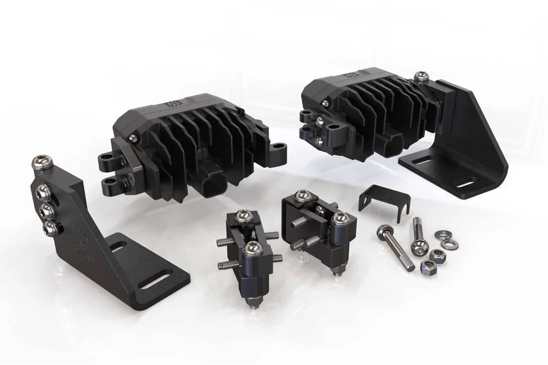

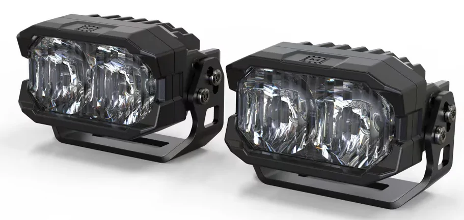

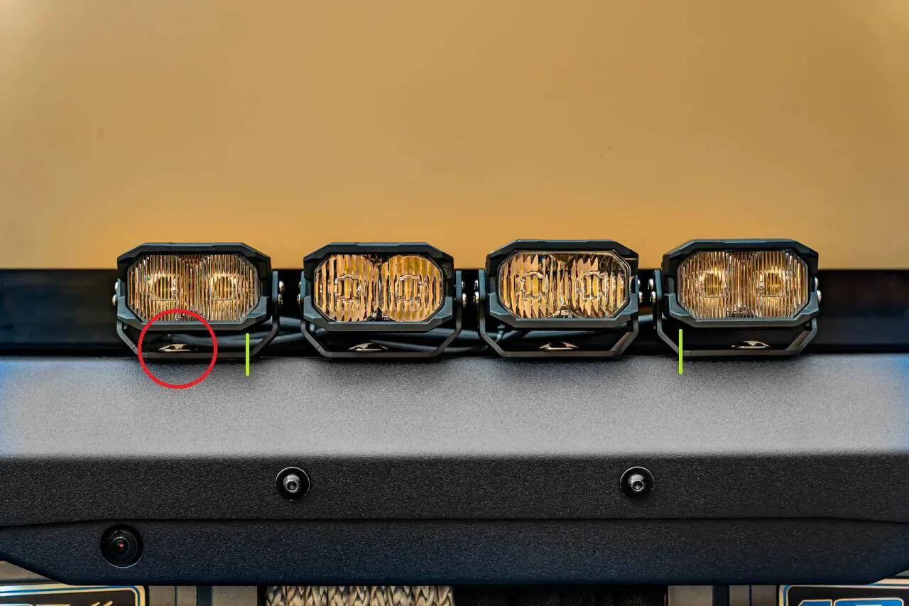

Looking at T-Sportlines pictures they appear to be mounting the 2 banger Morimoto's lights with one bolt each. I circled one in the picture. Morimoto does sell a link kit so you can make a lightbar (bangerbar) out of them and have mounting points only on the ends.
https://www.morimotohid.com/Links-Mounting-Accessories-BangerBar-Single-Row-2Banger?quantity=1

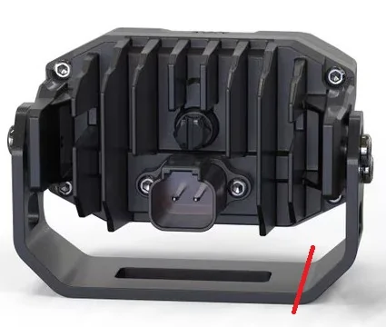

You'd have to buy 3 link kits $105. If you went that route the two middle holes could be used to route the wires under the lights rather than the back of the bumper. Each light comes with a mounting bracket which 2 could be modified by cutting one end off. A file and some black spray paint and who would know. I put a red line on one of the pictures. That way the slot on both sides will allow for positioning. Morimoto does sell an end kit at the same link but the holes would not work for mounting.
Morimoto uses a standard DT connector so you can combine two lights into one harness.

I don’t think the DT connector is fitting thru those slots. Have to cut and splice. Not worth the minor appearance change. You see wires on light kits often, it’s normal. I did change out the outside fog brackets today, I had to unbolt the main bumper to get room. And remove the skid plates. More time, but I have it and looks much better.
