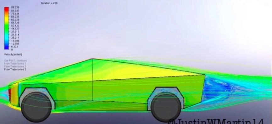

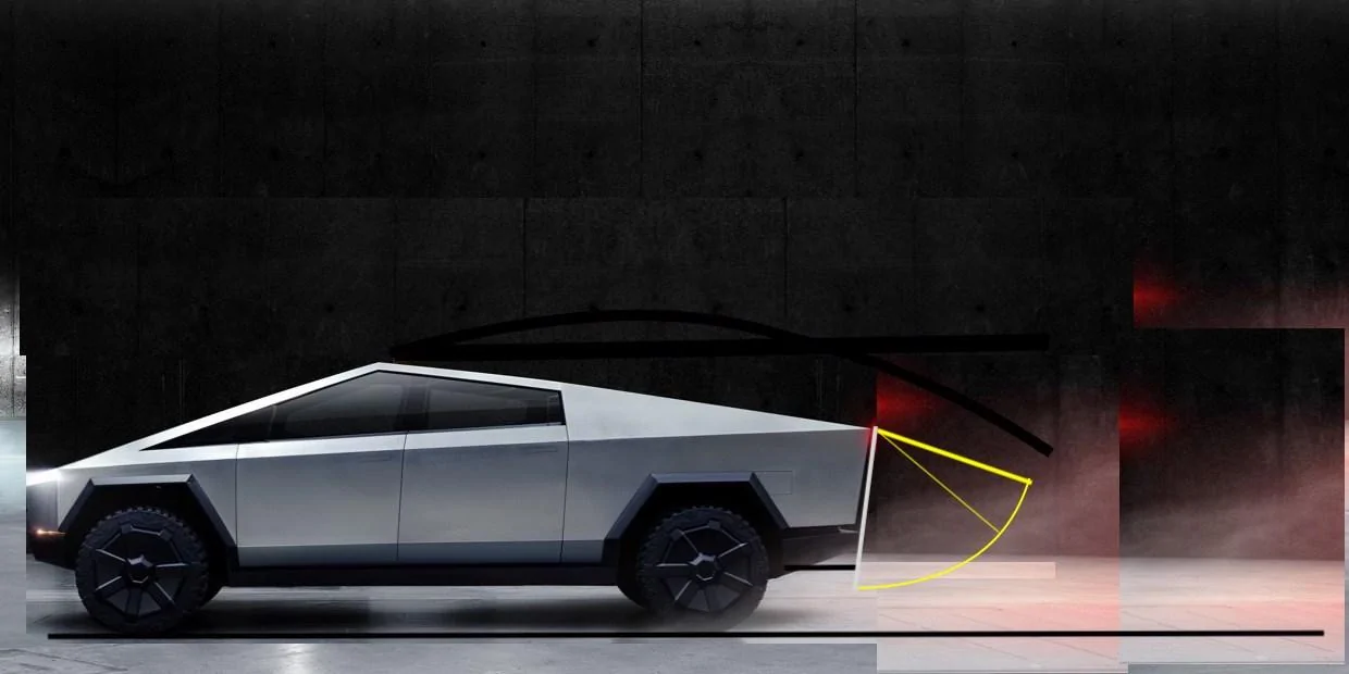

Because so much of the aerodynamic drags is in the area of separated airflow behind the vehicle a well designed foldout 'whale tail' could both lower the height of the separation from 57" to 41" and narrow it from 80" to 60" This would reduce the separated area from 4500" sq to about 2500" sq. Just a guess but this would seem to increase efficiency range by 10-20%. You'd just have to fold the whaletail to supercharge.

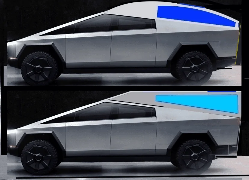

No aeronautical engineer, sailor, results defy experience. Top example; aero-design entry bellow to a large chord depth in middle terminating down to a small concave separation. Flyboys call that a wing. A high lift shape that we use on sailboats to power through chop and medium wind<14kts.
Bottom example; smooth transition off the Cybertruck fwd slope, breakover angle>30° terminates at the vehicle limit in-line and 90° to vertical. Fluid dynamics coaching used shaping underwater hull and keels teaches that air attachment separates with that greater than 30° angle. That separation ==turbulence=drag until it cleanly breaks-off at the nice 90° point.
Both examples fail the efficiency envelope adding additional force vectors in lift and drag. Forced to choose? I‘d redesign the bottom example as a collapsible shell. $0.02
