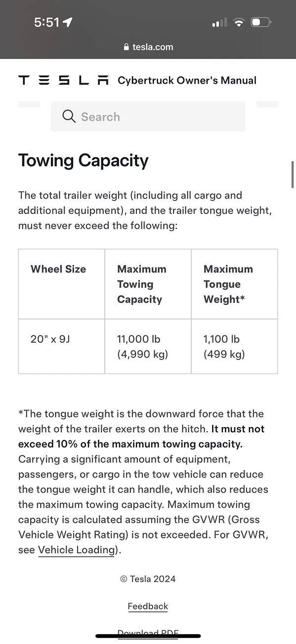

IMO, the reference to “vertical loads” specifically imply loads that would cause rotational torque on the hitch. In the scenario you described, if you were to install a 8ft tall stripper pole on your trailer hitch mount and dance on it you might would rip the hitch off. But a downward vertical weight above 160lb would not torque it off.
The owners manual lists the maximum towing capacity at 11,000lb with a tongue weight of 1,100lb. This is roughly equivalent to most Ford F-150 models.
See this is where I'm confused. So where is the max of 160 pounds coming from? Did they make a mistake in the owners manual? Doing the math, something seems off

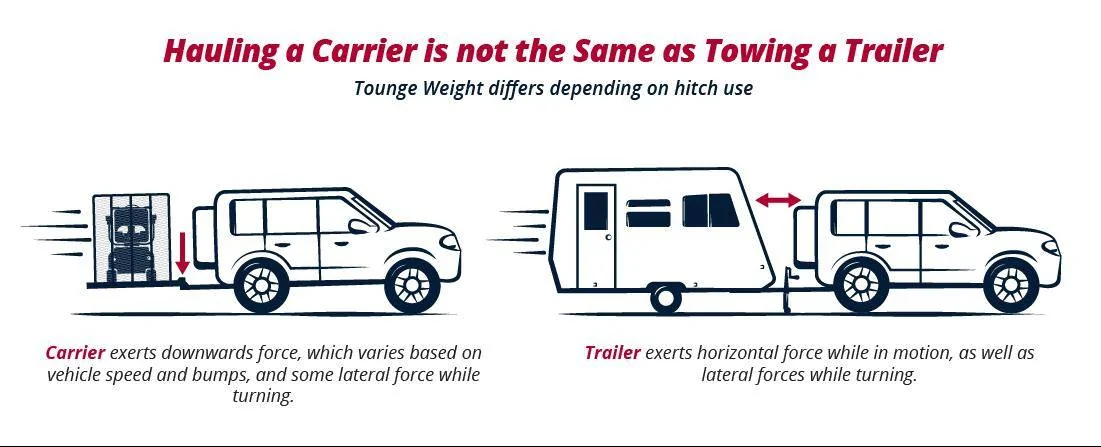

Towing weight applies the force differently than say a bike carrier, or a hitch step that sticks out. So two different limits, one (1,100 lbs) for towing and the lower one (160 lbs) for other scenarios.
This is not unique to the CT, there are other vehicles that are fairly similar in that regard.

Try to loosen a bolt with just your fingers, you’ll have no luck. Use a 12” wrench, and your fingers suffice because of leverage.
A trailer is pushing straight down on the hitch, but something like a bike carrier with a vertical load has the weight out at the end of a lever, just like the wrench and the bolt.

Your observation is only true at rest on a flat surface. Drive, turn, up hill, downhill…little more complicated vector of forces. Tongue weight is tongue weight. Article is garbage. Manual is a copy and paste error.

This is a big nothing burger. There is a massive difference between towing and the leverage generated by vertical loads with dynamic forces. There is no issue here.
