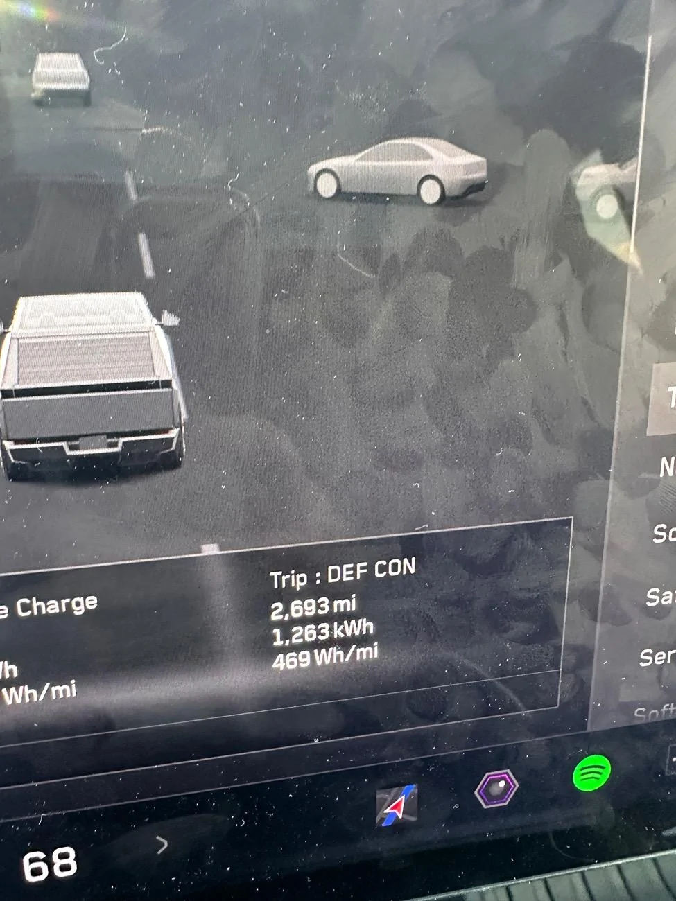

Tesla Cybertruck Cyberbeast: Austin to Las Vegas (Round Trip) - 2,700 miles @ 469 Wh/mi IMG_3752
I had a BougeRV mini-fridge plugged in. I didn't do too much extra-ciricular activities, so this is fairly accurate for what I had going on. Only change I would have made to improve efficiency over such a long highway distance is to increase tire inflation from 50 to 65 PSI. I ran 50 PSI most of the way, and then 60 for the final 25% of the trip.
I kept speed to +/- 3 MPH. High speeds (70+) definitely take their toll. The trip had plenty of 75+ MPH portions.
AC was blaring. This is August in the Texas through the arid flats of Vegas. Flagstaff was a nice reprieve.

I just did a 4k roundtrip to LV from FL in the Model X (no way I'm manually driving the cybertruck that far!)
I did 7-10mph over speed limit (75-85 MPH) and used about 325 Wh/mi.

Sounds about right….colorado is all 75mph in my area and my lifetime is mid 400’s.

I do 70mi highway trips daily and I always get about 420 wh/mi in my cyberbeast in Florida 100 degree heat with the AC at 67 going 75-80mph. It ends up at like 380 if there's traffic.
