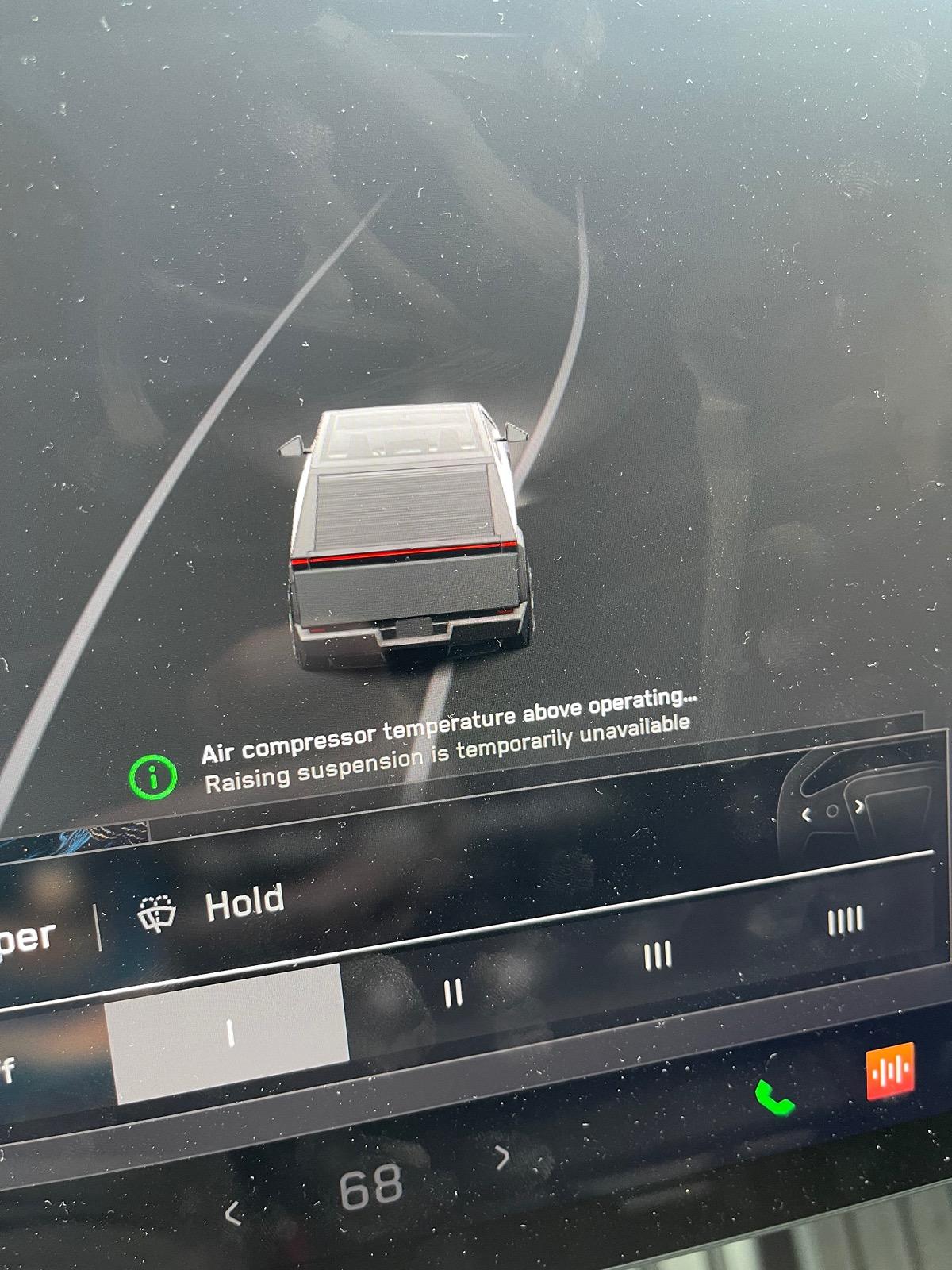

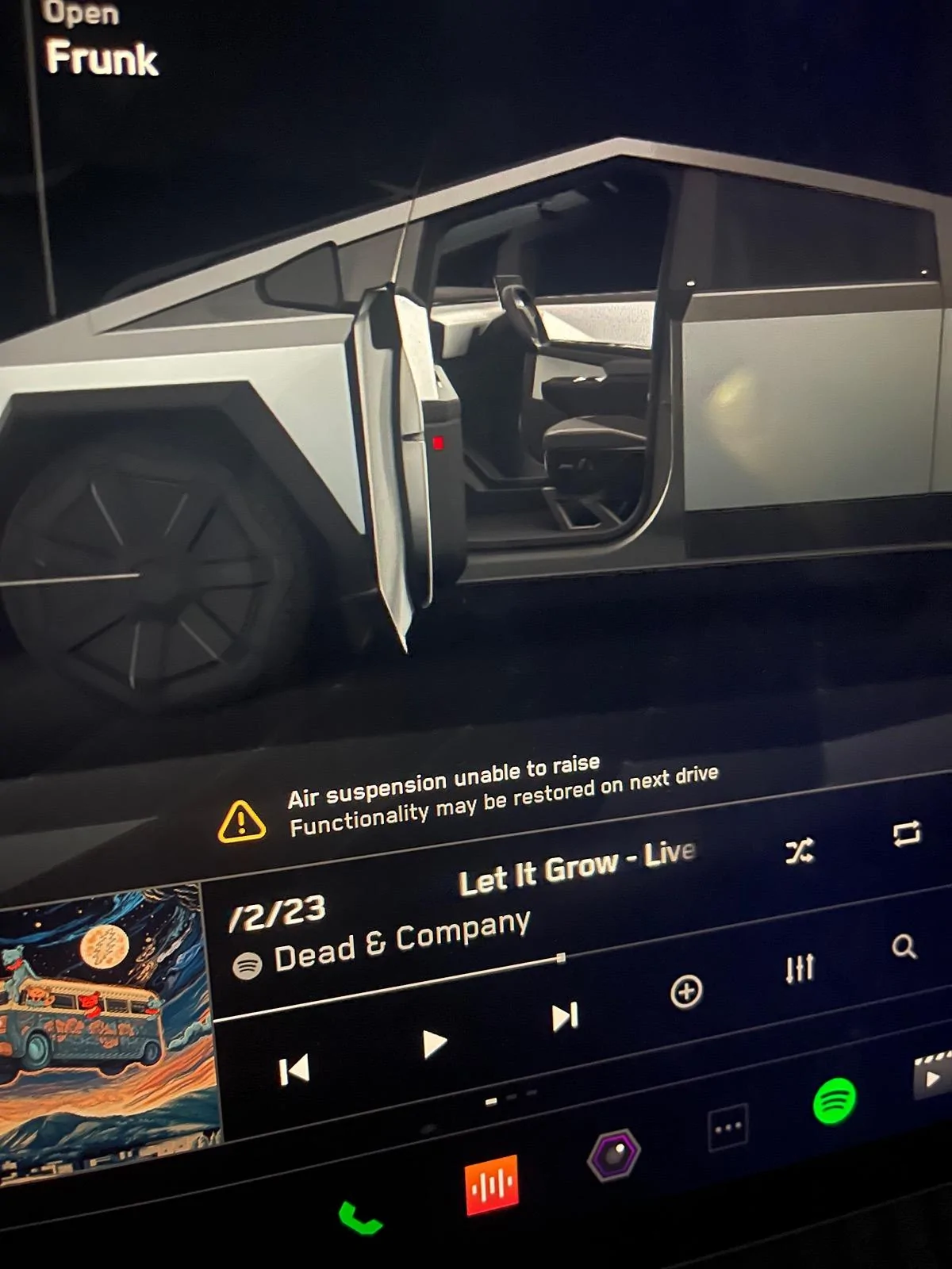

Took a roadtrip from SF to SD yesterday and got two warning messages on my screen.
“Air suspension unable to raise” and “Air compressor temperature above operating…”
Service appointment is Thursday; just curious if anyone else has experienced this.
It looks like the rear suspension might be blown as the wheels are closer to the fenders on the rear than the front.

Tesla Cybertruck Cyberbeast issue message: “Air suspension unable to raise” and “Air compressor temperature above operating..." IMG_4363
Tesla Cybertruck Cyberbeast issue message: “Air suspension unable to raise” and “Air compressor temperature above operating..." IMG_4366

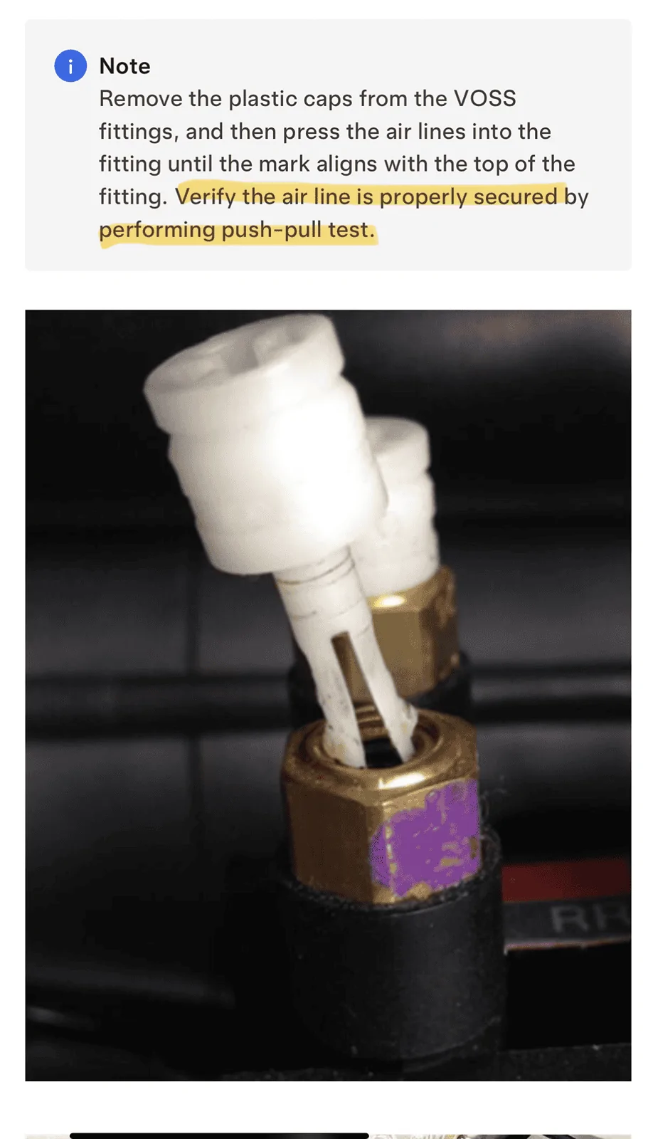

I think one of the hoses on mine popped off. Load hiss. Stick at 7.5" height.
Service manual says to do push and pull test on Voss fittings. I think they missed one in Austin.
Tesla Cybertruck Cyberbeast issue message: “Air suspension unable to raise” and “Air compressor temperature above operating..." IMG_0455.PNG

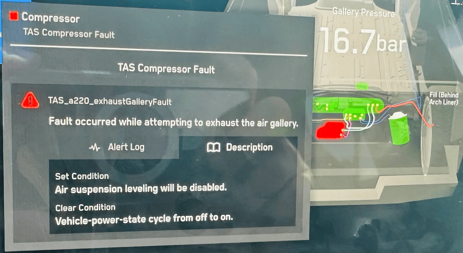

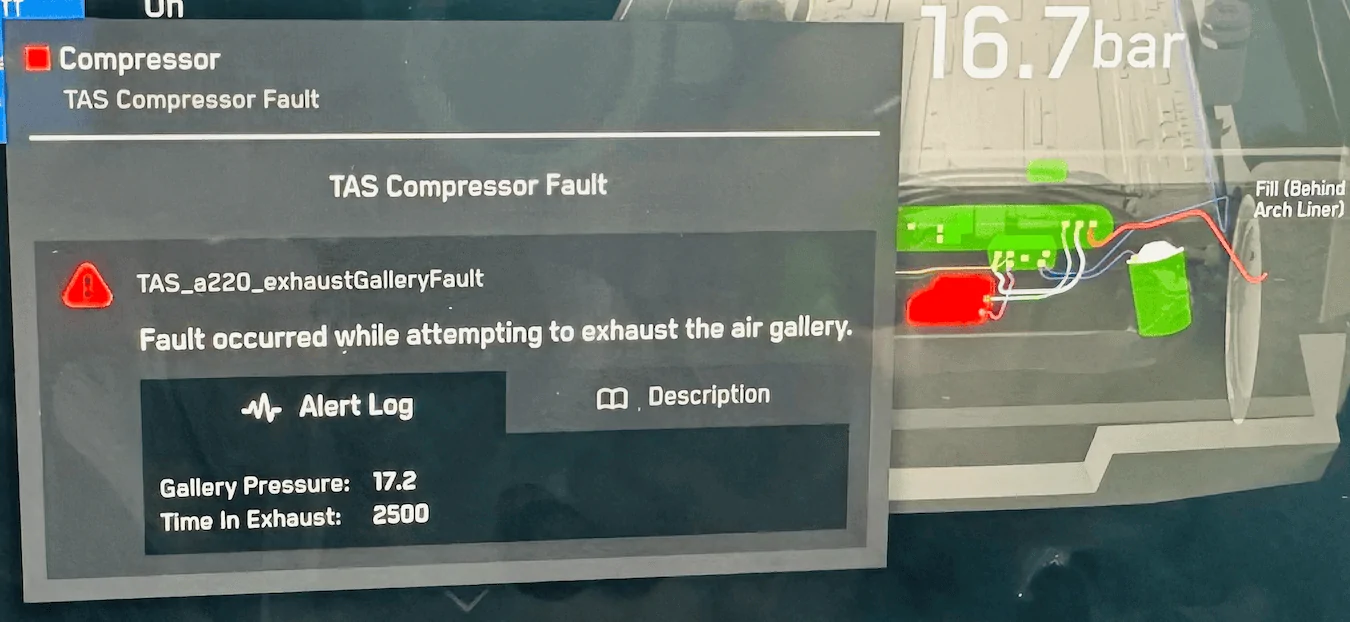

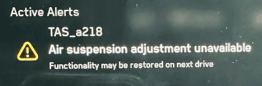

My issue is similar and indicating that it may go away on the next drive, but after 5 tries and multiple soft resets, the problem persists.
From the Service menu the fault is more clear. See images.
Tesla Cybertruck Cyberbeast issue message: “Air suspension unable to raise” and “Air compressor temperature above operating..." Main Screen Fault
Tesla Cybertruck Cyberbeast issue message: “Air suspension unable to raise” and “Air compressor temperature above operating..." Alert Lo
Tesla Cybertruck Cyberbeast issue message: “Air suspension unable to raise” and “Air compressor temperature above operating..." Alert Descriptio
I've put in a service ticket, but the earliest they can look at it is over a month away (July 31).
I'm thinking of possibly disconnecting the power to it (or the entire MV system) as shown in the service manual, but I'll wait a bit longer to hear from Tesla Service.
