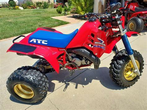

Three wheeler... req’d riders lean to outside to execute inside maneuvers.
Three wheeler riders lean opposite to a motorcycle in order to lift the inside rear wheel in a turn allowing it to spin. This was required because Honda applied the principle "The best part is no part." Three wheelers had no rear differential and no suspension other than the balloon tires. ATCs could also be turned by leaning aggressively to the inside, allowing the outside wheel to skid. It worked surprisingly well, but lacking an outboard front wheel led to an unacceptable tendency to roll over if the rider did not fully commit to either maneuver. It injured kids who were too light or too timid to throw their weight around. Quads were supposed to mitigate this risk, but their effectiveness at preventing youth injury is debatable. Their popularity is not.
Dual electric rear motors function as an effective differential, eliminating the need for these aggressive maneuvers. A long trail front wheel geometry can reduce the risk of rollover. Cyberquad would be a fantastic way reintroduce the ATC to the world. There is a LOT of nostalgia surrounding the ATC. People who were kids, badly wanting one when they were banned are now adults with (kids?) means to buy one if only they were available.
But Cyberquad means 4 wheels right? ATC means All Terrain Cycle. It doesn't have to be a 3 wheeler to be an ATC. I am building a 4 motor asymmetrical ATC for my personal use. The 2 front wheels are close together with the pivot forward of the axle. Like a 2 wheel caster. The front steers by varying the 2 front wheel speeds. It can be driven remotely, without any mechanical steering shaft. Though one can be added if desired. As the front wheels steer left, by virtue of the forward pivot, the vehicle front end is pushed left, and the wheels are no longer equal about the vehicle centerline, but biased under the right of center, providing additional rollover resistance. Positive caster, and a ramplike structure in the thrust bearing tend to point the wheels straight ahead, but allow a turning angle up to 90 degrees tilting the vehicle progressively toward the inside of the turn.

ATC three-wheelers were an attractive nuisance. The quad motor twin wheel front fork ATC is giving off “hot wheel” vibes.
Not only a great summation between ATC variants but first hand knowledge how to better the design, torque vector steer and innovate through engineering-out the dangerous qualities that cause harm.
Cyberquad, Tesla could contribute more besides rakish fenders. Closer taking delivery comes - ATC gets higher on the accessory list. Torque vector steering ATC sounds safer way to ride.
