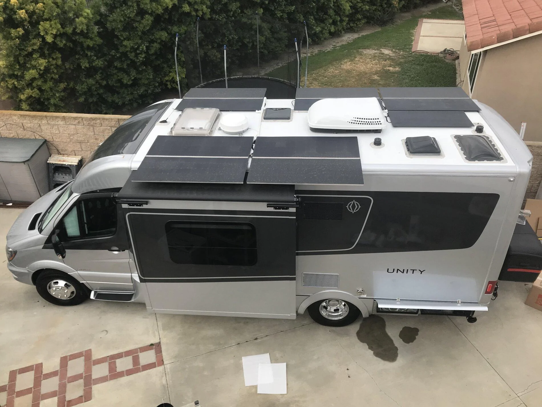

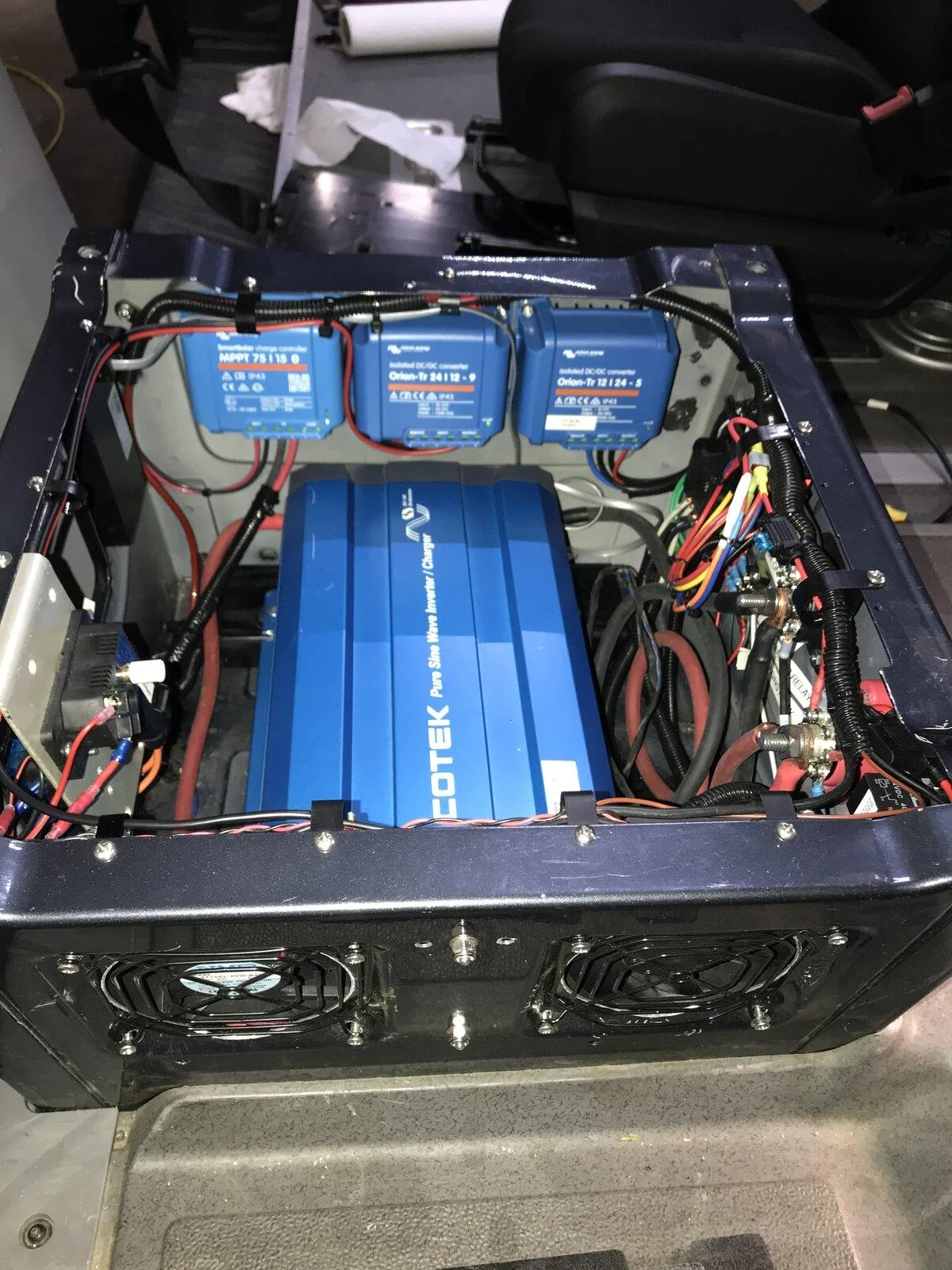

I have pulled 5th wheels for decades and this concept is both beautiful and sleek. Keep in mind the major rookie mistake for new RV owners is not taking into account what happens when both turning and transitioning on uneven terrain, this is when most RV damage occurs as people don’t account for the movement between the bed sides and the trailer sides, rear corner, etc… The truck/trailer must have room to articulate when both turning and transitioning up or down roads, driveways, etc... So turning on UNEVEN terrain is my first concern when looking at this beautiful concept you have developed.
A few items to consider before you put welder to steel:
1. A Fifth wheel hitch requires the vehicles frame to bolt and/or weld to, Cyber has no frame.
2. This might be hard for the non-fifth wheel crowd to visualize, but clearance between the truck and trailer cannot be thought of on a single plane like a simple turn on a flat parking lot. In real life use, while in a turn the trucks front wheels often encounter uneven terrain (especially when off-road) and this can result in the truck twisting and/or dipping/rising while in the turn which results in the fifth wheel trailers sides contacting the sides bed sides on the truck, not to mention the rear corners of the bed pushing up into the middle of the trailer behind the Fifth wheel mount.
3. For the trailer to be an effective range extender, the Cyber will need to accept a charge while it is motion and no current model of EV has this capability. Better reach out to Elon now!
You have a lot of work and engineering to do yet and it’s going to be a fun and interesting challenge to make this trailer viable. Just to share a little about me, I've designed and built many off-grid solar vehicles and trailers for the serious full timers and weekend warriors alike. We have pulled generator from RV's and built enough headroom into the solar/batts to allow use of the air conditioner, microwaves, and coffee makers. I've also designed and built smaller systems to run refrigeration and battery chargers like what's currently on my little white Transit Connect. I do respect your ambitious effort and look forward to updates as your project progresses.
