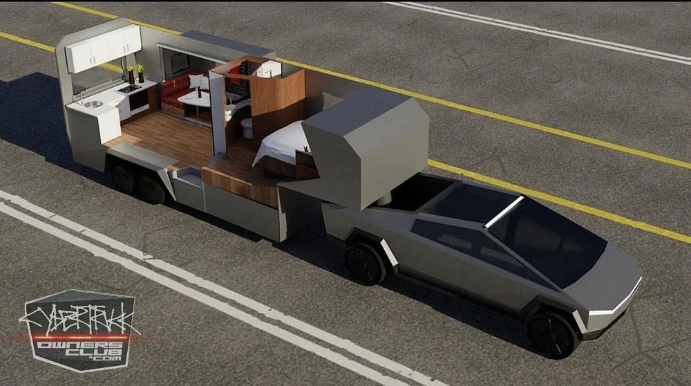

Gooseneck may need to move slightly in front of rear wheels. Horse trailers used space above gooseneck for storage. Yes bed is not practical for a "couple' "Coupling" :cool:(y)

The gooseneck concept is good. Details would be corrected. I couldn't spend the time to design all that as was done here. We hope being critical does not deter the concept dream in the making. Go for it yea ! :cool:(y)

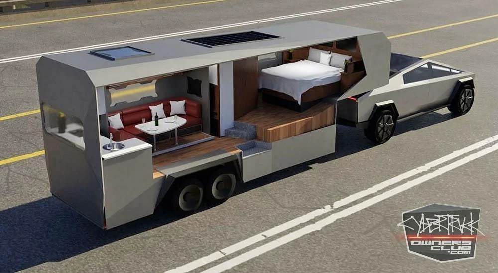

And the lav and kitchen water/waste need to be back2back to reduce cost, weight, and complexity.

The real issue with a 5th-wheel or gooseneck is the high walls on the bed of the CyberTruck. The hitch in either case needs to be over the real wheels which brings the height of the bed walls into issue. For example, I own a 5th-wheel camper and there is no way it would work on the CyberTruck as it would rub when making turns and probably wouldn’t even hitch at all due to the bed side height. It’s only a foot it so higher than the bed side on my F250. It may be possible for existing 5th-wheel trailers to have a custom neck installed on them to work with CyberTruck: one that pushes the trailer further back in order to account for the bed side height.
DES
David
Apr 9, 2020
Winter Garden, FL
Tesla Model S P85D
Software Developer & Farmer
I think gooseneck hitches that use a high C-Arch style connector could potentially work if they are high enough to clear the bed side walls, but not a normal existing 5th-wheel.
