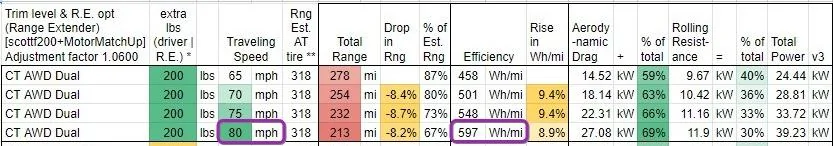

Maybe add to your post the test conditions:
- outside temp
- tire pressure
- inside temp setting
- mode setting (my not be applicable on a steady speed)
You did good relatively speaking. I'm still surprised by how much energy it takes to move the CT vs my TMX.
